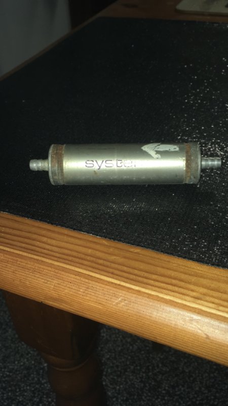

I put an inline lead thing on the Charger years ago, never had a problem, but then again I don't know if I would have had a problem without it, inside the casing there is lead which the petrol passes over, I took it off recently to blow it out, I put it back on after the fuel filter this time where as before it was before the fuel filter.
