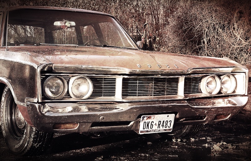

Hi there
Have you had any ideas about an electrical headache I’m having with my ‘67 Dodge Monaco Wagon?
Flickery/non op headlights particularly when switching to high beam, I changed the old foot switch on the floor, but it still does it.
Low beam works a bit better, but still fails.
Found one of the earth(s) to the body, cleaned it but made no difference...
Tearing my hair out!
Many thanks
