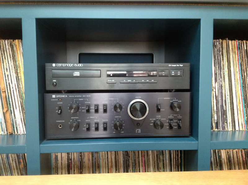

Just got a new Amp, well new to me, it's been rattling around somewhere since 1978. Lovely old thing :D

Dom66 wrote: Thu Jan 17, 19 7:54 am Just got a new Amp, well new to me, it's been rattling around somewhere since 1978. Lovely old thing :D
proper good chunk of quality
decent modern BIG speakers and it will sing
dave
Posts: 3596
Re: Vintage Hi-Fi
Dave999 wrote: Fri Jan 25, 19 10:01 am
dave
Modernish, KEF Iq9's in the lounge and a matching pair of Iq5's in the dining room. It does sound sweet.
I just need to make up the turntable now and give that vynil a good playing. :rr:
