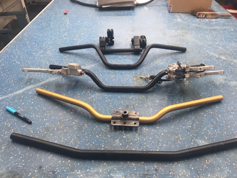

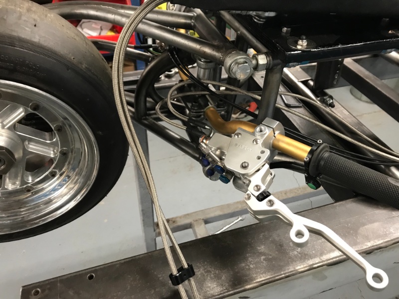

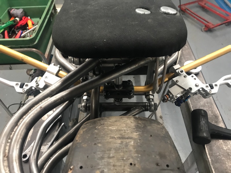

Handel bars have been a pain in the arse as very little space and alot going on.
After lots of attempts it's had to be the gold one that fits
:lol:

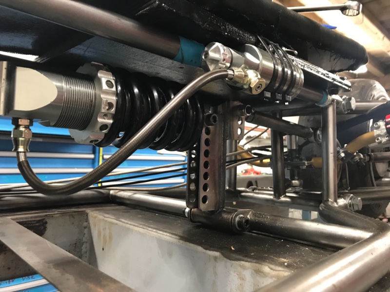

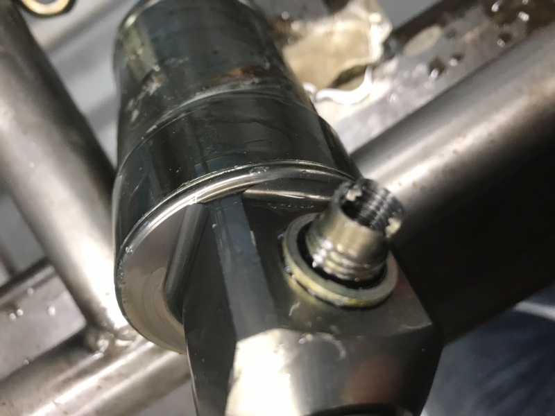

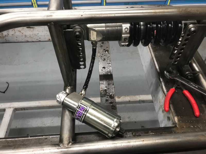

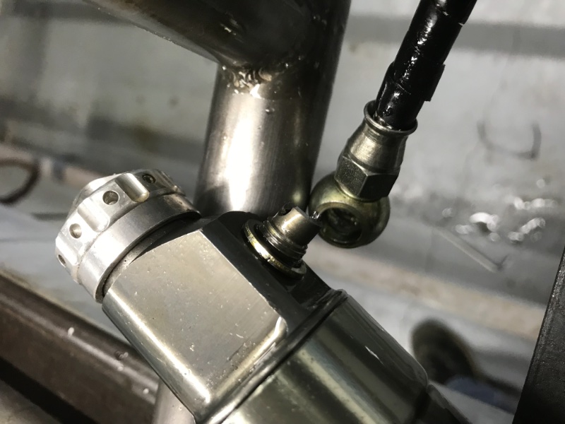

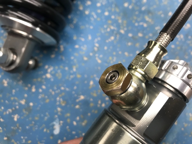

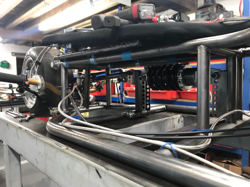

Plonker here slipped and managed to take the head of the banjo bolt that connects the shock to the remote pressure reservoir.
Now I have no idea what pressure these run at but it shot 8 meters across the workshop. (dangerous be warned)
A costly mistake that required a full rebuild at the manufacturer. Note the fancy new banjo bolt :read2:
Mounted back on the bike ready to go :thumbright:

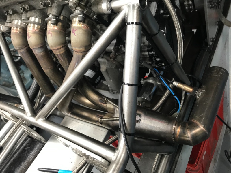

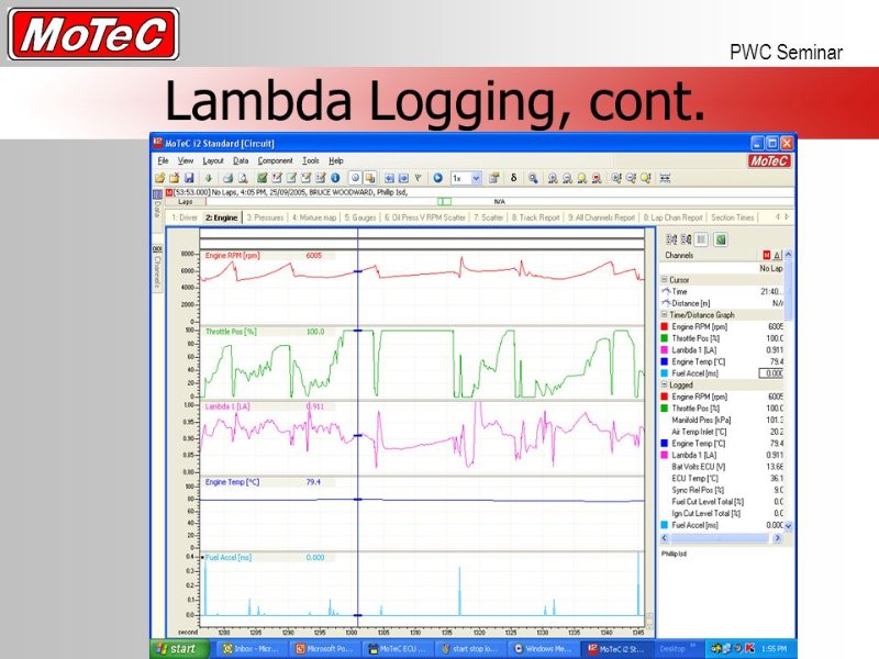

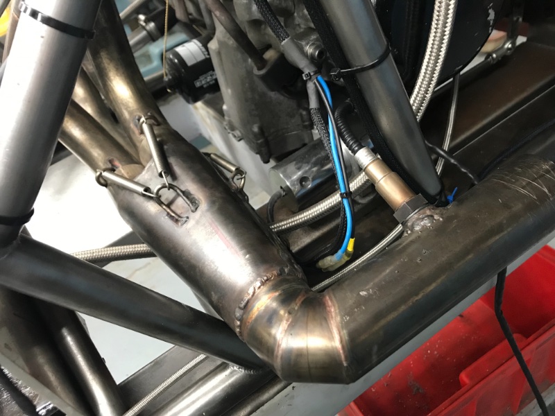

lambda Sensor
The Motec ECU (Electronic Control Unit) is pretty clever as can take a lambda Sensor input to Ethier adaptatively learn what is the correct fuel mixture (self learn) / Log the fuel mixture working within a range of your fuel map or even give a warning lights or shut down the bike down.
lambda fitted and working :salute:
