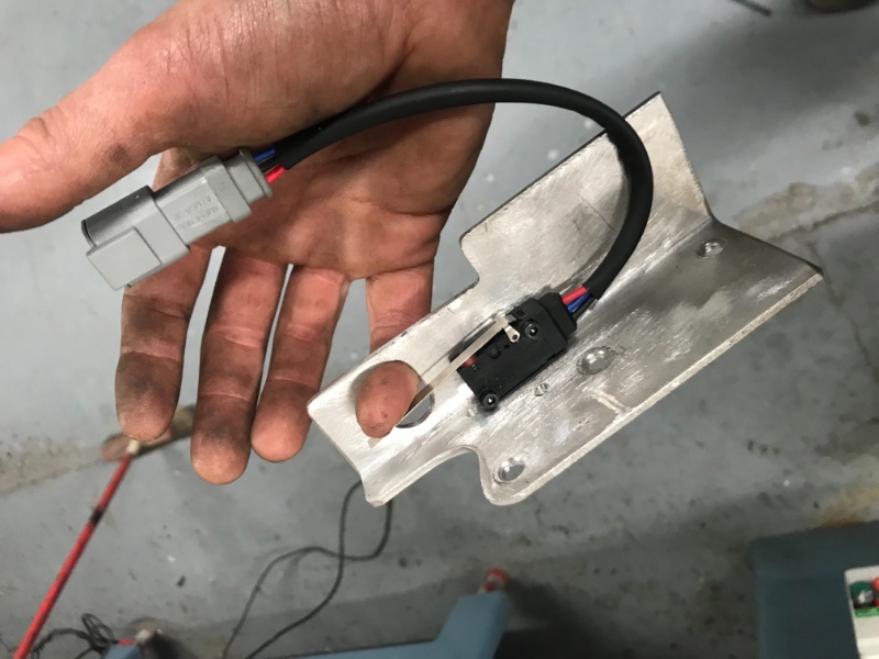

Clutch Switch

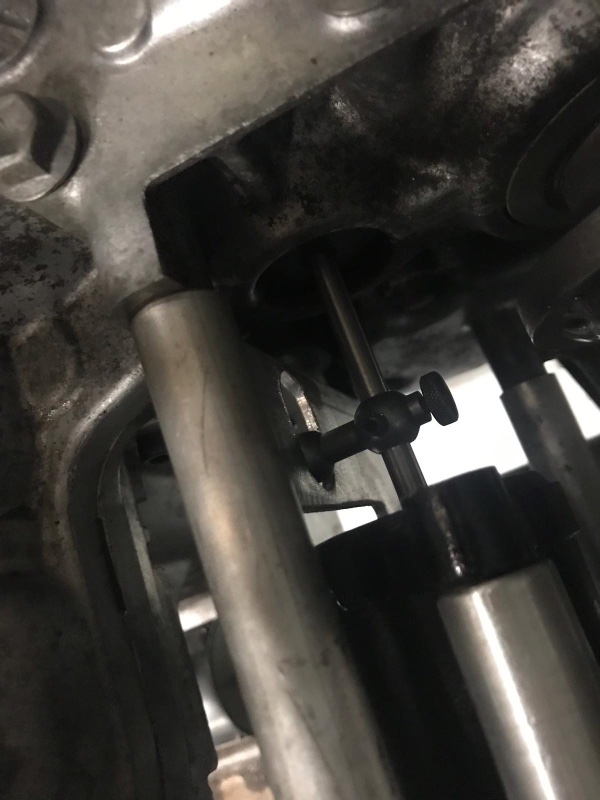

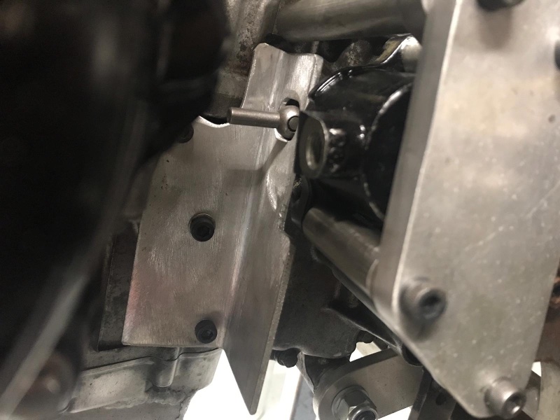

Now, this has been something that has been so surprising for me and is turning out to be one of the most important parts of the bike.
The clutch switch is a very simple on/off micro switch which is triggered when you let off the clutch. In fact with the bike up on axle stands it is set up to trigger just as the rear wheel starts to lock to the gearbox.
This Switch triggers a few very clever things to help you get down the track!
2 Step
A lower lanch rev limiter (2 Step). While the clutch is pressed a preset lower rev limit is engaged allowing the driver to hold the throttle fully open at the start line. This will allow you to launch constantly off the line and then the bike will return to its run limits for the upshifts.
Lanch ns 1st - 5000rpm (Clutch pressed)
1st -2nd - 11000rpm (Cluch Not pressed)
Lanch is 2nd- 3rd - 12000rpm (Cluch Not pressed)
etc etc
Timmer
The releasing of the switch starts a timmer this can action many things and I'm still trying to get to grips with it all.
Logging, for example, is started and recorded onto a hard drive to allow for analysis later.
Cameras can be actioned to start recording and the list goes on and on. AKA in 10 Sec time after run let the water pump run for 3min to cool bike till 62c blah blah blah
Anti-lag
Anti-lag is focused on dumping fuel into the exhaust system, so it can ignite further downstream from the combustion chamber and help the turbo or turbos spool up to build boost.

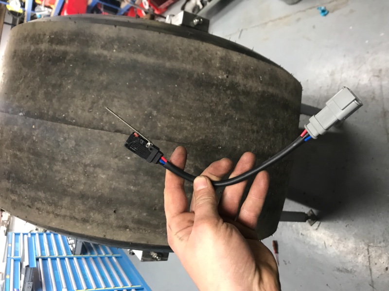

As I have very limited space up front on the clutch control level I decided to make up a bracket and mount the switch directly on the gearbox slave cylinder output shaft.

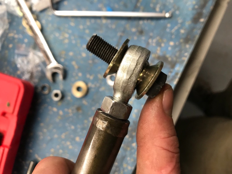

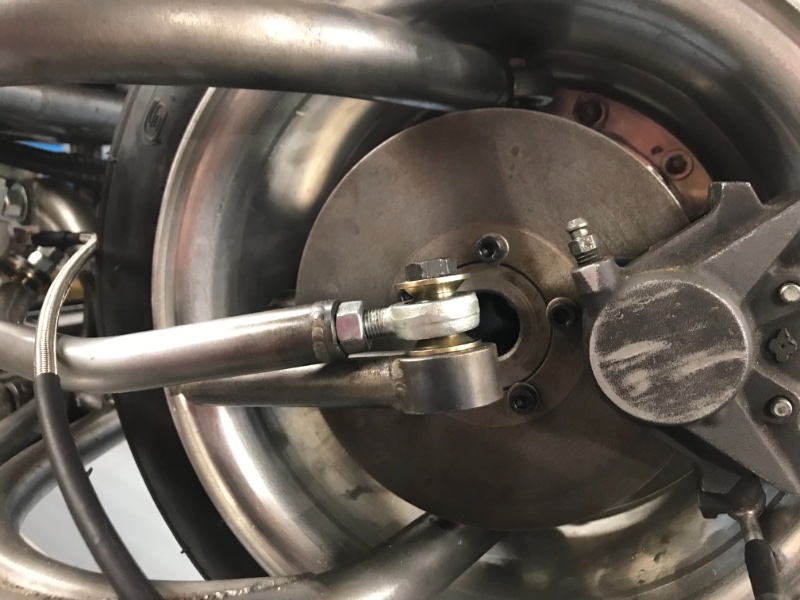

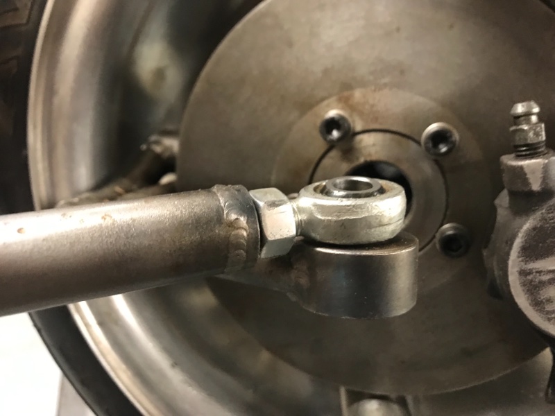

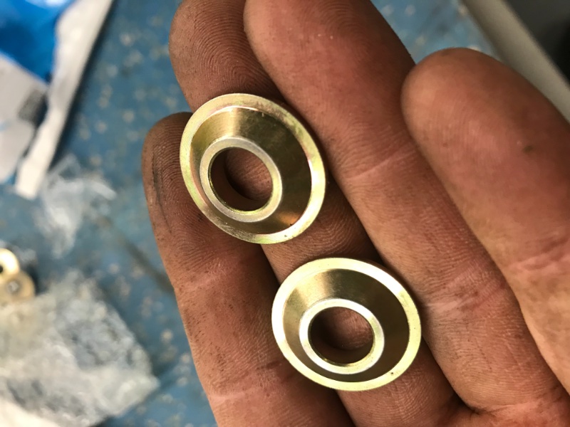

Due to steering geometry and steering rake.i have been struggling with rose joints binding / bottoming out. Found this very cool misalignment washers that allow for more travel. I’m also told you can buy specialist rose joints with this in the design. Steering all set up and ready

I'm sure those shock are about 1500psi, I was warned not to strip one myself!
I've had similar problems with rose joints, a cheap simple solution is to fit a split spring type washer either side.

McGill Motorsports sell the Hiem spacers - very good service too!

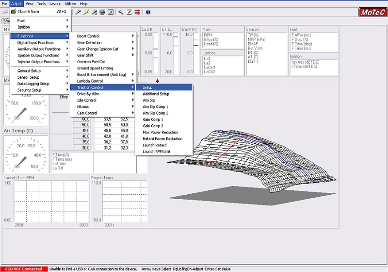

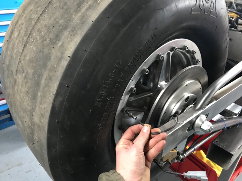

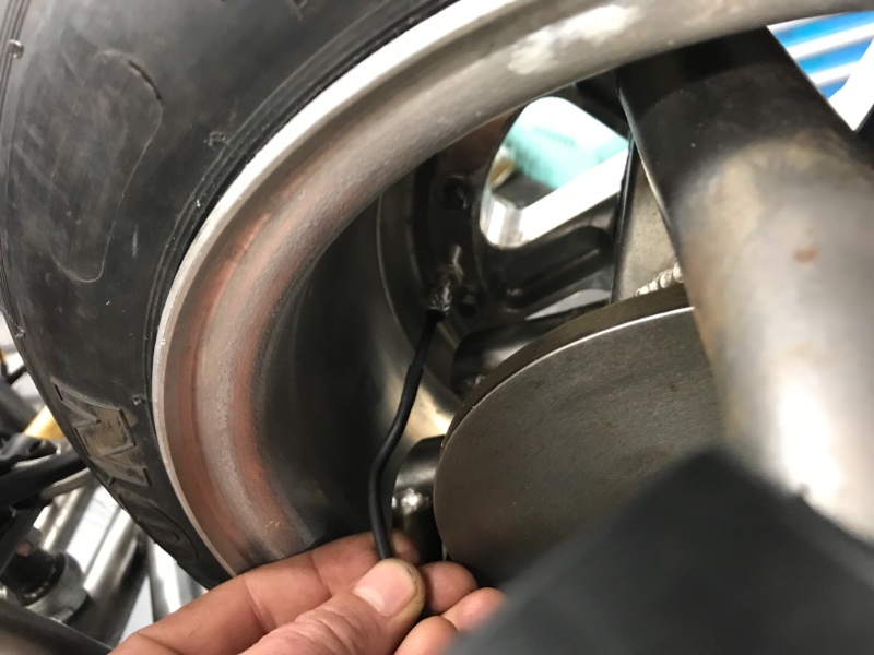

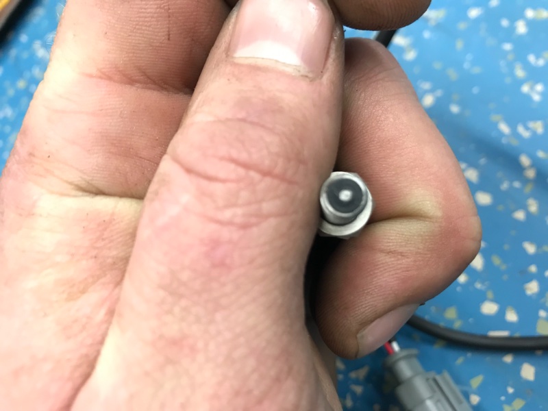

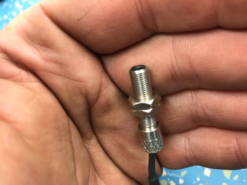

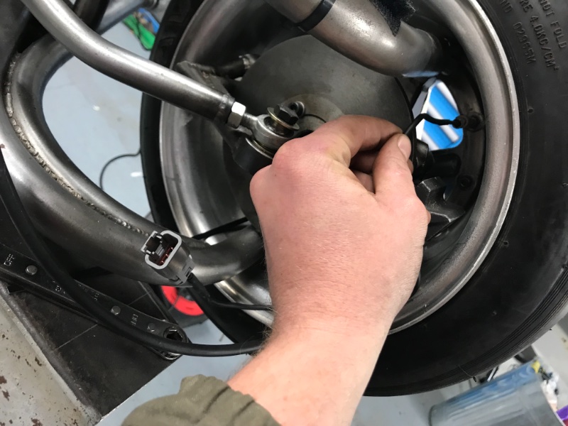

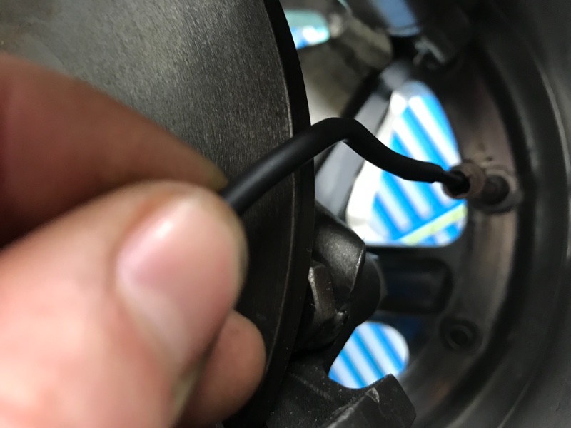

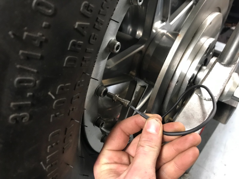

Wheel speed sensors
These are the latest and greatest wheel speed sensors for there size. They will be mounted inside the front wheel and off the rear swing arm for the rear wheel and magnetically pick up of the bolt heads. You tell the computer that 32 bolt heads are one revolution and the diameter and we have ground speed. While ground speed can be interesting it is the compassion between what the front and rear wheel that is really what we are looking at.
The system has the ability to create a traction map and allow for an amount of slip at a given RMP or speed or time. Once the computer sees an amount of Slip outside its pre-programmed table it will retard ignition or change fuel supply to produce less power.
This is a full closed-loop system (A closed loop control system is a set of mechanical or electronic devices that automatically regulates a process variable to a desired state or set point without human interaction)

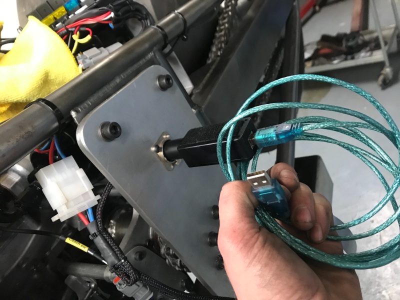

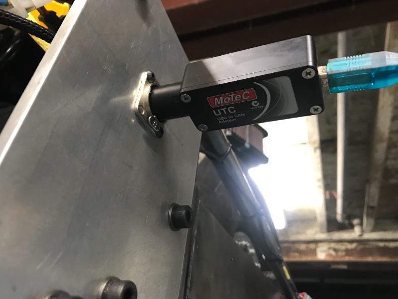

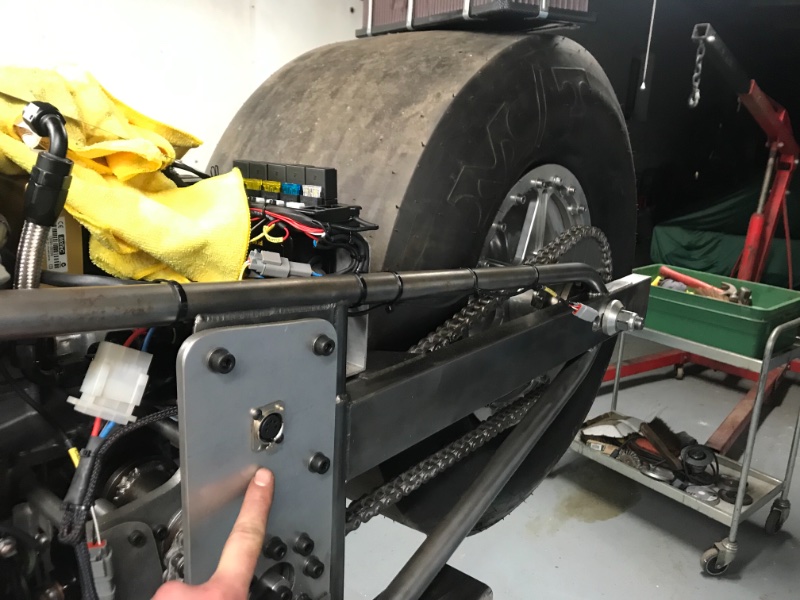

Communication to the onboard computer is done via Can with a USB convertor. Fitted a nice socket for data logging and adjustment in the pits !

Re: Fifty shades of Jade
The detail stuff is fantastic Will.
I'd like to think i could build stuff like this, but the level you go to is way past my simple mind!!!
