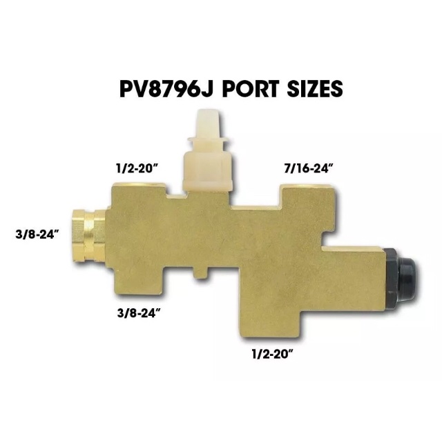

- Valves
- A83A64ED-3C77-47D6-8A1F-32D00A23BFF9.jpeg (43.73 KiB) Viewed 1843 times
- Valves
- D8505FA2-27CD-4873-B277-36629EE162FE.jpeg (43.73 KiB) Viewed 1843 times
- Valves
- 58F99A4C-9D93-4F80-8DED-F64030EF78E6.jpeg (46.82 KiB) Viewed 1843 times

i cant upload my original pics of valve on car, these are the jeep valve and the valve with extra parts on
Re: master cylinder/proportion valve
have a look at this it will probably help more than the valve
https://www.ebay.co.uk/itm/323796960480
when it comes to the jeep valve we will need to find a diagram of how it was fitted to the jeep
then identify which pipes go where on yours
There will be holes in it for warning light switch and potentially a port for an anti lock brake module i would think. i.e there will be some holes that you can plug as they are not relevant to the basic set up you need.
however unless the springs in your old valve have corroded away it will probably still work.
