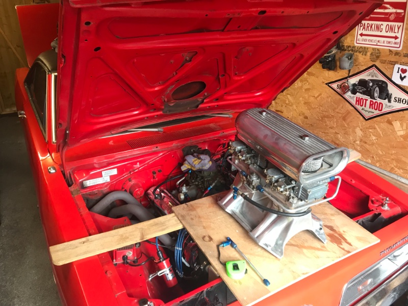

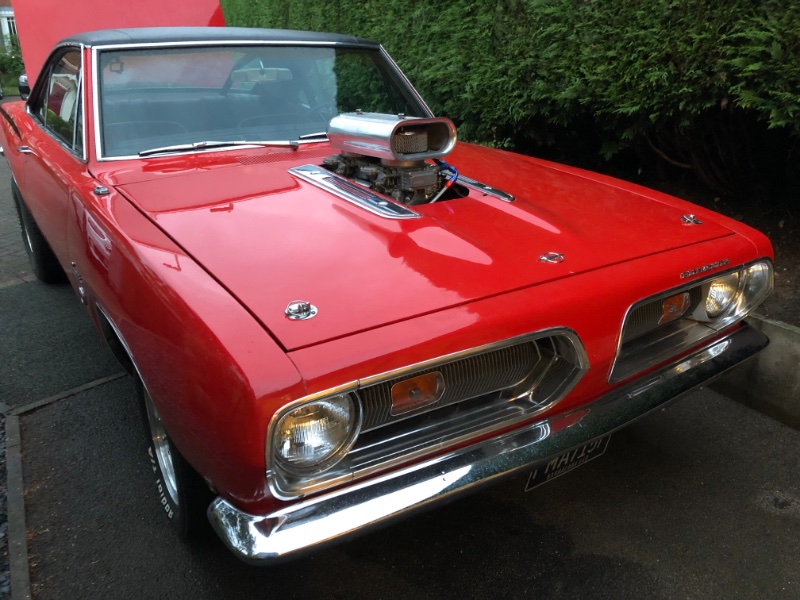

2018 was a challenging year trying to get the car to this point with frustration and joy in equal measure. First MOT last year picked up a few issues and although not needed, I’m glad it was done so it forced me to get things sorted. So, once the essentials were done and after months of pondering I decided to press on with the tunnel ram install. Wow what a difference it’s made :shock: I figured that as the car is already far from original and it already had a gaping hole in the bonnet I might as well tidy it up. I’ve also been busy with:

As a long term tunnel ram fan and user I agree, it makes a big differance. Personally I prefer to use double pumpers for maximum tunability, though I currently have vac secs on the Valiant as a temporary solution.

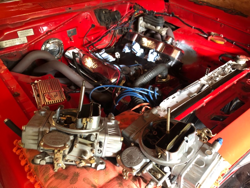

Hi Blue, it has vac secondaries and found both tricky to set up. Still a bit of adjusting to do as I have a small flat spot when I stand on it. Needs proper tuning with this and the new dizzy fitted. Had to fabricate a throttle linkage bracket as still using the old cable which is pretty short. Also noticed an improvement in cooling which is a plus.
The manifold and carbs came from an MMA member who was reluctantly unable to fit and use it for personal reasons so glad it’s found a new home. Also, my wife was getting annoyed with it sitting on the dining room table (I thought it was rather decorative)

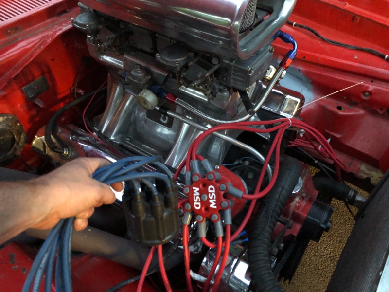

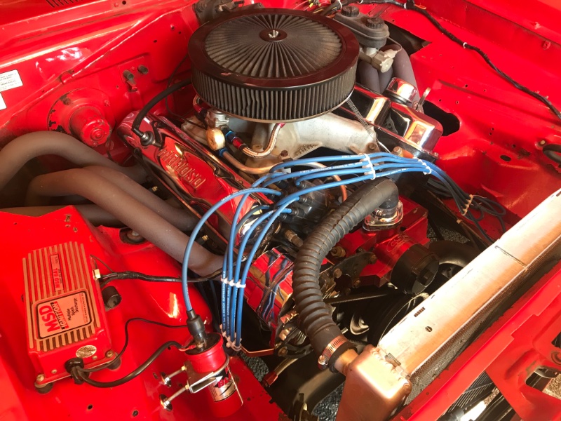

Is that the all-in-one MSD ? Makes a nice neat installation - 12v in one end, spark out the other.

morgan wrote: Wed Jun 05, 19 8:13 am Is that the all-in-one MSD ? Makes a nice neat installation - 12v in one end, spark out the other.
Looking really good. Nice work.
Thanks Morgan, yeah dead easy install after some YouTube training. Used a borescope camera to find TDC rather than turning it over. Terminating the leads was pretty easy in comparison to the fuel hoses which left me with bleeding fingertips :D
