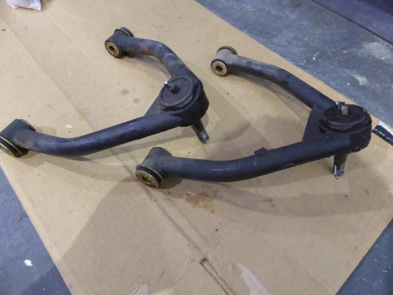

Thought I'd start an occasional thread on things I'm doing to the car. The rate I go at though - don't hold your breath between posts!
On that note should have been doing this sooner but couldn't get the library finished so the car has had to be delayed longer than planned.
Said at the end of last year that I needed to get on and sort out the steering.
Forgot to take a pic before removing them but here's what came off.
Guestimation from how they were sitting (ahead of the upper bump stops) is that the castor was all the wrong way.
Set about fitting SPC adjustables with some new shocks.
Just waiting for some new bump stops to arrive from Rockauto and once fitted can take it off for it's mot and to get the alignment more accurately set at the same time. Currently roughly neutral on the camber and as much castor as will allow.
Based on a review of the advice available here I'm looking to stay about neutral on the camber, as much castor as will come (SPC seem to reckon on being able to get up to about 3 deg.) and about 1/8 toe-in.
