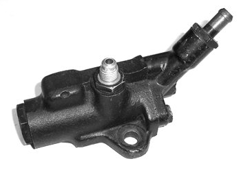

Posts: 7516
Re: Morgans 68 Charger. Engine #3...
This is the bit you need to adjust, undo the 2 nuts just a bit and either tap it up or down but only a 1/16th of an inch at a time.

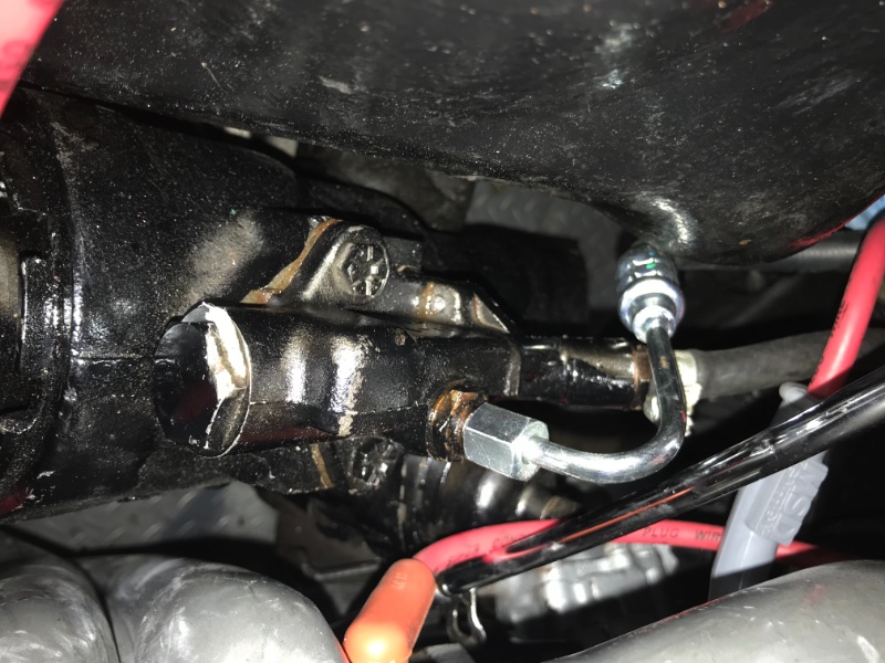

morgan
Posts: 4240
Post by morgan »
Yep - thats the one...
In fact, if you look at mine ( newly rebuilt) you can see where its moved (unpainted, needs to tap towards camera) so i think first thing is -
A) jack it up and bleed.
B) tap it back to where paint suggests and see what its doing.
With no pump the box works fine so i dont think there is anything terminal.
High hopes. Let ya know. :)
Post by kma176 »
Had same with mine after re-build !!
When I removed the valve body I discovered they had re-fitted the Pivot lever upside down - put it the right way around, slight adjustment all fine !!
morgan
Posts: 4240
Post by morgan »
Well, good news is, adjusted and steering works ! ( yay!). Too far other way now but we can play. Phew !
Will update other thread shortly.
