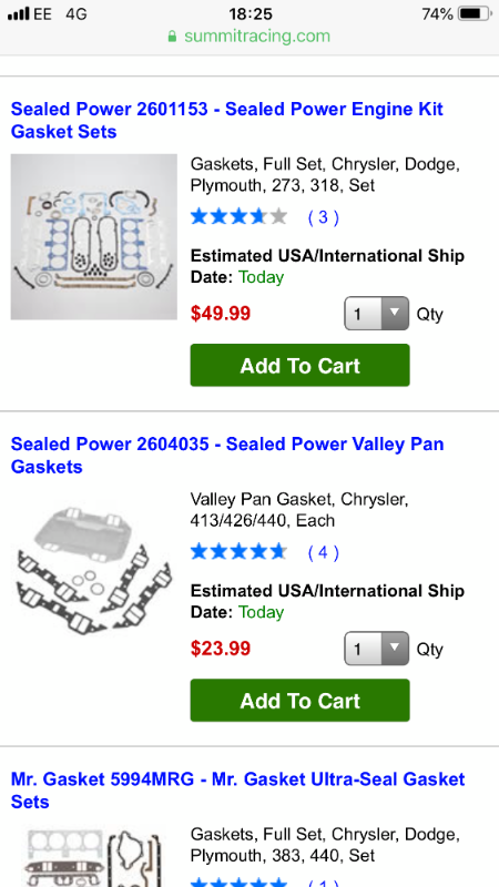

So couple of weeks ago,I noticed a big oil build up ontop of it and after further investigation,the valley pan itself had a crack in it so got a new one ordered from summit fitted it and was all fine but then last week,noticed again oil build up and again,the new pan had a new crack in it so thought it could just be faulty parts so ordered another one,fitted it and again,all good and no leaks.
Drove the car last night and thought I’d just check everything and AGAIN,oil has reappeared and another cracked pan! .... am I missing something simple or just bad luck on poor quality parts?

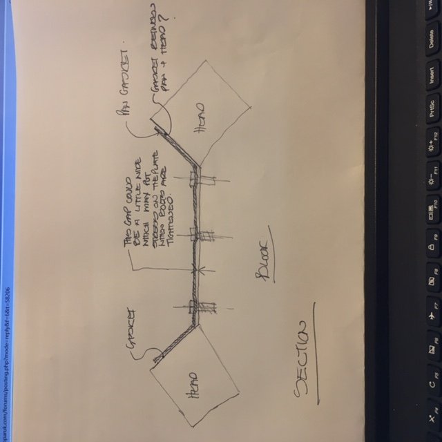

Re: Valley pan issue
Hi Anthony
My thoughts on this,(see my sketch) can you fit the gaskets between the valley pan and heads ? The reason I ask is, I couldnt fit gaskets as my block has been decked, which in my case means the bolt holes don't line up with pan if I try to fit gaskets, because effectively both heads when fitted move downwards, slightly throwing everything out, so I rely on silicone only. If you have gaskets between the pan and heads, then maybe the gap under the pan to the 3 bolt retainers is a little excessive. If you have tightened the inlet manifold first effectively locking the valley pan in place, then when tightening the 3 bolts you could be stressing the plate, then when everything heats up you have the issue. Don't forget these 3 bolts are only torqued to about 14 ftb from memory. When you do again try tightening all the manifold bolts and the 3 bolt retainers together a little at a time,rather than in isolation if that makes sense.
Good luck.
Rog
Good luck.
Rog
