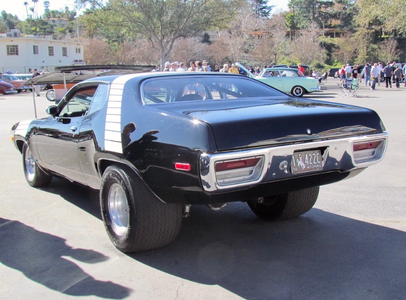

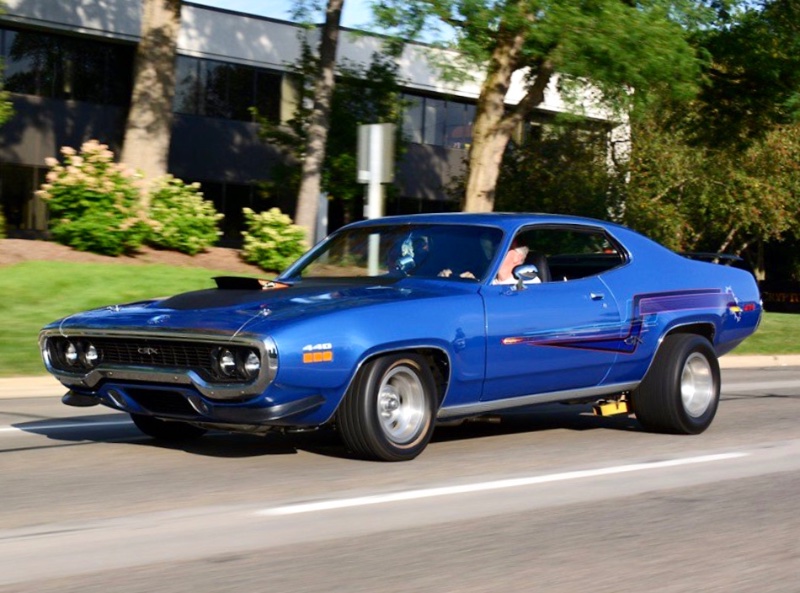

Mark B wrote: Tue Jan 14, 20 2:37 pm Just needs a bit of tweaking to make perfect.
Something like this....
Go and stand in the corner. You're a bad influence Mark.
It's perfect as it is.
Posts: 14052
Re: 72 Satellite
Stu Twin wrote: Tue Jan 14, 20 3:50 pm
Inevitable maybe, but I gotta agree, those 2 examples are just plain wrong. That second one - he may as well fit a dually axle :roll: :lol:
From the slapper bars forward tho, it's perfect, As is yours Gene :thumbright:

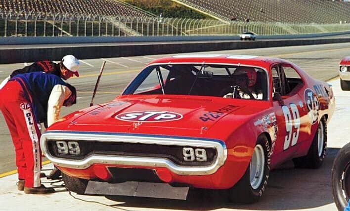

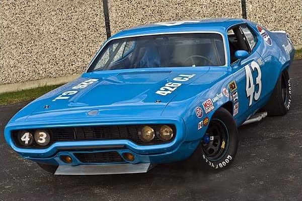

It's a lovely car, but those arches do need filling....
More like this perhaps ?

Those last two fat-boy ones look like the instgram filter has gone wrong.
Leave it as is !!!

Dom66 wrote: Wed Jan 15, 20 7:50 am It's a lovely car, but those arches do need filling....
That looks good. This one looks perfect.
That 99 race car does it for me!!

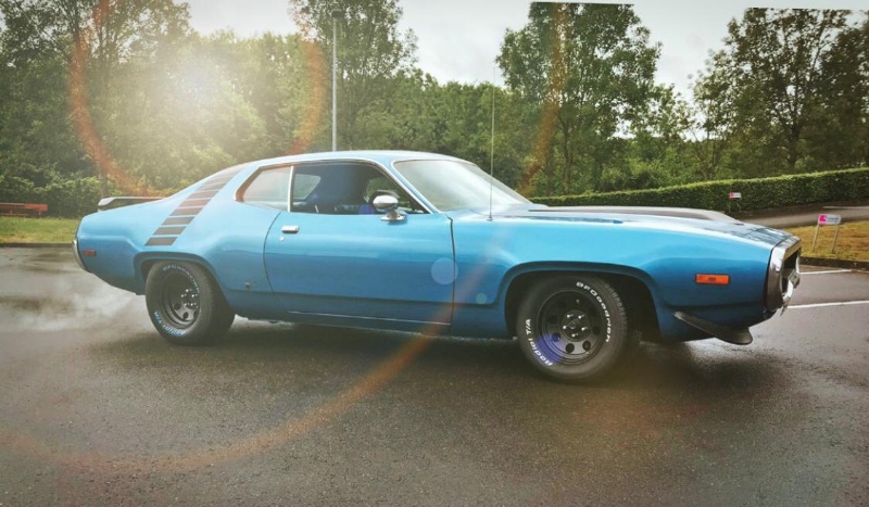

The car’s all sorted, rebuilt 727, restored tank, rebuilt carb among many other things. And new Baja alloys and BFGs.

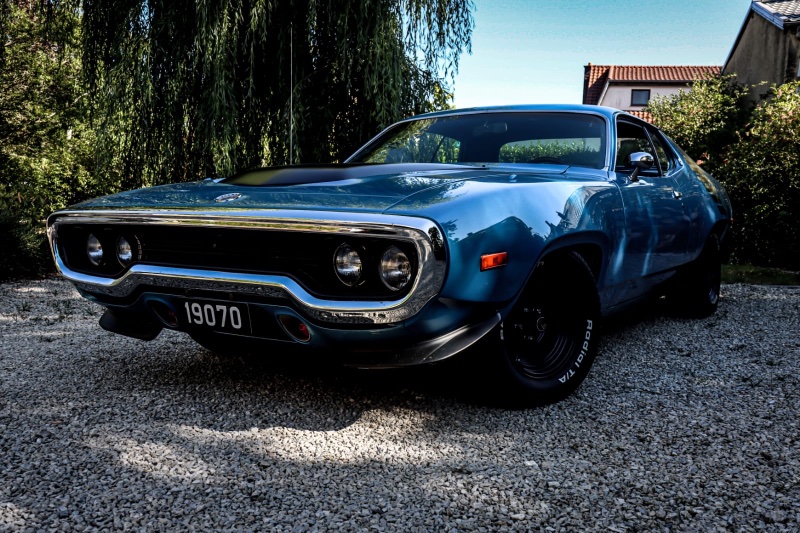

Re: 72 Satellite
Another shot.
