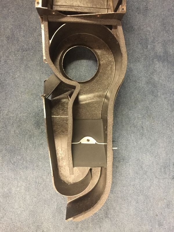

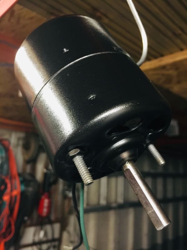

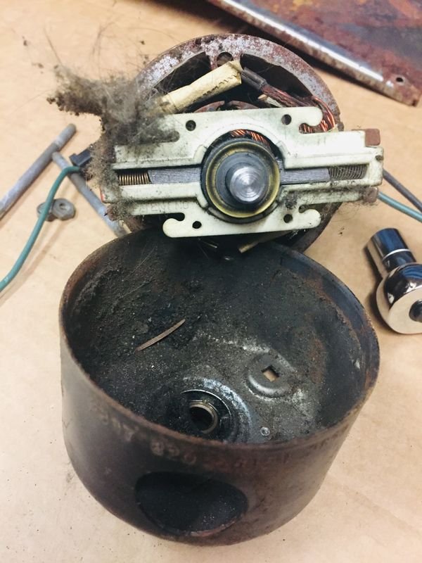

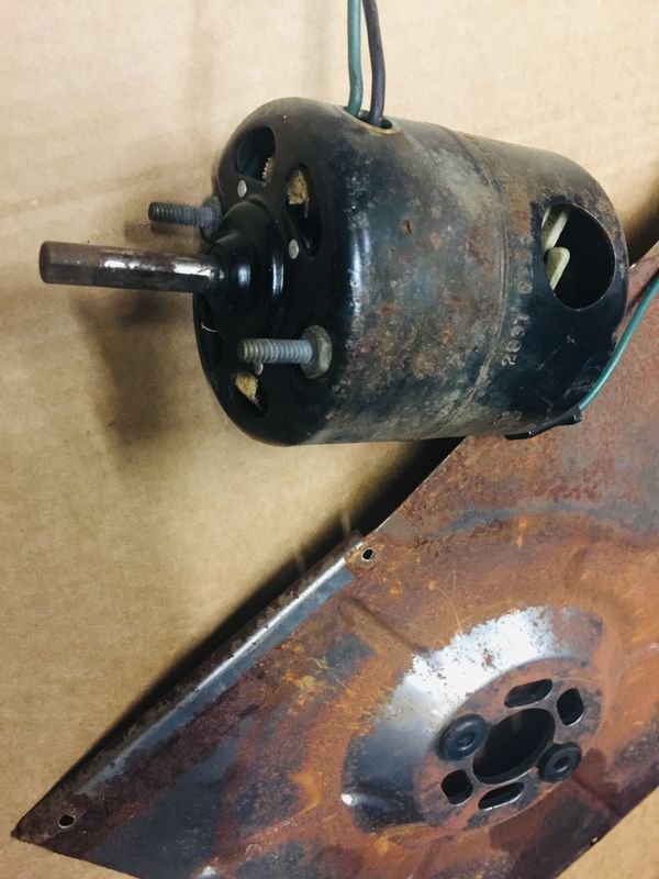

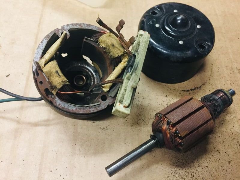

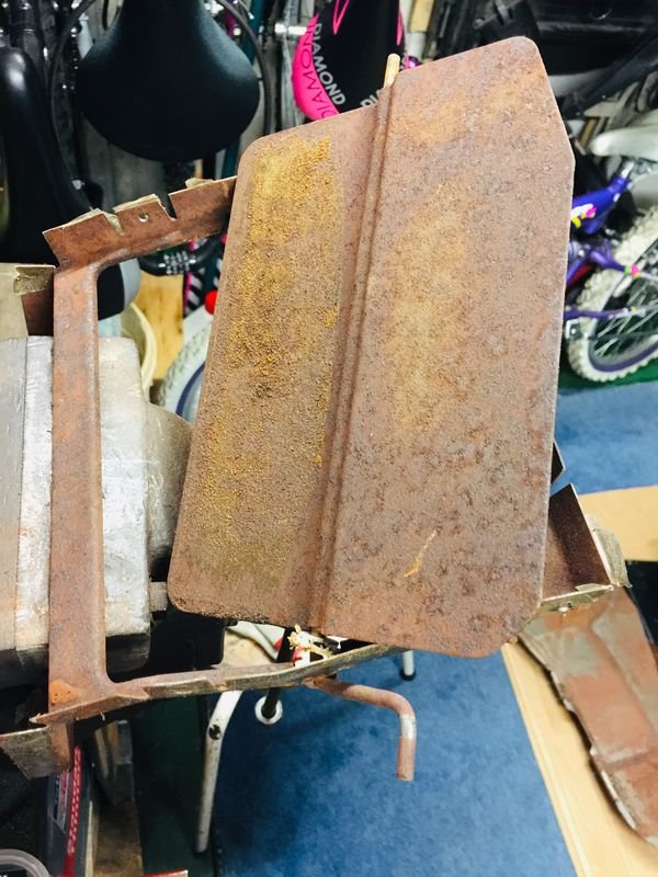

As mentioned previous the blower motor works fine
So a quick check inside, clean and a fresh coat of satin black …

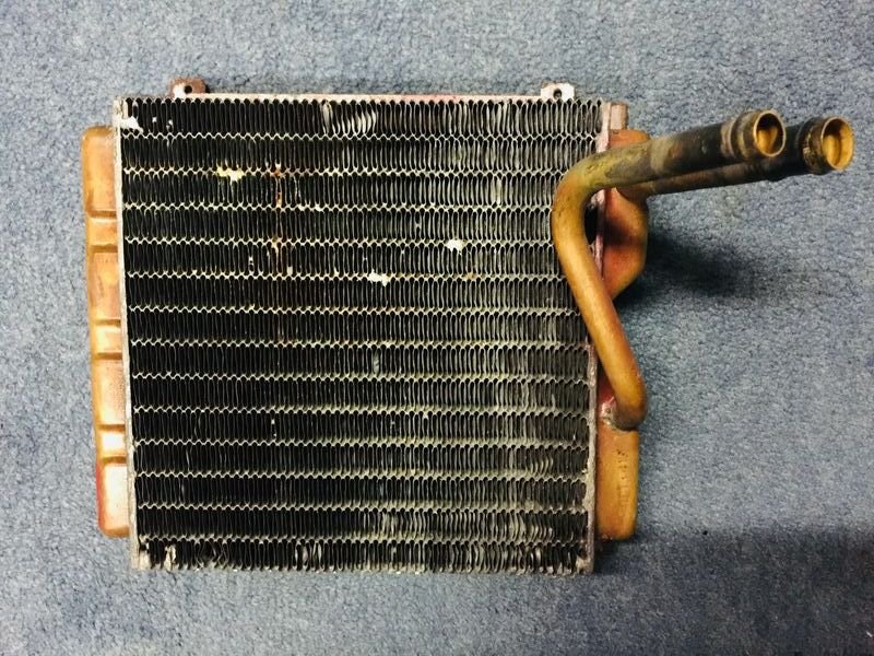

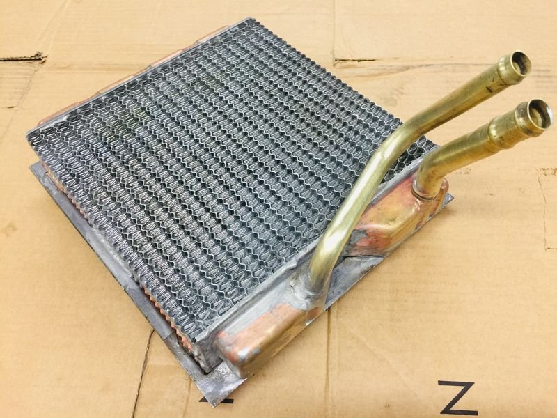

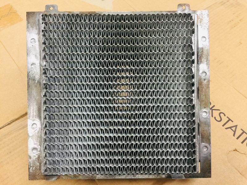

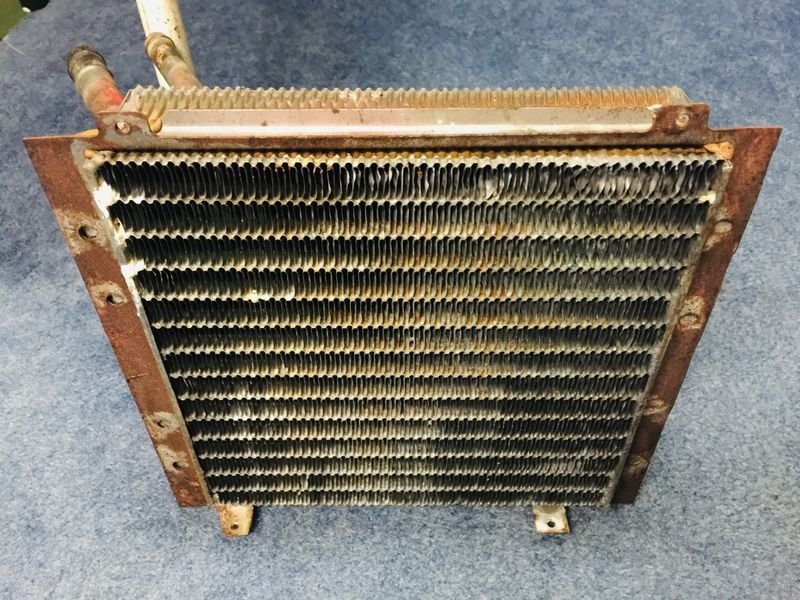

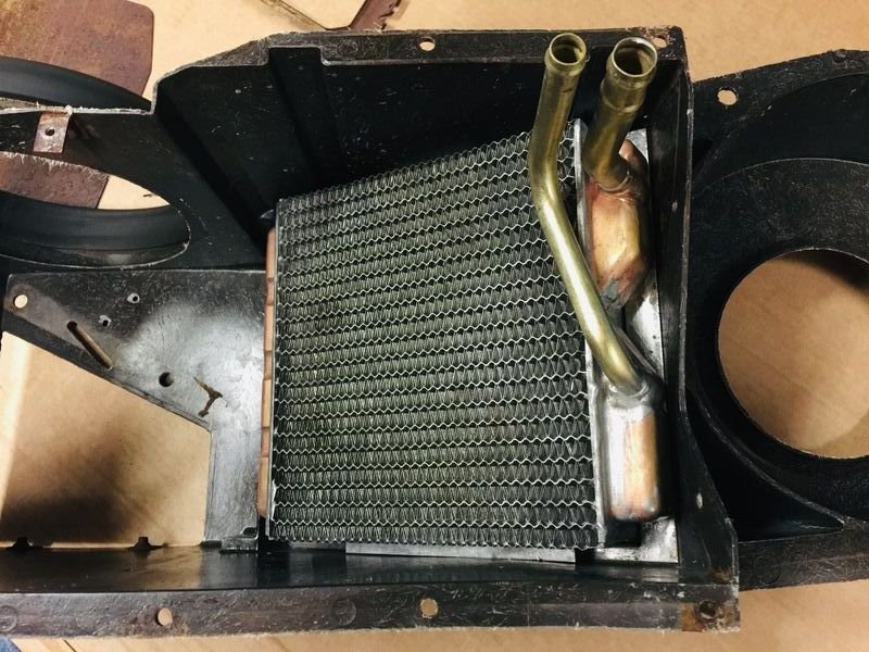

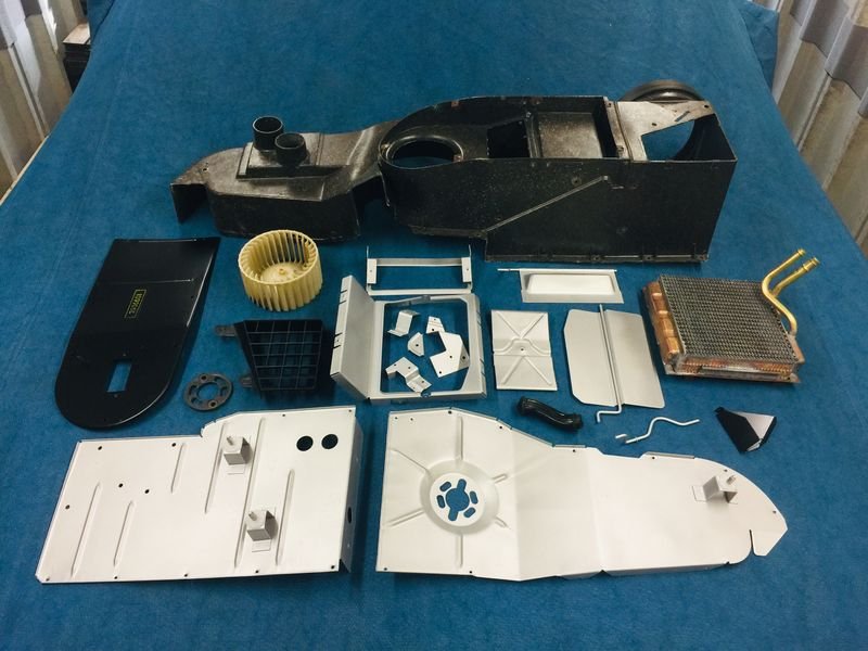

RockAuto do a Spectra ali heater core, which was much cheaper than repair, and I was tempted

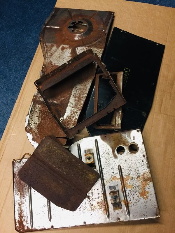

However, I decided to get the original copper and brass heater core repaired
Took it to B & J Radiators in Farnworth, near Bolton, many thanks for the recommend Ryan
He checked it over and the diagnosis was indeed it was leaking, from multiple places within the core
Only fix was a re-core
It’s a film core and to replace like for like he ordered the core in from Denmark
A couple of weeks later it was done, and he’s made a loverly job of it, far too good to be hidden away in a box for the next 50 years
tested to 30lb, should do the job, the core does seem to be a lot better quality than original, the fins aren’t as flimsy
Before and after …

As Matt mentioned …

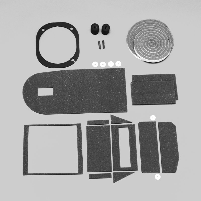

Mopar B Body 66-70 Non Ac Heater Box Rebuild Restoration Seal Gasket Kit
From Detroit Muscle Technologies
https://www.detroitmuscletechnologies.c ... asket-kit/
has arrived …
Posts: 5251
Re: Si's '70 Charger 500

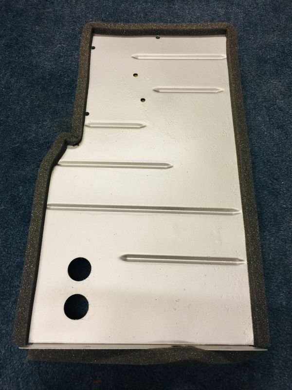

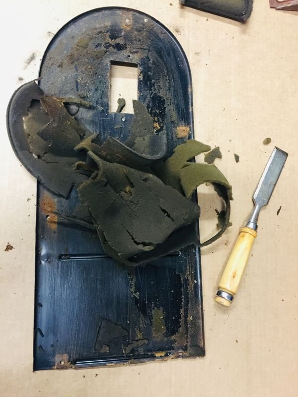

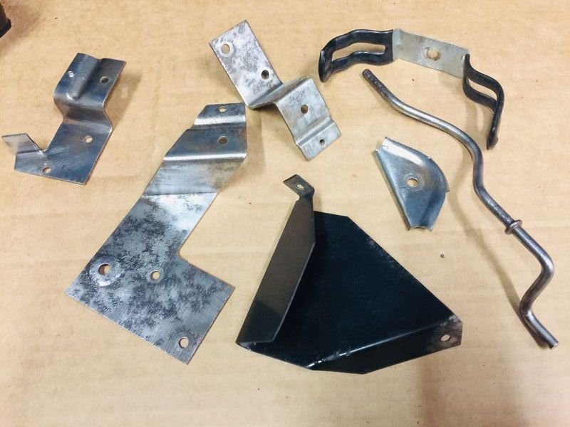

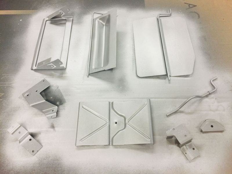

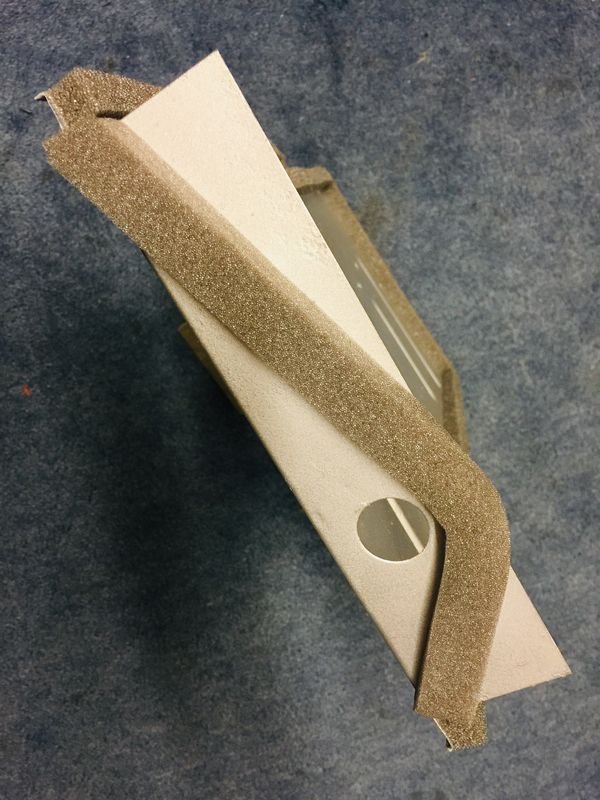

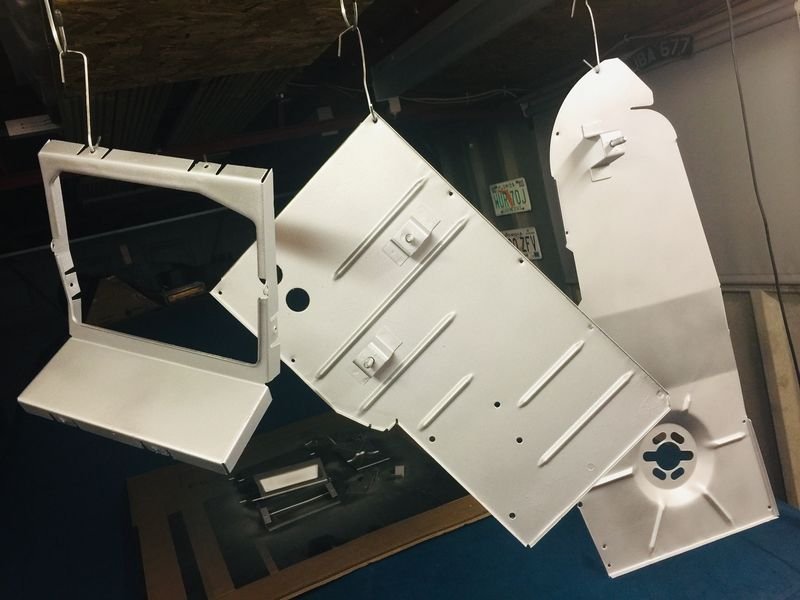

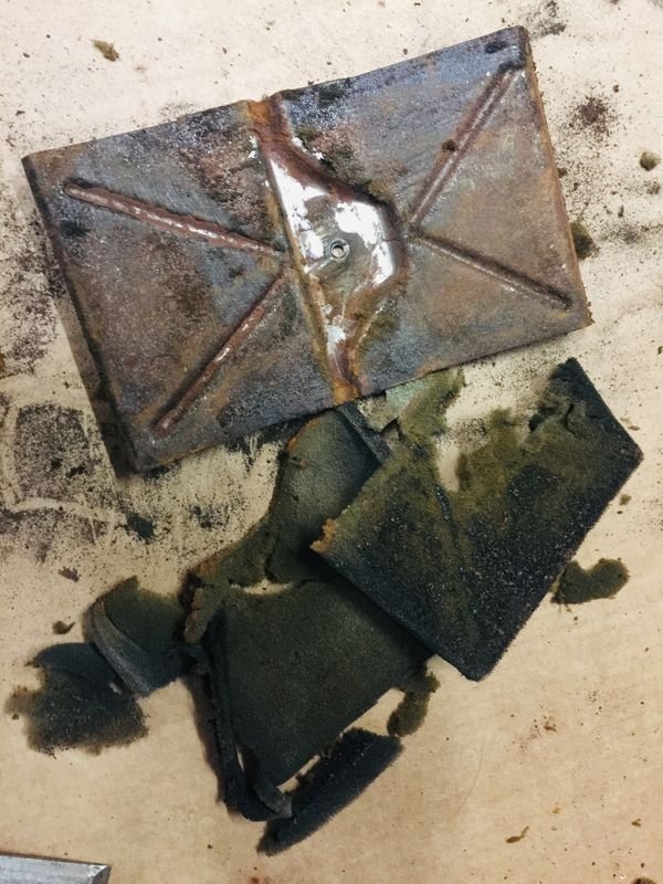

spent too long cleaning and painting all the parts that will never be seen again
but it did provide a sound surface to apply the new foams …

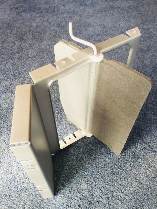

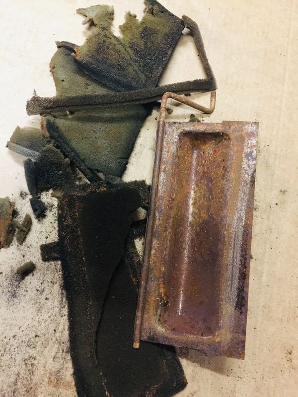

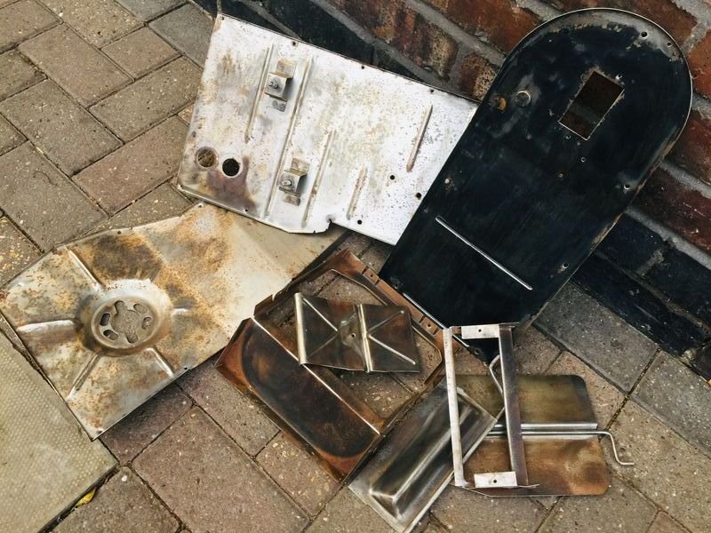

i should say, if i haven't already, aside from the heater core leaking, the hot/cold flap and the cabin/defrost flap were seized, so it did all need stripping down and cleaning anyway
Posts: 5251

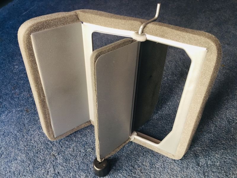

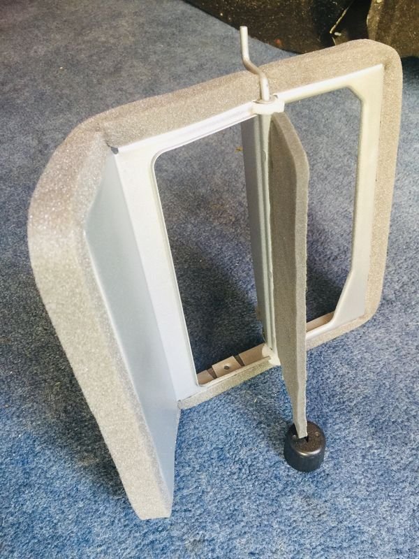

Applied the new foams
The Mopar B Body 66-70 Non Ac Heater Box Rebuild Restoration Seal Gasket Kit came with a most comprehensive set of instructions
