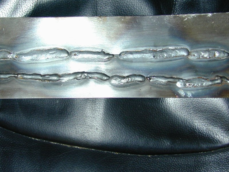

Anyway, with that done back to the car. I haven't used the MIG for probably 20 years, so I've had a bit of a play about on a practise piece and after a stringy start, got some moderately OK welds that look the same from both sides.

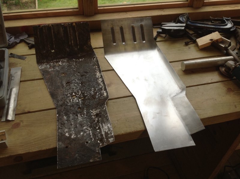

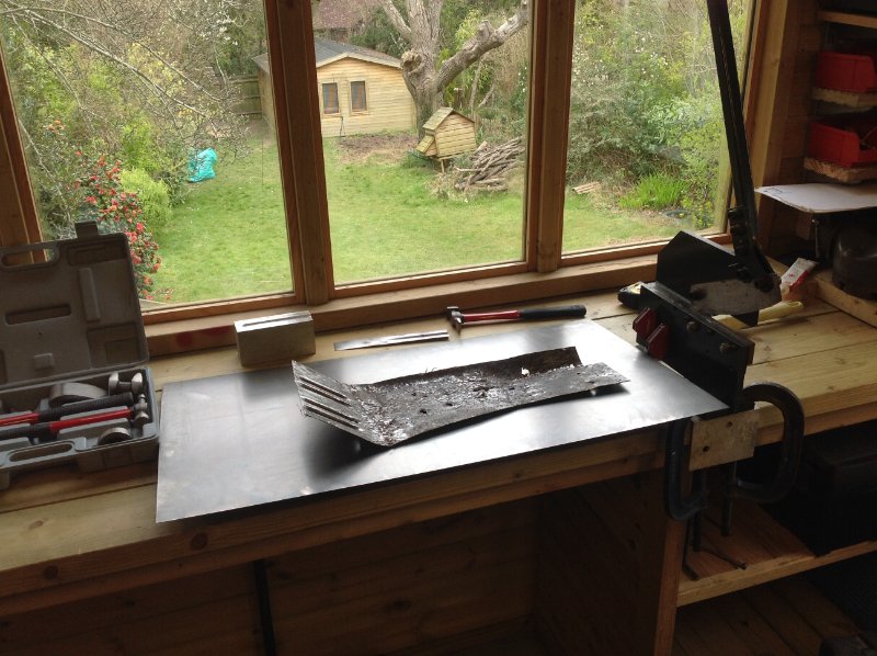

So, that's the bad bit out
Floor 7.jpg (115.85 KiB) Viewed 3982 times
Best make a new bit...
Floor 9.jpg (104.67 KiB) Viewed 3982 times
Re: Dom's 66 Coronet 500
Nice view,very relaxing 👍

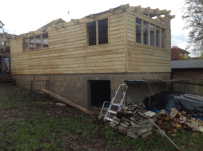

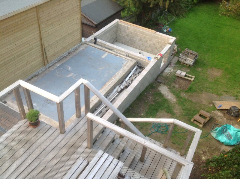

That is the extended version ! Thanks to the slope we're on it's already nearly a storey above ground at the back...
That’s lovely. Room underneath for stuff too👍

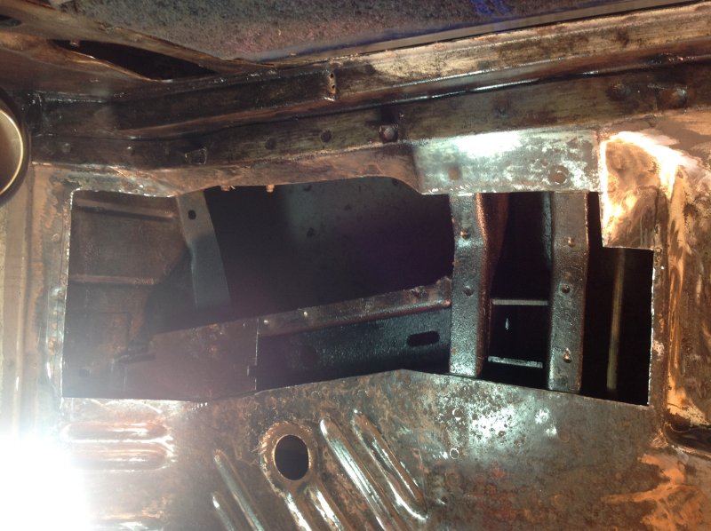

Got a wire brush and some rust converter as far up the exposed sections as I could, I'll hit it with some weld-through primer before zipping it up.
Floor 12.jpg (103.49 KiB) Viewed 3946 times

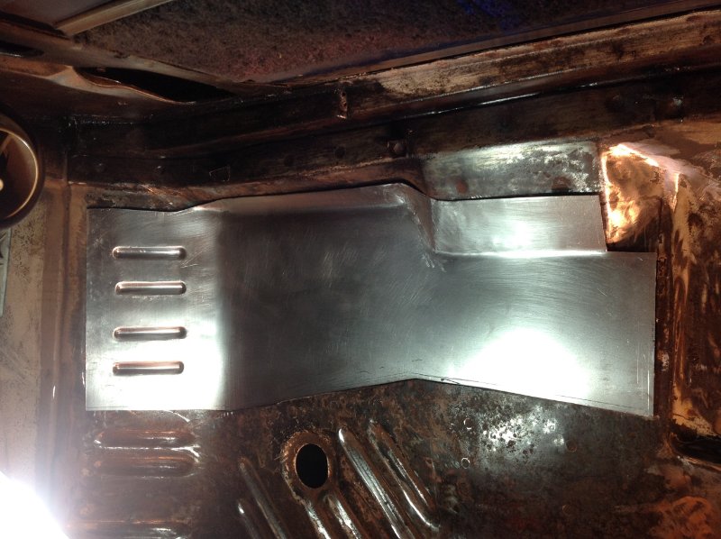

Got pretty close with the new patch...
Floor 15.jpg (74.79 KiB) Viewed 3946 times
It'll just need a final trim to fit.
Floor 13.jpg (96.69 KiB) Viewed 3946 times
Posts: 14456
That's nice work, I reckon you've done that before....
ooh! machine shop under the garage then. plenty of room (and ventilation) in the 'pit' then. :thumbright:

The garage certainly involved more ground work than I'd wanted, but I needed something larger than what was there before...
Underneath is a good store, but not quite high enough to stand up properly. 'Machine shop' is upstairs though...
