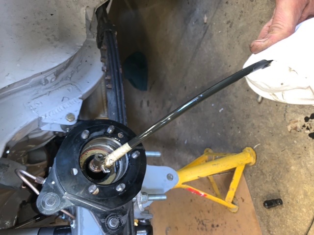

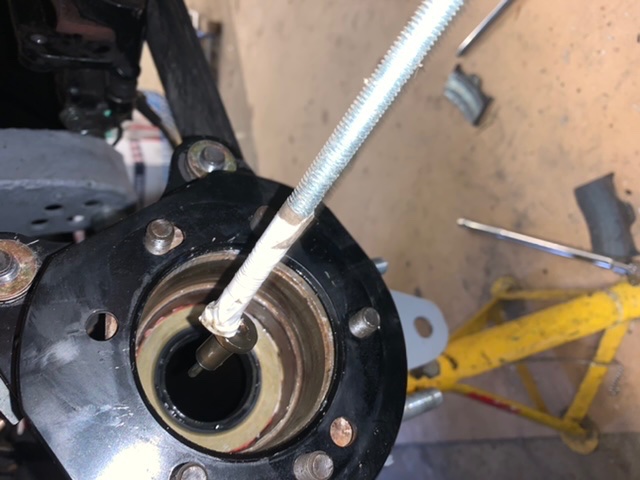

Realised this morning that i hadn’t checked whether the thrust button had become displaced during the halfshaft removal. Had visions of it getting caught in the diff gears, so pulled the halfshafts again to check. Shone a torch down inside the axle and Sure enough, the right hand half of it wasn’t there !
Just as i was resigned to pulling the centre section, I thought i’d try using a magnet to fish around for the thrust button.
Left hand side came out of its recess ok !
And after about a minute of fishing around the bottom of the axle, result with the the other half !

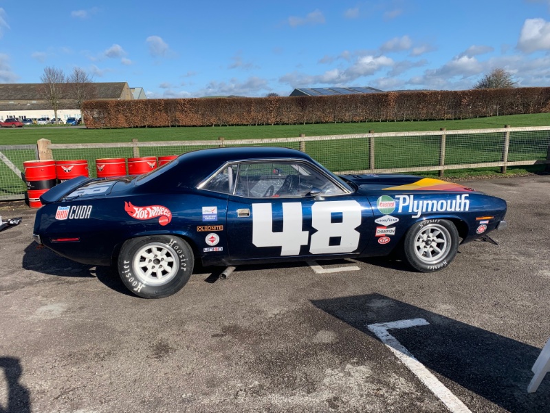

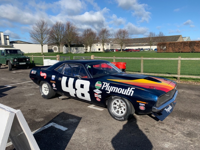

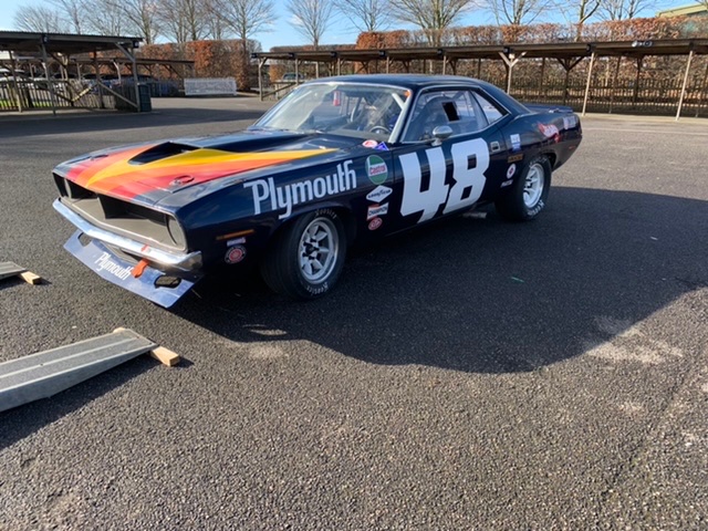

Finally fitted the Minilites and some new race tyres . Now that’s the look i’ve been waiting for ! I think the rear needs lowering just a little then I’ll have properly nailed it
- 1C153F8B-E9B8-452E-A739-0603F8C95B8F.jpeg (234.54 KiB) Viewed 5565 times
- 0416E5DC-6B6C-47F6-8CE7-1F2C4A06AC70.jpeg (234.74 KiB) Viewed 5565 times
- 8818C5A9-945F-4D65-9243-903F6EAFA735.jpeg (166.41 KiB) Viewed 5565 times
That looks the nuts
i agree
