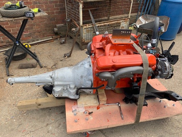

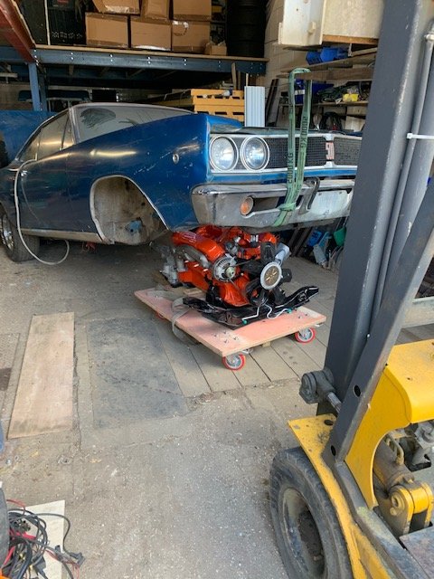

Hope to get the engine back in this week.

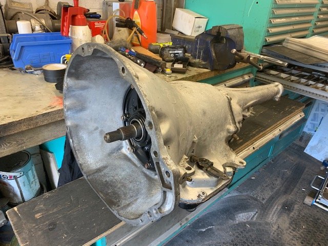

Cleaned off the old floor pan repairs and seam sealed them, ready for a quick coat of satin black to tidy them up a bit

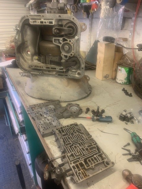

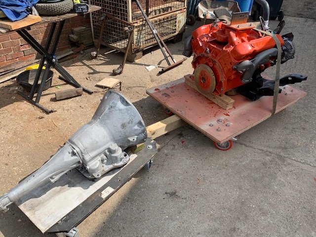

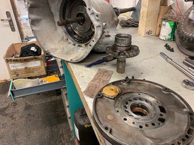

Had a look inside the transmission , as I'd left it outdoors last year for a couple of weeks . Yes I know I'm bad....
No water damage anywhere except for a partially stuck Torque Converter control valve (which is pretty much the first thing in line to the atmosphere at the front) , which soon freed off.
Pump etc OK
All done . With new gaskets etc.
Ready for mating to the engine
OK let's go !

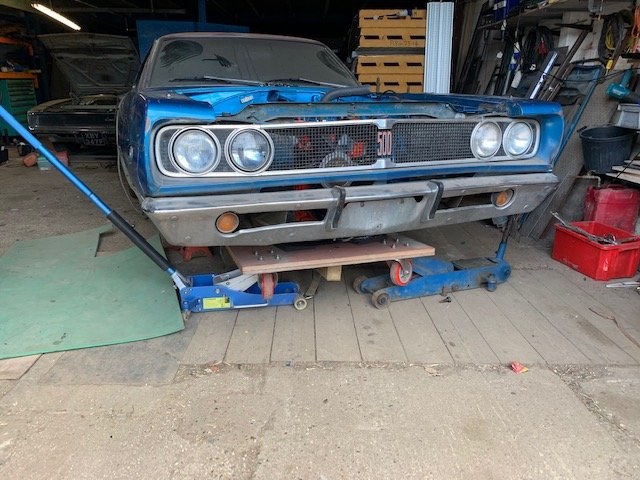

Progress has been a bit slow.

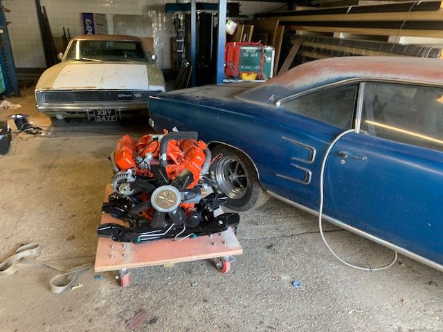

Engine back in though

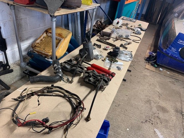

Got all the parts out. Going to start on the wiring first I think.
Also wondering where on earth the steering box bolts have gone.

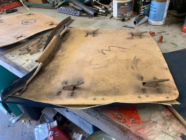

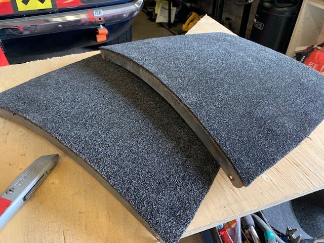

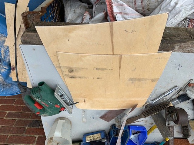

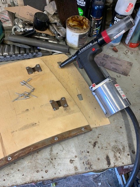

Been reconditioning the rear trim panels from the front seats.
Original hardboard warped and horrible
Cut some plywood copies
Add hardware
Add a thin layer of foam before covering in vinyl

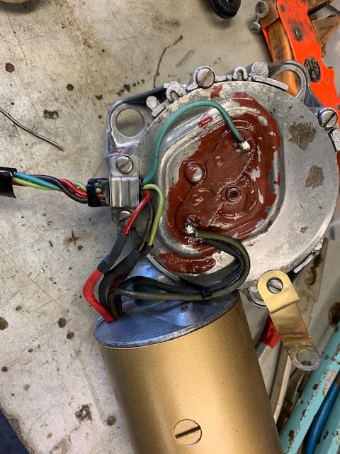

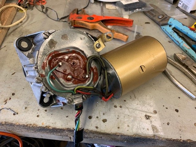

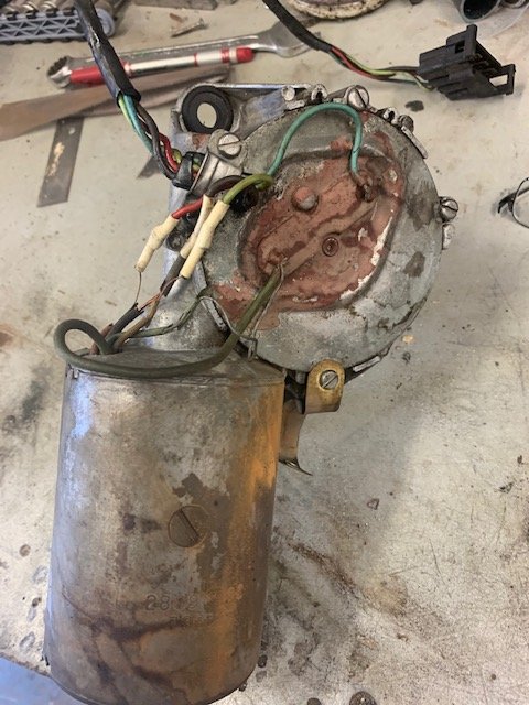

Wiper motor looking a bit sorry for itself

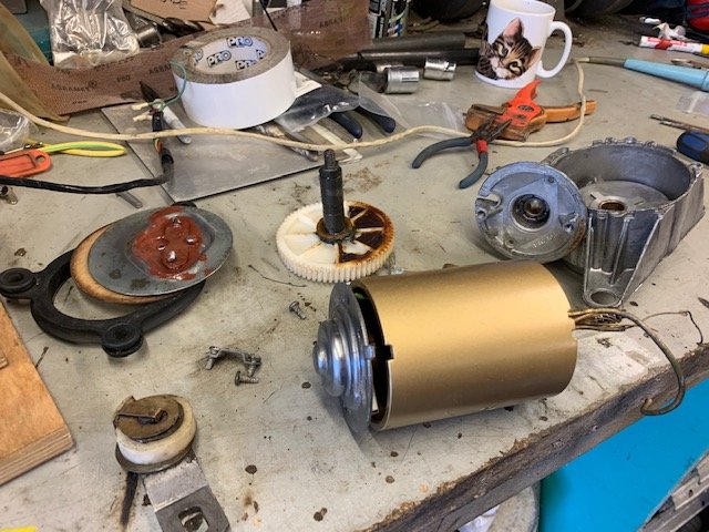

Corrosion removed, parts variously clear-laquered and painted. Not exactly 'correct' , but it's an improvement.
Reassembled, with wiring/sleeving replaced or tidied up
