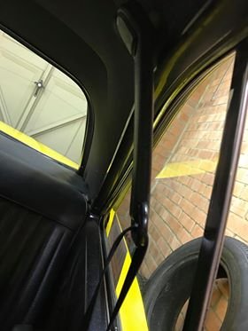

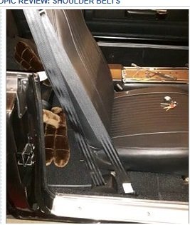

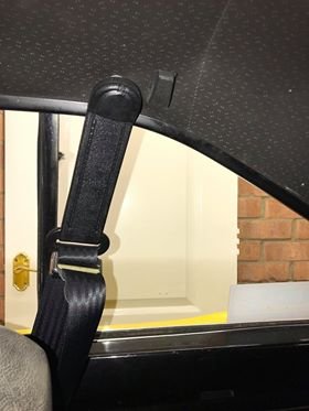

i put these in my Dart a while ago. They bolted straight in and the drop link positions the belt well on me ,I'm 6ft 4in Unfortunately they seem to out of stock at the moment. Good quality product.
https://xvengineering.com/products/xv-r ... eats-black

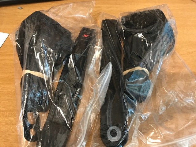

Ooh ! Look what arrived today ? Dont you love packages from America...? This is the XV racing products B-body 3pt conversion kit.
Waiting to see if the customs charge and 'uninvited handling fee' rocks up now too.
First glance, looks really nice. Proof will be in the fitting I guess.
You can see the droplink in the 2nd pic.

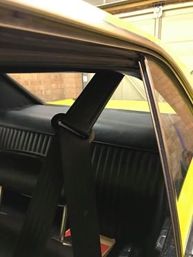

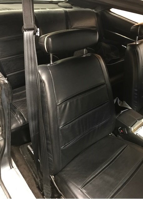

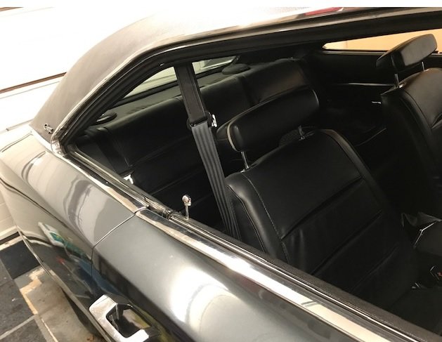

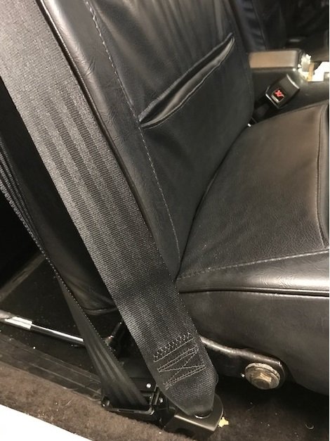

Well, its not bad. Couple of teething issues (had to turn the buckle etc as twisted).
They work fine, MUCH better than the stock hang-from-ceiling. On a Charger they dont clear the plastic trim on the side of the seat so had to remove it. Not a big deal, it goes in the box with the rest of the old belts, but it was the only way to get clearance. Couple of big washers too. Other than that, 30 mins start to finish.
