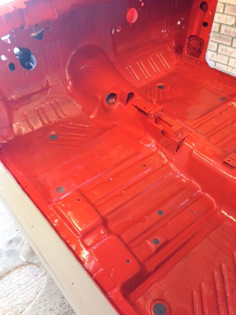

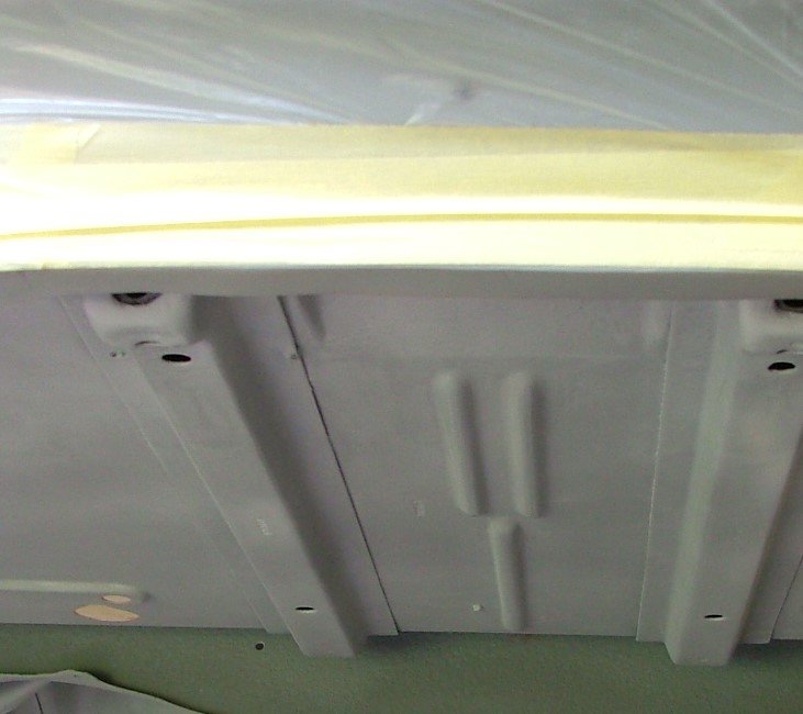

Part numbers are still stamped in the floor and tank rails,
71 340 RT Challenge Driveway resto........
Re: 71 340 RT Challenge Driveway resto........
download/file.php?mode=view&id=128502&s ... d6b6230251
- DSCF3618 (2).JPG (76.77 KiB) Viewed 6134 times
- DSCF3625.JPG (75.54 KiB) Viewed 6134 times

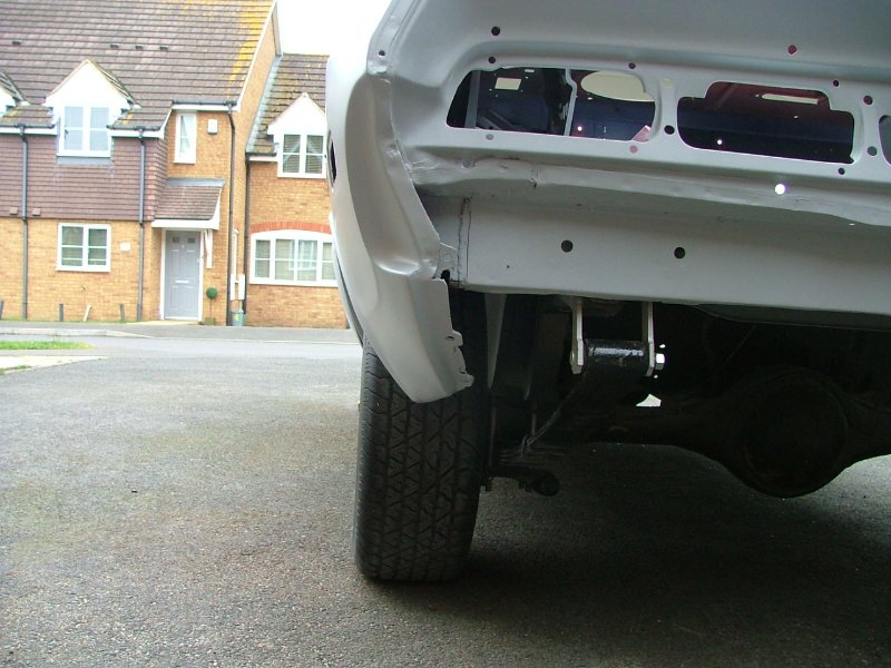

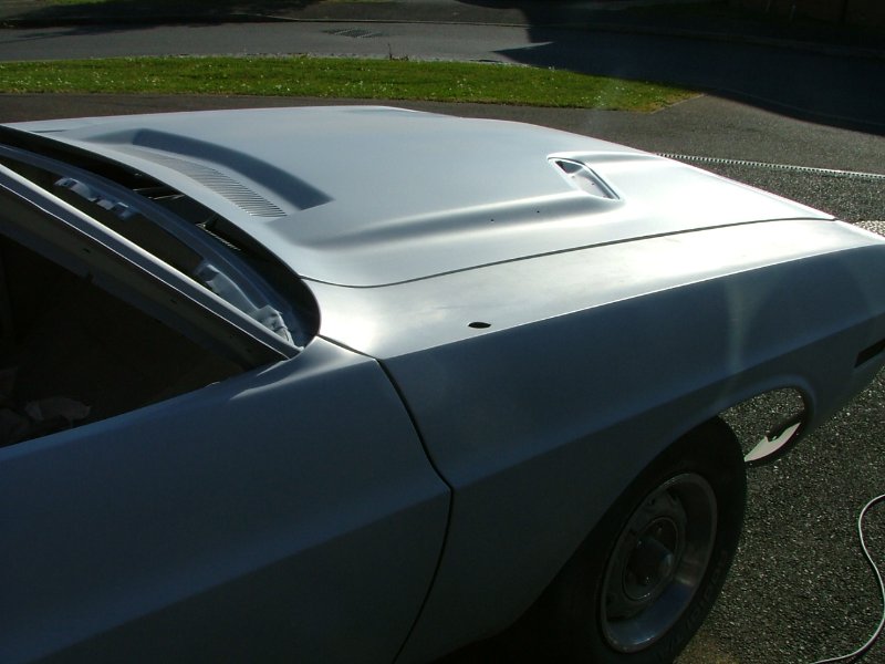

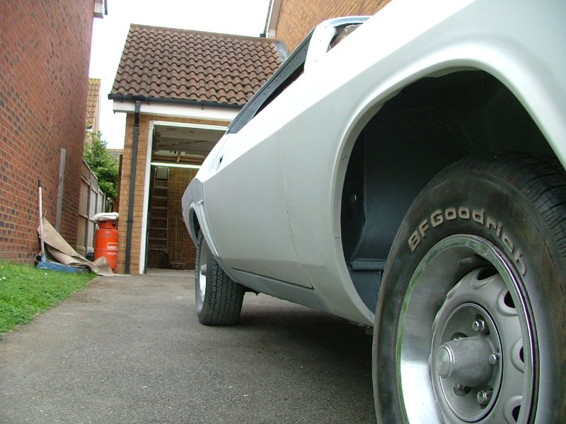

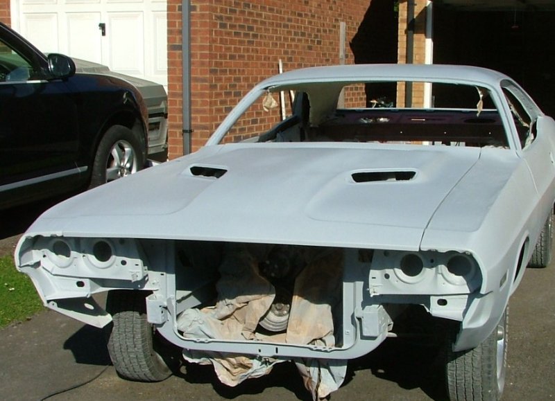

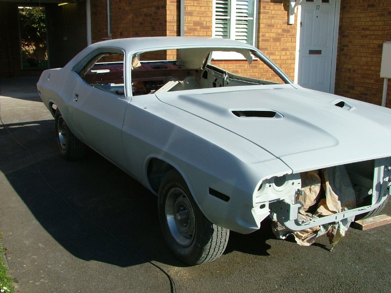

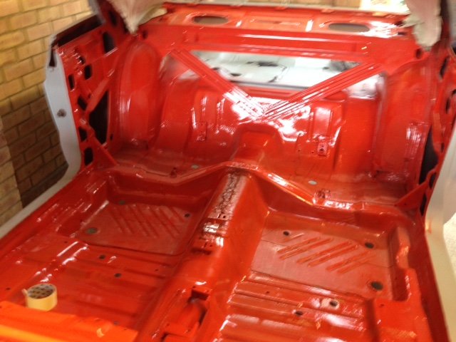

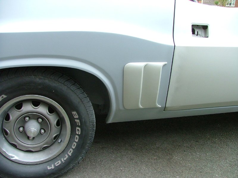

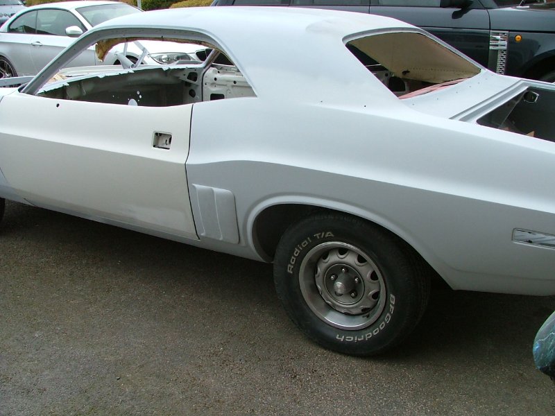

Quick update,
For some reason i never took ant decent pics of the engine bay work, probably because apart from stripping, metal cleaning there was'nt a great deal of crap, had to make good the bulkhead both sides but that was it really, i'd already done the doors and front quarters so the shell was prepped for
primer, download/file.php?mode=view&id=128742
To be honest the panel fit could be better, but doing this in bits and not having the space to fully assemble meant i could'nt really test and then correct crap fitting!
but considering this the gapping aint horrendous , and more importantly not faked! some many so called restored cars have wired or gobbed gaps!
The old girl has some gob but its not covered in it unlike most Yank resto's and almost all E types!
- DSCF3487.JPG (95.64 KiB) Viewed 6108 times
- DSCF3495.JPG (106.86 KiB) Viewed 6108 times
- DSCF3494.JPG (80.56 KiB) Viewed 6108 times
- DSCF3490.JPG (102.54 KiB) Viewed 6108 times

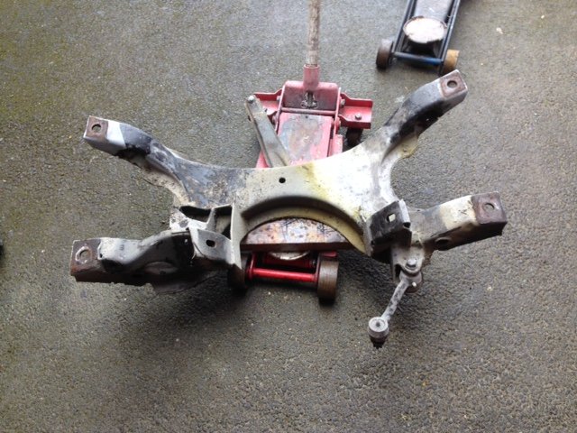

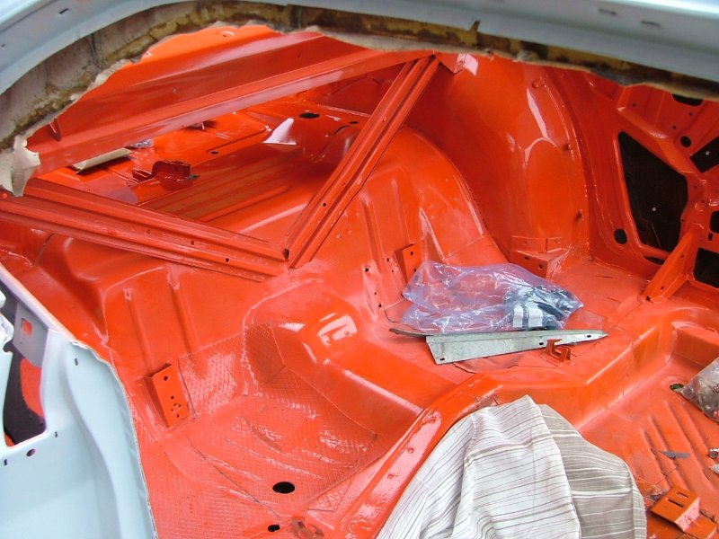

download/file.php?mode=view&id=128758
These are a year ago, once i got here i started to pull the running gear off, removed as much from the block as i could, made a steel support to hold the motor while i removed the K frame etc, as the thing was now a none mover i lifted the arse and dropped the axle/springs etc so i could Raptor the under side.................
- DSCF3533 (2).JPG (113.8 KiB) Viewed 6075 times
- DSCF3538.JPG (74.23 KiB) Viewed 6075 times
- DSCF3539.JPG (102.39 KiB) Viewed 6075 times

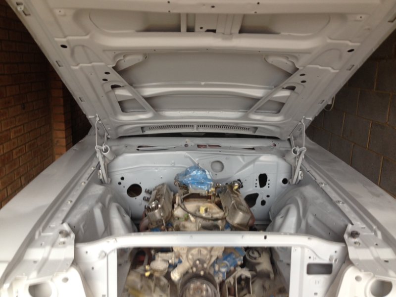

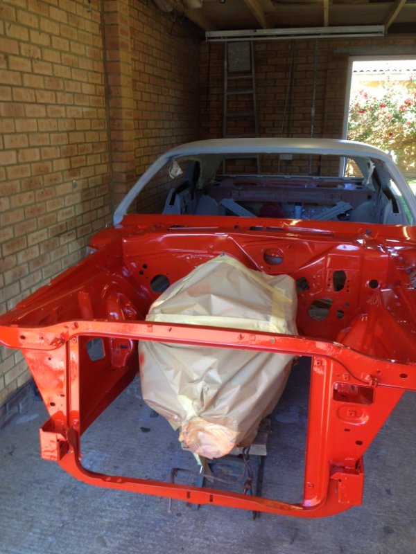

https://www.moparuk.com/fhttps://www.mo ... &id=128771
Ideally should have pulled the motor, but i just did'nt have any where to store it!
I made up a up and over frame to support the front of the motor while i removed the K frame.
The four large bolts all came our ok, tons of release spray and slowly one by one they came out, id read that sometimes depending on how much corrosion there is in the front rails these bolts can and do break there captive nuts off, big trouble!
Painting a mica based clear over base in such a small space was a challenge lol....................
I guess it was about this point that i seriously began to wonder what the f--- id let myself infor!
Id virtually done all the work that gets covered up, actually prepping the whole shell for paint is a big job in a equipped body shop, but in my car hole
i was beginning to think it could'nt be done
- IMG_1756.JPG (88.17 KiB) Viewed 6044 times
- IMG_1691.JPG (71.02 KiB) Viewed 6044 times
- IMG_1768.JPG (94.63 KiB) Viewed 6044 times
- IMG_1770.JPG (93.09 KiB) Viewed 6044 times

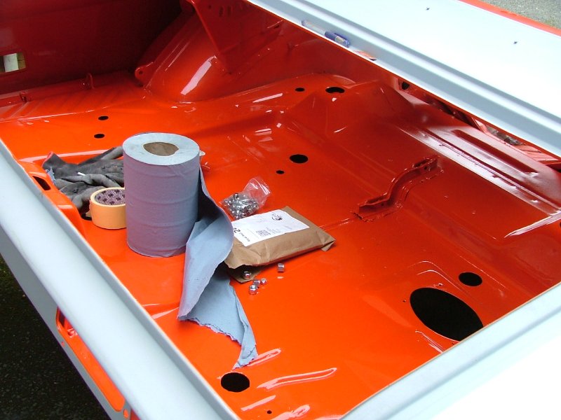

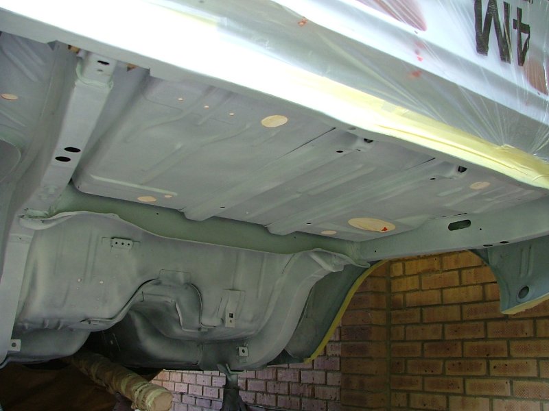

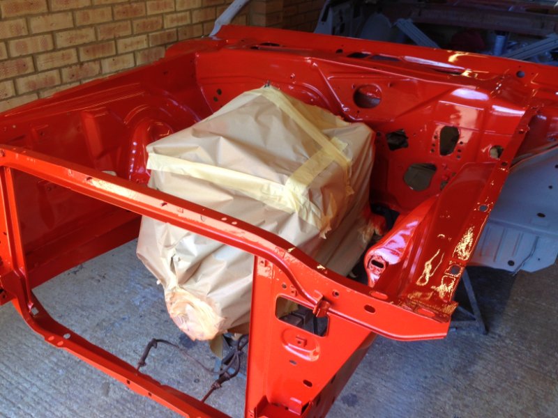

download/file.php?mode=view&id=128809
Had to paint the inner bits in sections, deffo need a Spit Roast when doing this type of refinishing!
- IMG_1777.JPG (55.68 KiB) Viewed 6026 times
- IMG_1788.JPG (62.07 KiB) Viewed 6026 times
- DSCF3603.JPG (109.8 KiB) Viewed 6026 times
- DSCF3597.JPG (88.61 KiB) Viewed 6026 times
Great stuff but wow that looks tight in there

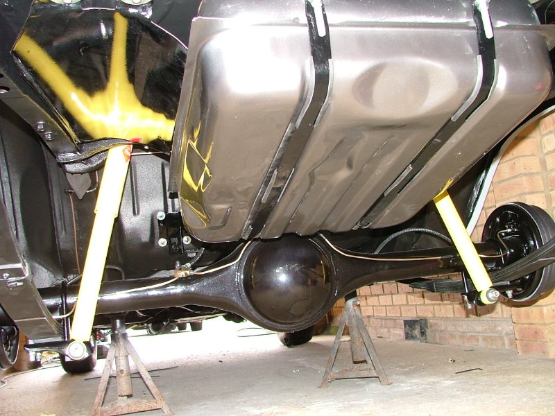

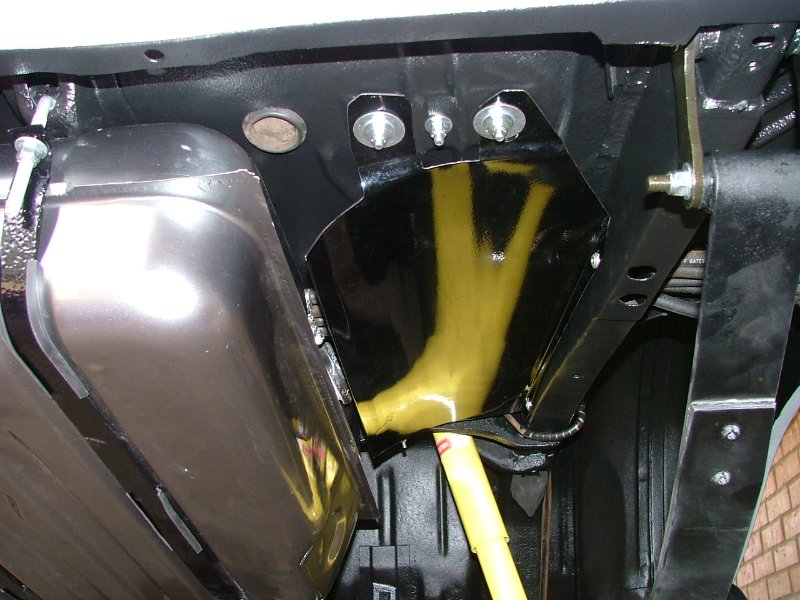

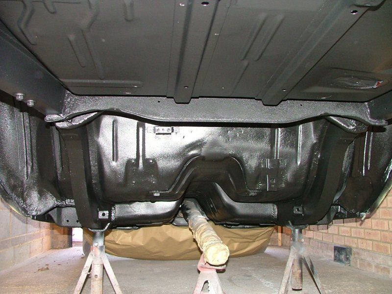

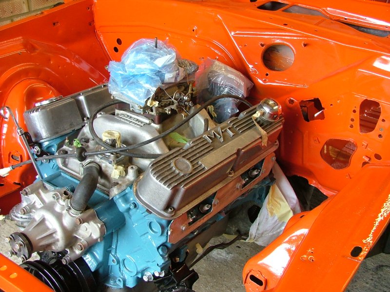

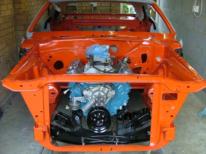

Yep its snug alright
download/file.php?mode=view&id=128818
I blasted and properly clean the K Frame, which was pretty much perfect , its got a bit of distortion where its had a jack under it,but normal use really
All the gubbins were Eco Phosted, and black 2k'd...........
The whole of the underside was refinished in U Pol,Raptor Epoxy,
Cleaned and prept the block for paint, this was just put on with a brush, when dry the frame and mounts were installed,
- DSCF3627.JPG (114.51 KiB) Viewed 6001 times
- DSCF3592.JPG (128.26 KiB) Viewed 6001 times
- DSCF3593.JPG (133.77 KiB) Viewed 6001 times

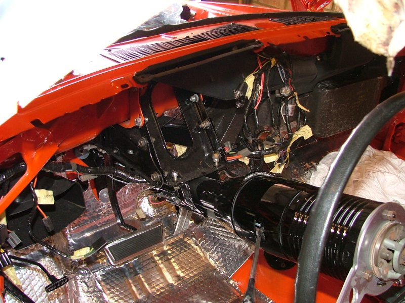

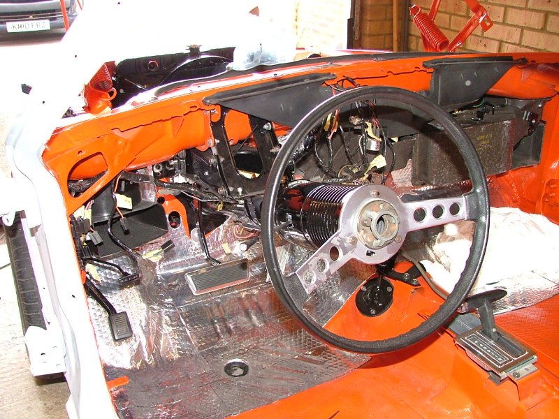

download/file.php?mode=view&id=128979
Going back together at this point, i'l speed up the refit as the cars is now almost done!
- DSCF3665.JPG (123.51 KiB) Viewed 5928 times
- DSCF3668.JPG (102.46 KiB) Viewed 5928 times
- DSCF3671.JPG (145.71 KiB) Viewed 5928 times
- DSCF3673.JPG (135.08 KiB) Viewed 5928 times
