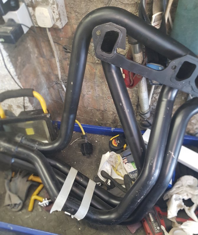

Ah, the joys of aftermarket headers!
Engine needs to be tilted to get the nearside fitted, and if I ever want to change the rear spark plugs, it will have to come off :cry:
And the drag link fouls it enough for some 'relieving' to be required.....some subtle mods in the area between the tape :twisted:
But in better news, the 'swap the left to the right and the right to the left' Poly mount trick does work on the 360 LA (with a little bit of jiggery-pokery.)

Re: And so it begins! 318 Poly to 360 LA Swap
No surprises there.
Try a big block or a Hemi if you really wish to enter a world of pain.
Most of installation is learning the sequence of installation, where most often the Pass side header goes on first due to less clearance as a result of the engine off-set.

The good news is that the newly 'relieved' header fits perfectly, coupled with the fact that although the Hedman fact sheets said I may need to modify the transmission linkage, it actually all fits with no modifications :thumbright:
Then the annoying news - didn't spot that someone has mangled the brass fitting into the tranny, which basically stripped the whole thread from the case :P That has slowed down the next stages.....
And the longer water pump on the 360 is going to give me some radiator clearance issues :cry:

Posts: 14523
The thing with headers is the engine needs to sit in the car level side to side. Often the position it naturally wants to sit is on the tilt, a certain amount of jacking about is often needed to force it the sit straight before you bolt the mounts up.
