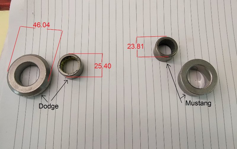

I think you need to buy a roller bearing for a 318 or 360m magnum
and a roller bearing for a 2000 ford mustang
press the roller bearing out of each and put the mustang bearing in the mopar magnum bearing holder and whack it into the boss of the crankshaft flange where the converter spigot sits on an auto that should work.
If it's not deep enough a longer roller might be necessary, I can't see how far the end of the input shaft sits into that area in the end of the crank. I used an adapter that put the end of the spline level with the frication face of the flywheel...that might have resulted in not enough space for the plate or indeed a need to push the bearing back a bit in its boss.
But I have a problem
I did as you said and bought the two spigot bearings, a Dodge Dekota and a 2000 Mustang spigot bearings.
The Dodge bearing retainer fits great,the problem is the mustang bearing is too small for the Dodge retainer.
Have I done something wrong?

just go to your local bearing supplier with the dodge bearing 'carrier/sleeve' and the ford roller bearing (as well as the gearbox input shaft size) and they supply the right one.
choice 2 is get a local engineering firm to turn a new bearing 'carrier/sleeve' to fit your dodge crank and the ford bearing.
either will work, neil.

Once back at work, I can make a carrier. But I really want as many parts as possible as just plug ang play, rather than making bespoke parts, if possible

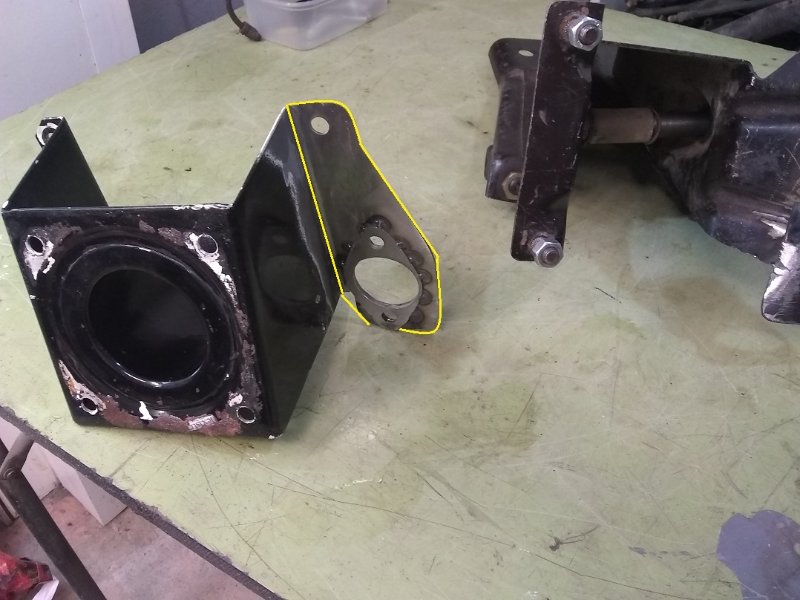

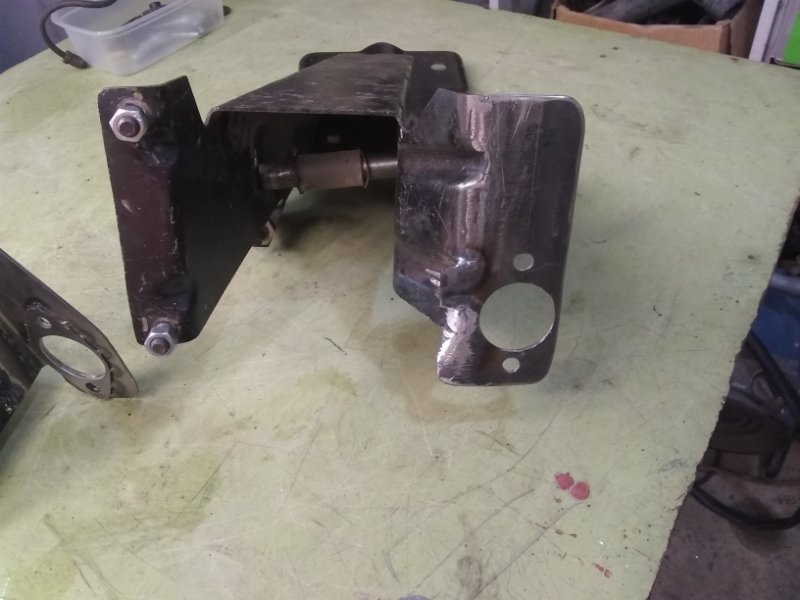

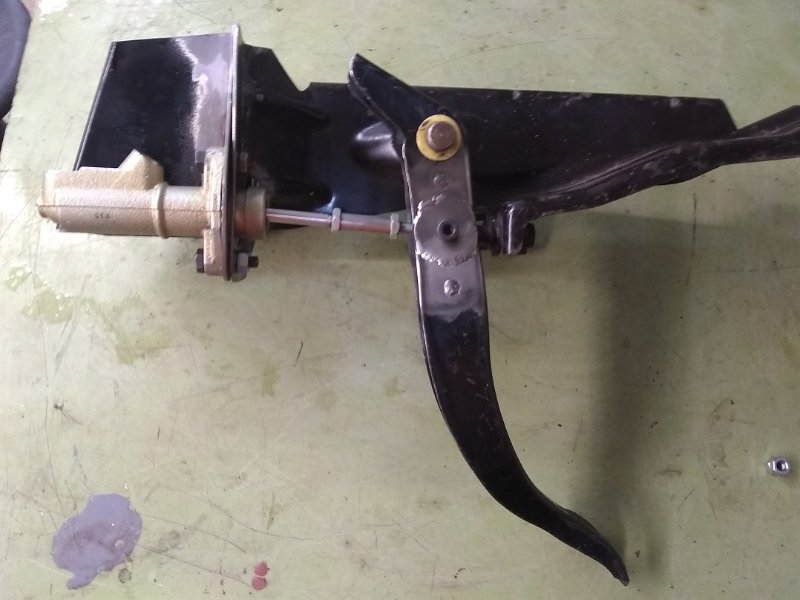

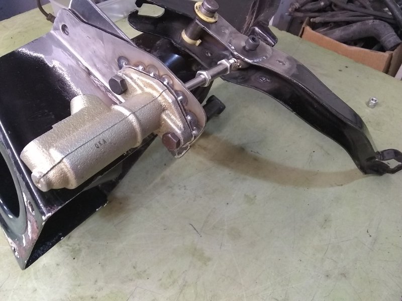

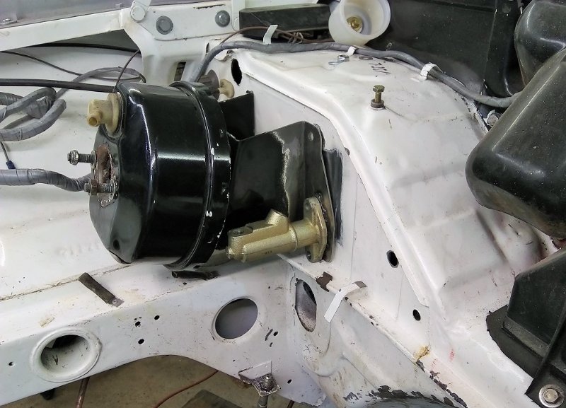

On with the hydraulic clutch conversion.
Well there's lots to learn before you just drill the pedal and put a master and slave cylinder on
Bore size'' stroke'' hydraulic ratios'' leverage point'' ect.
I like to keep things simple and cheap if I can ..
After lots of research I went for a Land-rover series 2A master cylinderthat has a 3/4 bore and a Rang-rover slave cylinder that has a 7/8th's bore.
I did make a set-up with the two piped up using some with clamps and a bit of break pipe ,, Yeah it worked, " forgot to take a picture
Found the point on the clutch pedal that gave me the 35mm of movement needed to move the slave cylinder 24-26mm to release the clutch plate, made up a new push rod with metric threads and a rose joint end.
Drilled a new hole in the bulkhead and fabricated some new fixing points for the master cylinder.
The last picture is it all together as a trial fit

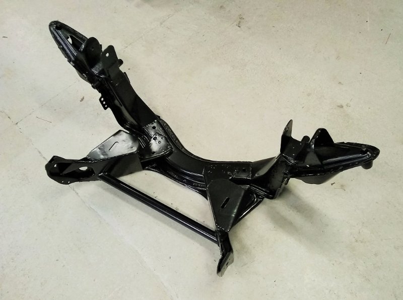

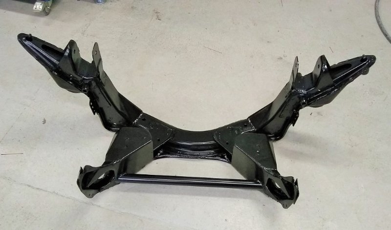

New engine mounts made and a coat of satin black
- IMG_20200827_145353164.jpg (87.5 KiB) Viewed 6576 times
- IMG_20200827_145401833.jpg (77.49 KiB) Viewed 6576 times

Nice work, the master tucks nicely behind the servo.
