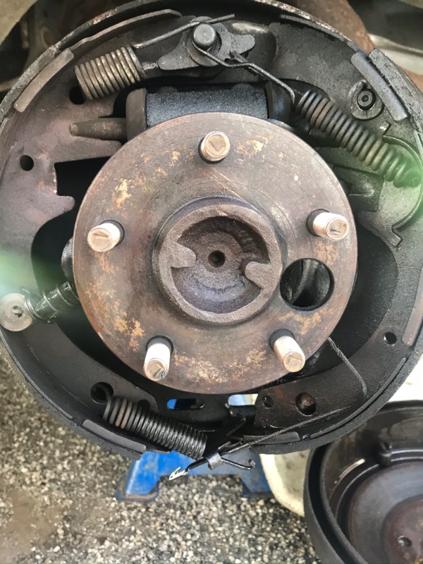

Ok, this is an odd one and I’m currently stuck. When I first got my car I notice that if I reversed a little fast there was a clunking noise somewhere at the rear end. A few days later noticed a hot rear brake drum, posted on FB about the struggle to get it off. Did eventually and found the spring for the star wheel hanging loose, fixed it and drove on.
Today whilst driving out I noticed my brake pedal was sinking too much, I managed to get back through town constantly pumping the brakes and arrived in one piece. Here’s where it gets wierd..
I checked 3 of the wheel cylinder and noticed one had a slight leak. I checked the MC and noticed a tear in the diaphragm and thought that may be the cause.
I then reversed the car down the drive and heard some nasty metallic nose from the rear, suddenly lost all pedal and stoped the car via handbrake before I crashed it :roll:
A quick check showed that the rear wheel that I’d had trouble with previously had completely blow out and there was fluid everywhere. I’m sure something is wrong with the brake parts but no idea what.
Any ideas what happened here?
Also, the drum
is stuck on and refuses to come off and I’m stuck.

sounds like
1) the problem drum was out of adjustment with the shoes backed right off and the adjuster fell out of its proper position
2 reversing triggers the auto adjuster which probably didn't auto adjust, the lever just pushed the adjuster out of its position further rather than winding the star and expanding the length of the adjuster against the shoes and retracting springs
3) you got by, by applying the brake which must have wedged the adjuster and stopped the cylinder blowing out
4) the adjuster eventually fell out leaving the shoes flapping
5) pressing the peddle now allows the cylinder to fill and push the pistons right out of the cylinder causing catastrophic brake failure..
probably not that
but you ended up with flapping shoes and it allowed the brake cylinder pistons to go past their end stop and out of the cylinder.
usually an issue with badly worn shoes and drums that have been worn away to 1/2 their wall thickness.....had the same problem on a split screen VW drums were way past their sell by date with a ridge of about 2 mm out of spec..by a mile.
massive loss of fluid from the Master Cylinder, can suck the top gasket or diaphragm down so low it rips. it usually has 1 or 2 dimples in it to cater for this but they can only stretch down so far and the rubber degrades anyway
Posts: 9617
Re: Brake stuck (again) , wheel cylinder blew out
drum stuck is probably caused by shoes rammed right round past the anchor pin
and a massive step or lip between the swept area and the edge. potentially not 2mm but any lip will cause this
screw driver in through any hole and try and loosen them off
wind the hub back and forth with a bit of angle iron, long lever, bolted across 2 of the studs, you need to get the shoes back into more or less the At Rest Place, you may snap the studs i have a bag if you are stuck
a BFH might be necessary
or borrow a hub puller and suffer the fact it will probably bust/bend the shoes and the puller
look up duo servo brake bendix to see the parts
Posts: 9617

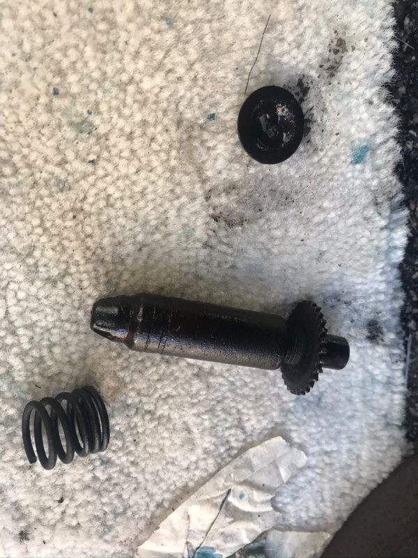

see if that adjuster falls out (bottom) any pressure applied by the cylinder (TOP) to the other end of the shoes just drives them round and allows the cylinder to pop
the adjuster will fall out if you wind the star around far enough to make the end caps get to the end of their thread
that auto adjust lever can do this if the shoes and drums are worn past their lowest...i.e out of specification
have you done a bit of reversing recently??
it activates and winds the star round every time you reverse and can wind the centre section out of the threads of the cap section that fits into the shoe.
i took the auto adjuster out of my charger as i was sick of getting binding rear brakes every time i reversed....
the aussies do an RT only spring set to achieve this bottom spring slightly longer so it goes shoe to shoe not front shoe to a hole in the adjuster
or i guess you could potentially use one from a 10 inch drum on a 9 inch drum or an 11 inch drum on a 10 drum
picture isn't mopar so the adjuster set up isn't quite the same in respect to spring mountings and its missing the hand brake rod/beam

Dave was spot in with his diagnosis as usual. Pic shows the carnage :o
