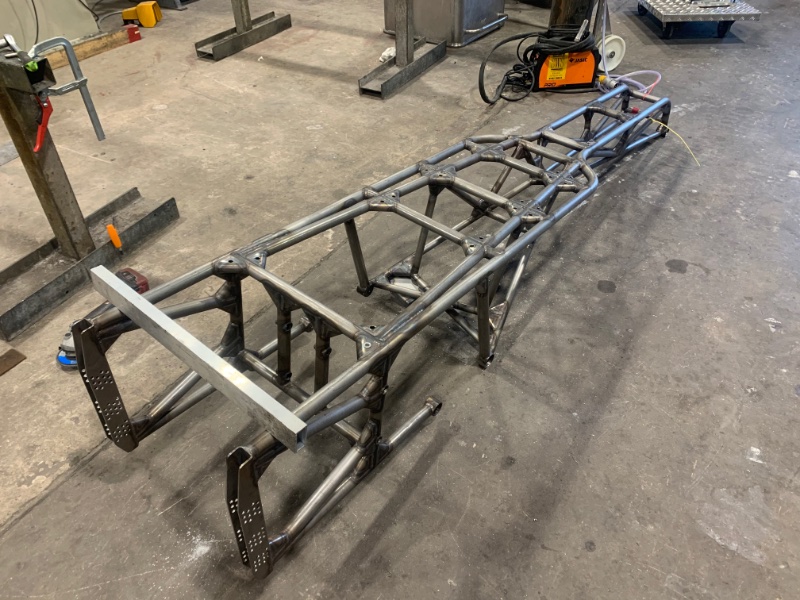

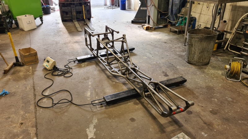

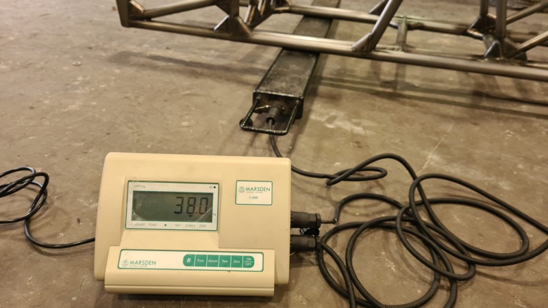

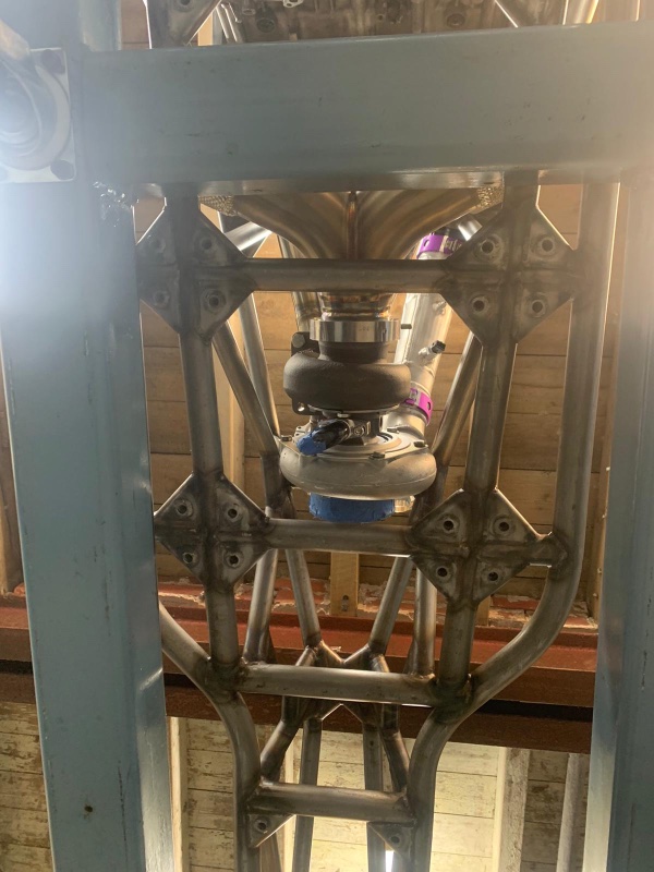

RobTwin wrote: Fri Sep 25, 20 1:11 am I hope the frame is still the same weight you had planned for... :-k :shock:
Frame all done and it’s 38kg !! \:D/ \:D/
Compare to a B body I’m quite happy and I think this is good ??
Posts: 22262
Re: Fifty shades of Jade
Fantastic work!!!

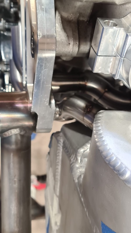

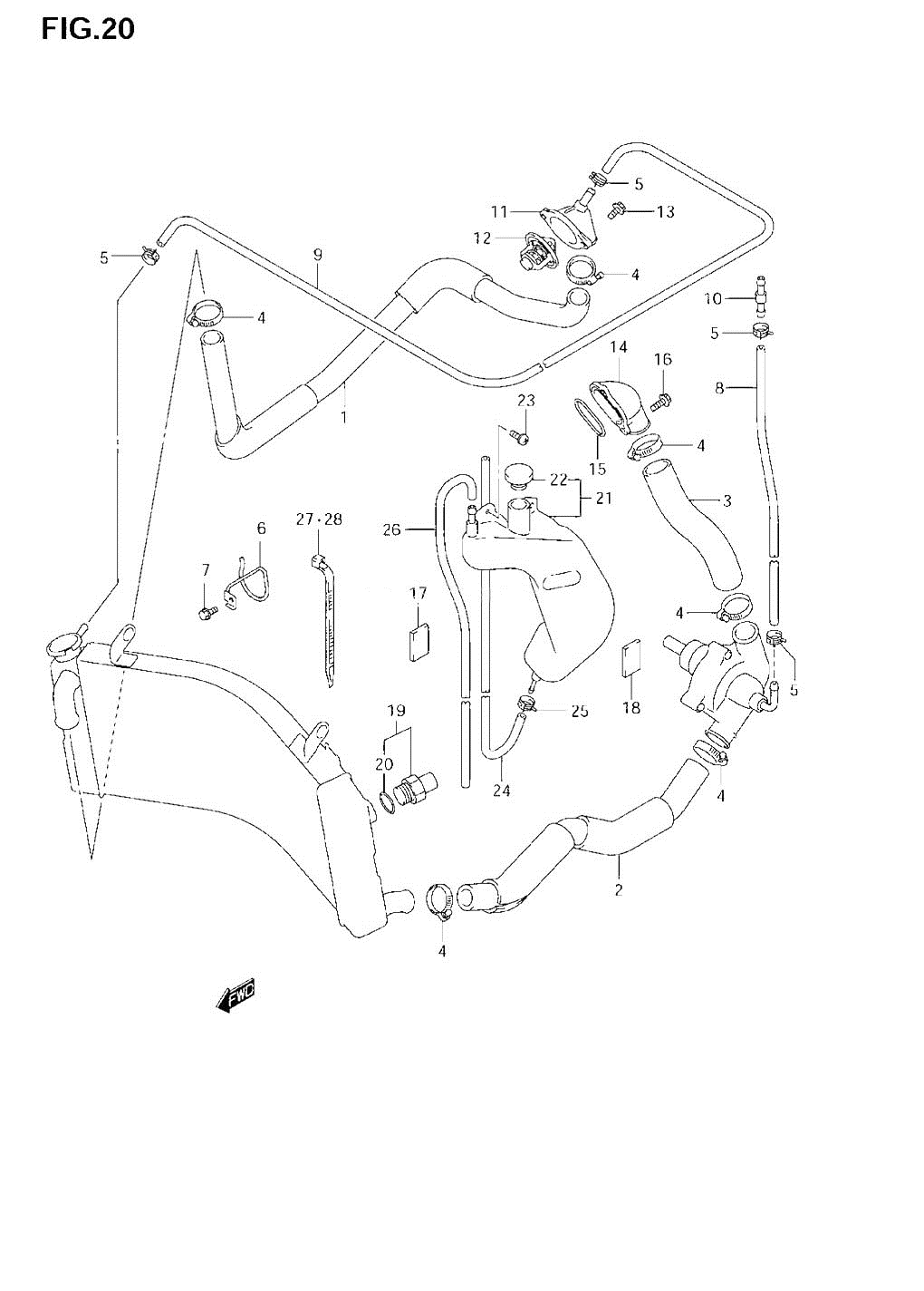

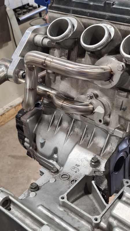

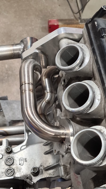

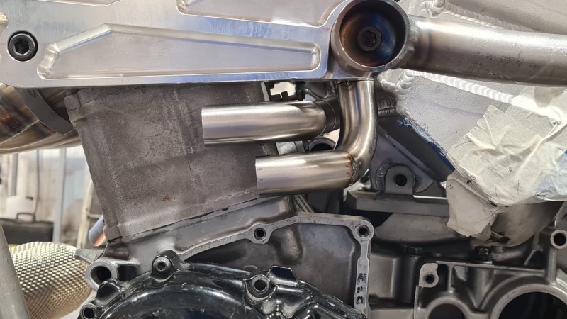

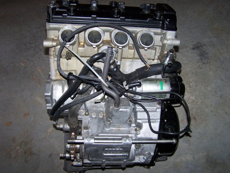

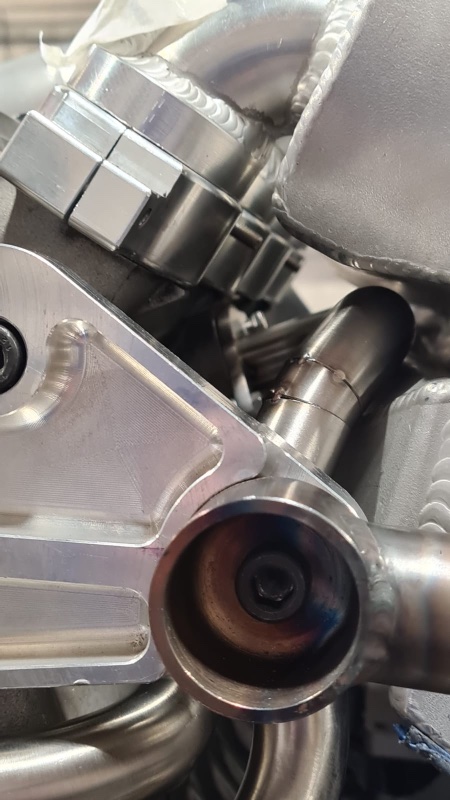

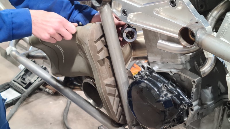

Next up radiator engine hoses
On a standard hayabusa these are the standard factory mess
so started making some stainless ones and will be using AN16 Braided lines braided lines for all coolant.
Just need to decide where to put the rad
:-k :-k :-k :-k :-k :santa: :-k :-k :-k :-k

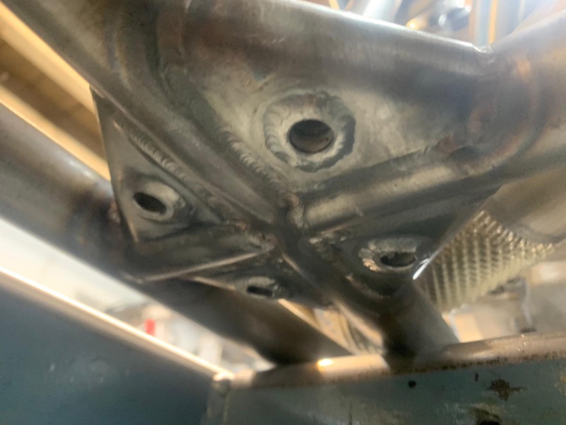

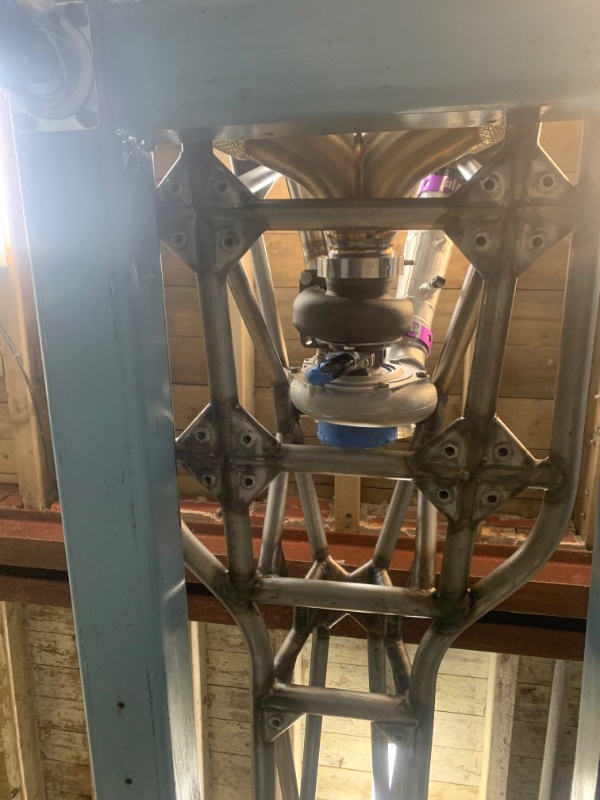

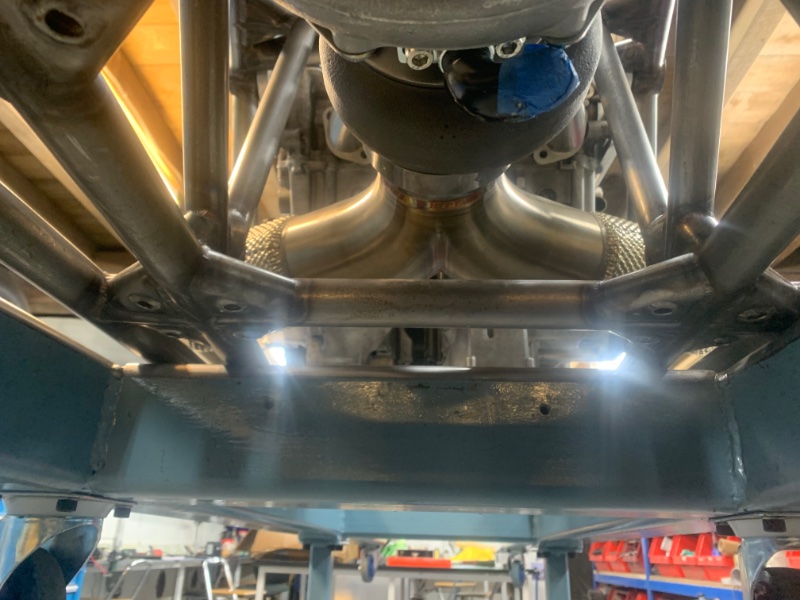

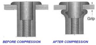

Under-tray or some sort will need to bolt to the bottom of the chassis.

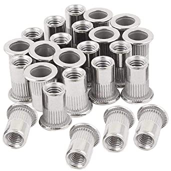

I added lots of rivet nuts to all the gussets underneath and then welded every one in so it’s 100%
Never used them before and think there quite good :thumbright:
We use a lot of rivnuts at work. Seem to work well. Had no problems so far :thumbright:
Posts: 1687
Mossy68 wrote: Thu Oct 08, 20 10:21 pm We use a lot of rivnuts at work. Seem to work well. Had no problems so far :thumbright:
Same here :thumbright:
Post by Bratfink »
SCTA rulebook says not to fill the corners of gussets. Not sure why, but that’s what it says.
I am coming to believe a 56mph speed record is harder to achieve than a 400mph one!
Posts: 1521
Bratfink wrote: Fri Oct 09, 20 1:18 am SCTA rulebook says not to fill the corners of gussets. Not sure why, but that’s what it says.
Dirt Trap / Drainage?
Added stress in the corners?
Posts: 14112
And there was me thinking a filled gusset was a good thing #-o :roll:
RobTwin wrote: Fri Oct 09, 20 1:31 pm And there was me thinking a filled gusset was a good thing #-o :roll:
There not gussets there Partial tubes very different :thumbright:
A great design adding maximum stiffness for minimum weight to the chassis. :thumbright:

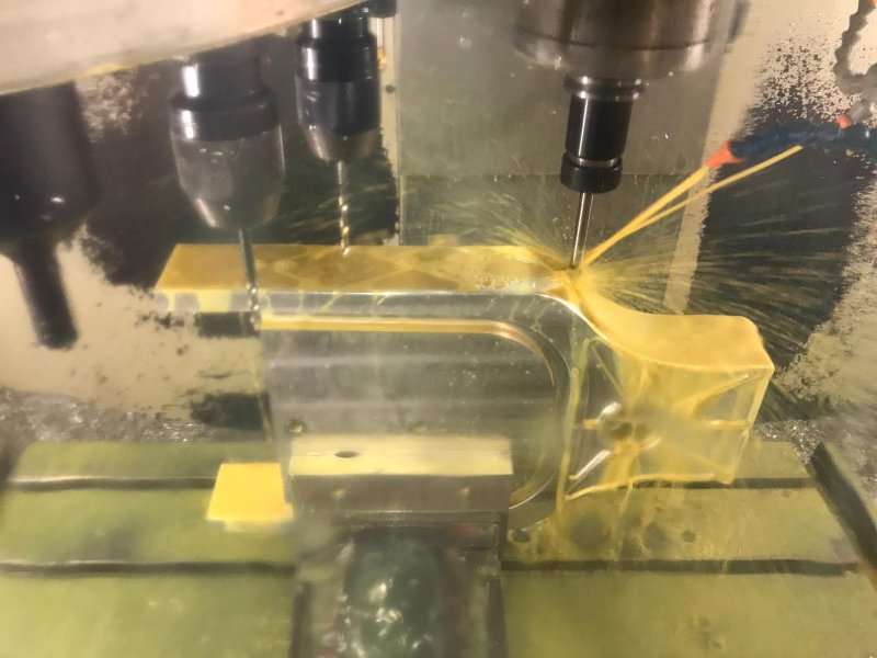

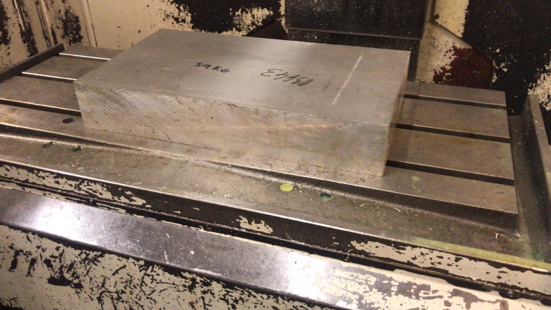

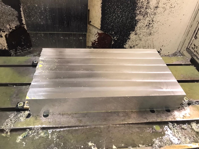

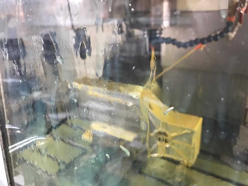

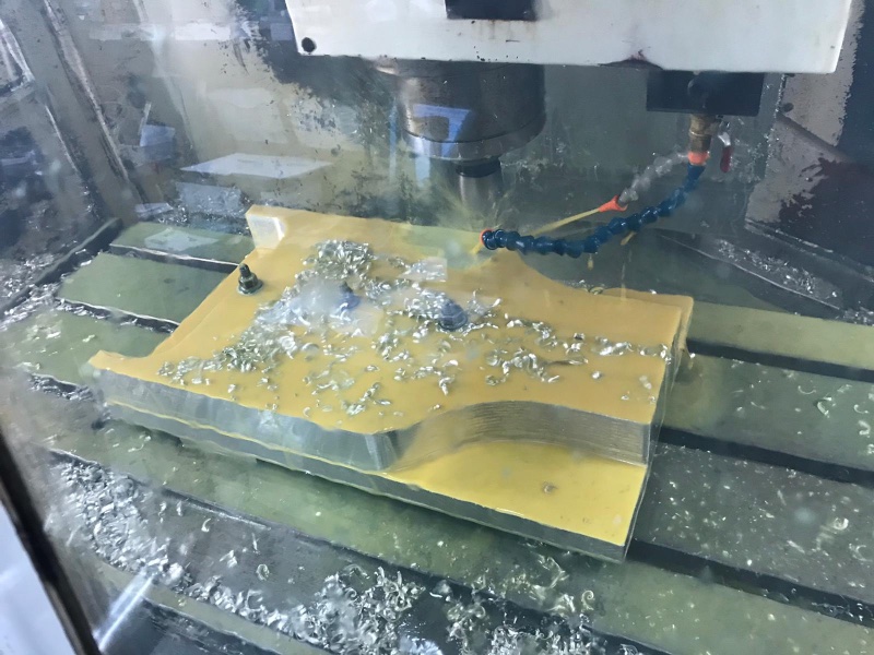

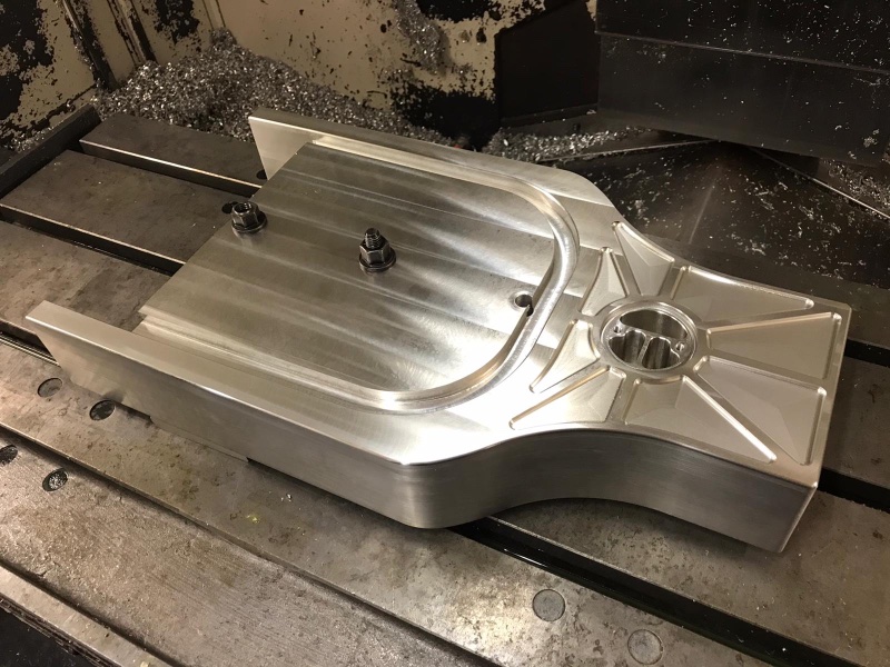

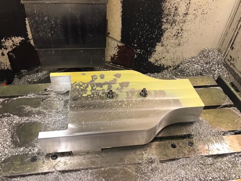

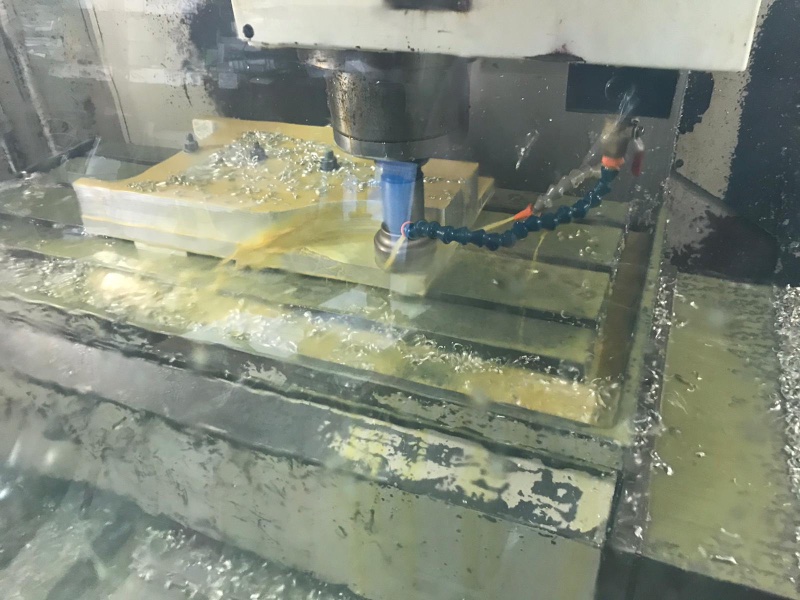

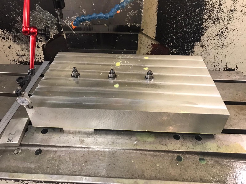

40kg block of aluminium.
1000mm x 70mm x 500mm :shock:
Under 5kg when finished !!!
The milling machine has started !!!!
:shock:
