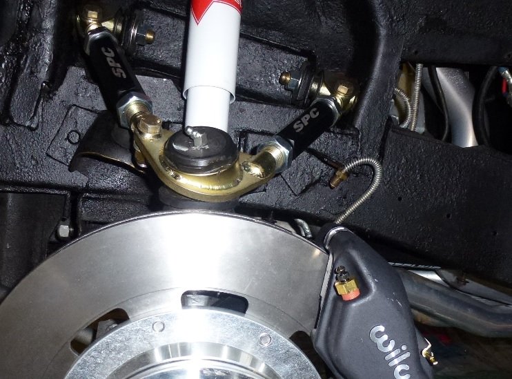

I dont know if he is still doing it but Roger from (ex?) Monkfish did mine - really knows his stuff.
The problem you will have is that they were never designed to give enough something-or-other (castor ? Camber ? Dont remember which). The adjustment is all carried out on some egg shaped cams on the bolts - which apparently dont move enough.
I ended up doing tubular UCAs which adjust every which way - depending how serious you are it might be worth looking into ?
Anyway. Find Roger !

you can lie feet going back under the car head sticking out near the front pumper looking at the thread and adjust the track rods with each hand.
you need to achieve a situation where you get the black dot 4-5 mm past the pin when the pin is at the front of the wheel
and ideally you achieve this by adjusting both track rods equally otherwise you introduce a slight pull left or right.
this gives you a smidge of toe in when standing still and hopefully that amounts to 0 toe in when the rolling resistance of the wheels causes everything to move slightly when in motion
have a cup of tea
do up the track rod clamps and take a gentle drive
No hands and it should not need correcting
steering should self centre from a corner
all good
go for a 10 minute drive
come back and check tyres for fresh peel on the very edges of the tread on the shoulders if none ... no scrubbing.
you are now in a position to say That'll do or to drive safely to the alignment place to get you handiwork checked
hopefully the chap does spot some tweaks he needs to make. if he doesn't i'd suggest you find a new alignment place
you are looking for a 1/16 to 1/8 inch toe in 1/8" is 3.175 mm
2.5* castor angle or more if you want it heavier
anything from 0-1* camber depending on how you like it in the corners if you are circuit racing on track you might want way more camber. 2 small hardened washers between ball joint and spindle mount can get you huge camber. but you don't need that unless competing, mancini racing do some special thicknesses
Its a bodge but it will get you going in a none tyre scrubbing way.
manual steerring
if you go for 16:1 then don;'t put the max castor in it really gets heavy
20:1 would be the manual box for a b body i'd suggest
24:1 and well your are spinning the wheel a mile to take a gentle curve i'd suggest a new steering box
the power boxes are something like 14:1 ratio.
if you still don't like it, you can, if you have a saginaw pump mess with the pressure
the pump has an outlet
if you take off the outlet stub under there is a valve
the valve is a 3-4 part thing with washers shims and a spring
increase the thickness of the washer pack to reduce power assistance or just use this valve from a slant 6 car
too much shim and the steering feels pulsey or notchy which might pique the interest of an MOT man
other things
the idler can have its rubber guts removed and replaced with a urethane bush or a metal bush and ball bearings.
you have effectively removed the steering damper, which is not great, but the benefit of not having the cross link move up and down as well as side to side when steering reduces bump steer and your new more solidly mounted perfectly swivelling idler can be shimmed up or down with washers to get the cross link perfectly horizontal.
fast ratio pitman arms: were designed for oval racing they succeed in making the ratio better but they make it better in the middle of the box where you don't want it. modern variable ratio steering is dead in the middle and gets faster to the ends closer to left or right full lock. the longer fast ratio Pittman arm does the exact reverse
it just makes it harder to stay going straight something you do only for seconds on a banked oval.
you can get the back end aligned as well
position on springs of the axle. i.e distance from front spring mount to clamp. and side to side positioning, then laser from rear wheel across front
and some places will gently flex the housing to correct any damage caused by smacking it into a big pot hole. it too should have a very slight toe in
when at standard height and at rest the axle rotates slightly backwards on the springs when under load you end up with 0 at speed. but i only know one person who had that done.
