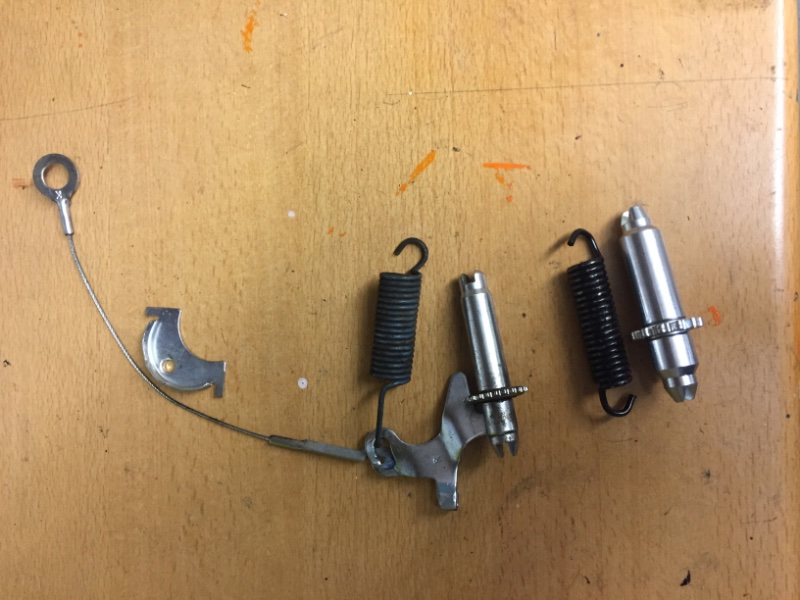

In case anybody cares, I swapped out the self adjusters for manual Today. I couldn't find a listing for my 10.5" brakes so ordered for 11". The adjusters were about 1/4" longer so shortened to suit. The manual adjusters have less teeth so that the spring sits between them to maintain adjustment. I also noticed the manual springs are much stiffer so should more positively retract the shoes, which by the way have no odd wear pattern. Won't be able to road test until the winter upgrades are finished.
