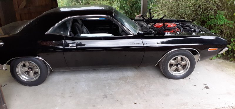

Looks like a great fit Mark :thumbright: 8-)
Posts: 14640
Re: 255/70/15s on an E body?
Nice one!
Cheers chaps and thanks for your advice blue.
Spot welded the old arch to the new and then sprayed couple a layers of lacquer over it to protect it.

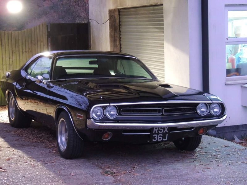

Would have liked big wheels / tyres like yours Pete, but didn't want to mess around with the suspension / leaf springs.
Still it's got some stance now.
Posts: 22241
Mark B wrote: Thu Jan 16, 20 12:09 pm Would have liked big wheels / tyres like yours Pete, but didn't want to mess around with the suspension / leaf springs.
A good decision.
You have no idea how many hours, Wheels and tyres for test, and general faffing around it took to get the Big tyres under the Arches with stock tubs and getting the car to sit at stock height.

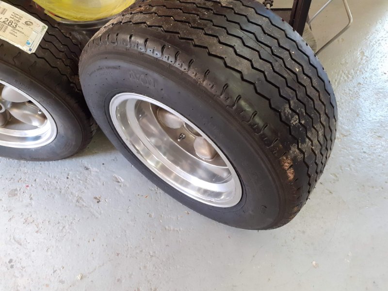

275x60x15 AVON CR6ZZ on rear before that 275x60x15 goodrich on mod was to move offset spring hangers and move front mounts inboard wheels are 15x10 A.R.E 's
