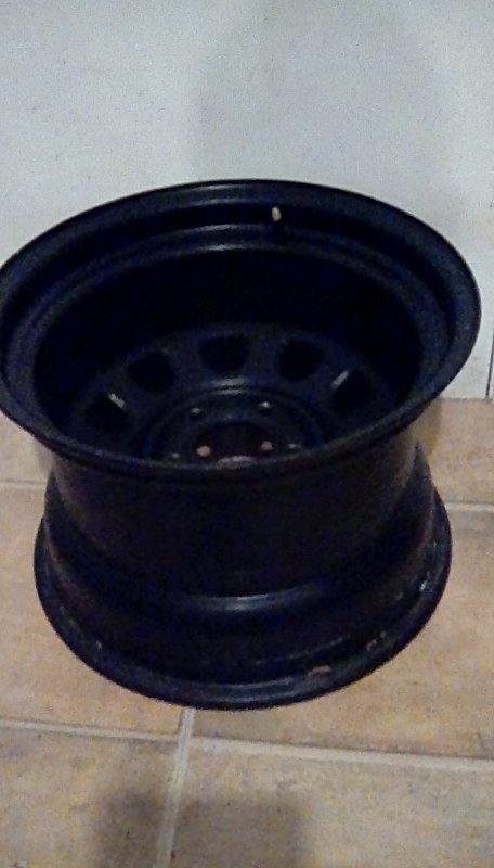

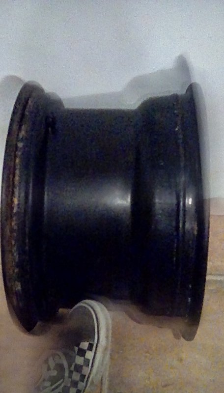

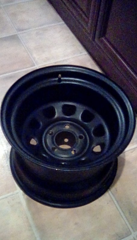

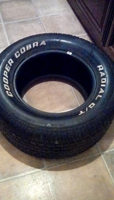

Thanks for the reply Pete, I've got a pair of 15" x 1 0" steels and 2 95/50/15 cooper cobra tyres , the wheels have a 4" backspace to drums. See scrappy pics enclosed mate, cheers Ian

It will be a_lot easier and cheaper to just buy the wheels, rather than a new/ narrowed rear axle. :thumbright:
As Pete says you can get the offset you want really, you could also consider having some wheels banded" using someone reputable "
The wheels you have a nice dish to them already. Do the wheels you have, have a size on them? or have you mesured them?

To TIB3300,THEY ARE STAMPED 15" X 1 0" mate, the trouble is I need the large 5 stud pattern axle , so would be easier to 're weld the spring perches and have a decent strong diff ...or re drill a 7.25 axle that fits my car...but may not be up to the job if I fit a decent powered motor ! I want a big block ideally ..so probably have answered my own reply kinda thing :D
