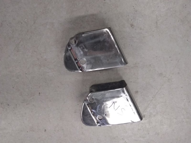

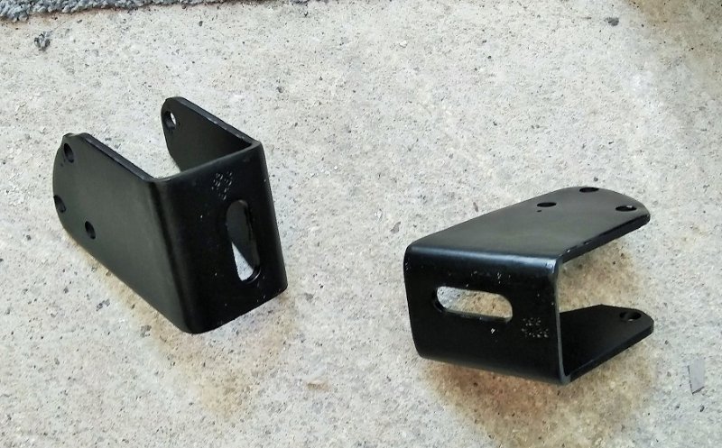

Been busy with a few things , Engine mounts first, as I have used the original V8 mounts had to exstend and put new holes in them.

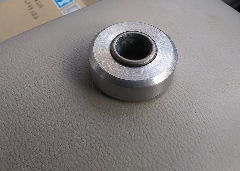

Made a bearing retainer, using the ford T5 bearing . Bit tricky getting the tolerances just rite to get a press fit.TIB3300 wrote: Thu Aug 13, 20 8:42 amThanks for the advice again DaveDave999 wrote: Tue Jun 25, 19 3:05 pm

But I have a problem![]()
I did as you said and bought the two spigot bearings, a Dodge Dekota and a 2000 Mustang spigot bearings.
The Dodge bearing retainer fits great,the problem is the mustang bearing is too small for the Dodge retainer.
Have I done something wrong?![]()
TiBBs

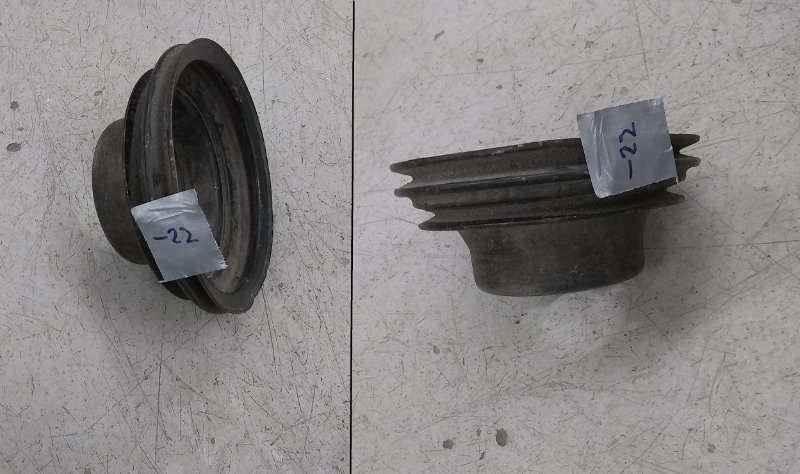

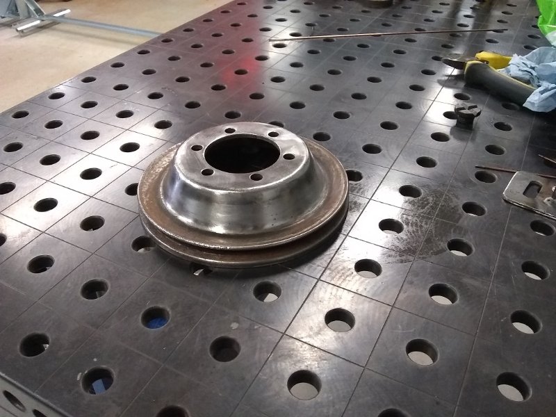

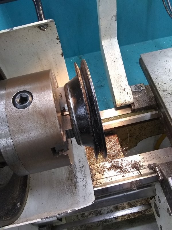

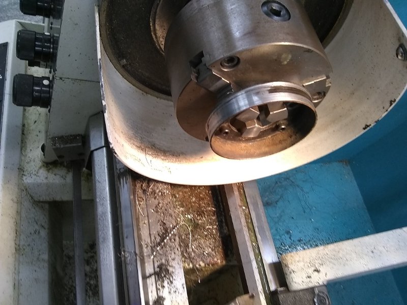

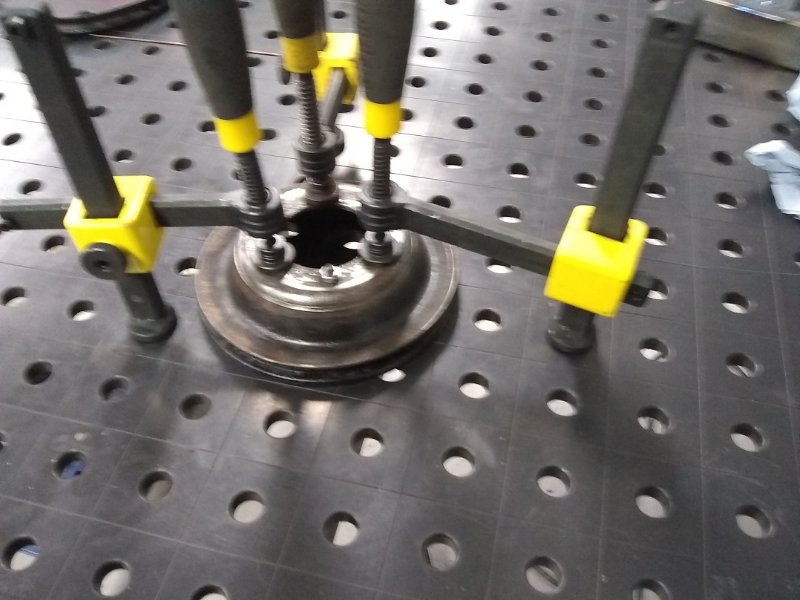

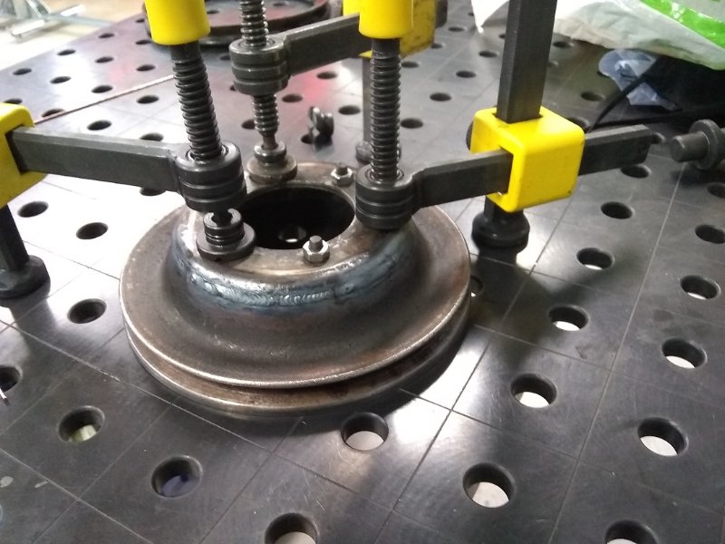

Decided to make my own pulleys, as I have a mish mash of parts, nothing lined up with the belt. So needed to make the crank pulley shallower by 22mm.

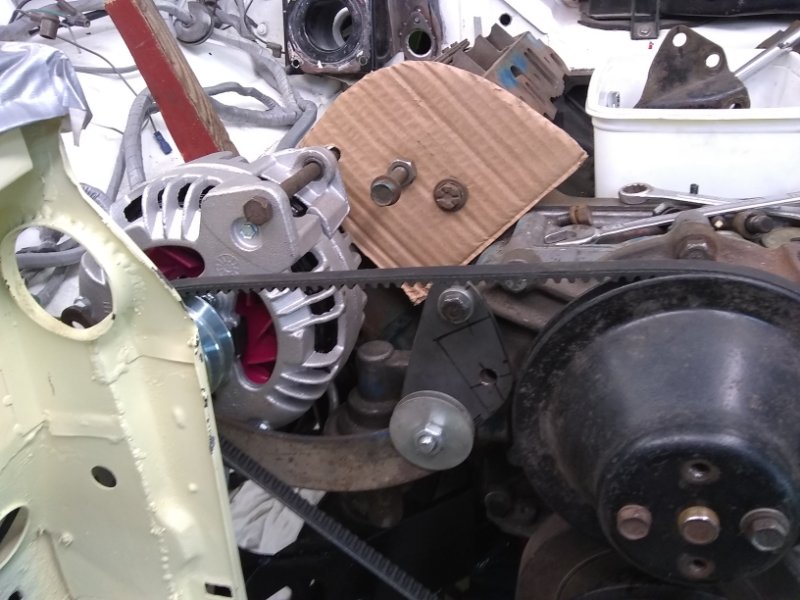

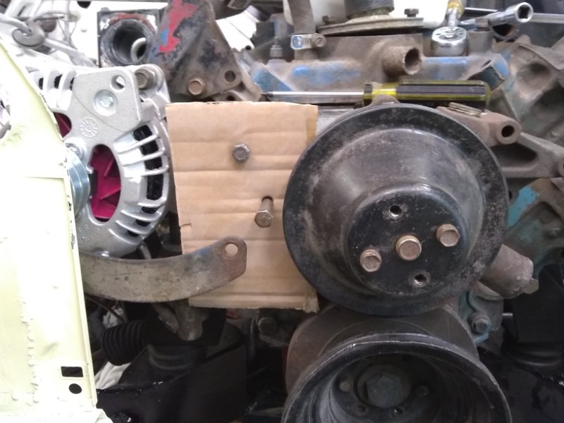

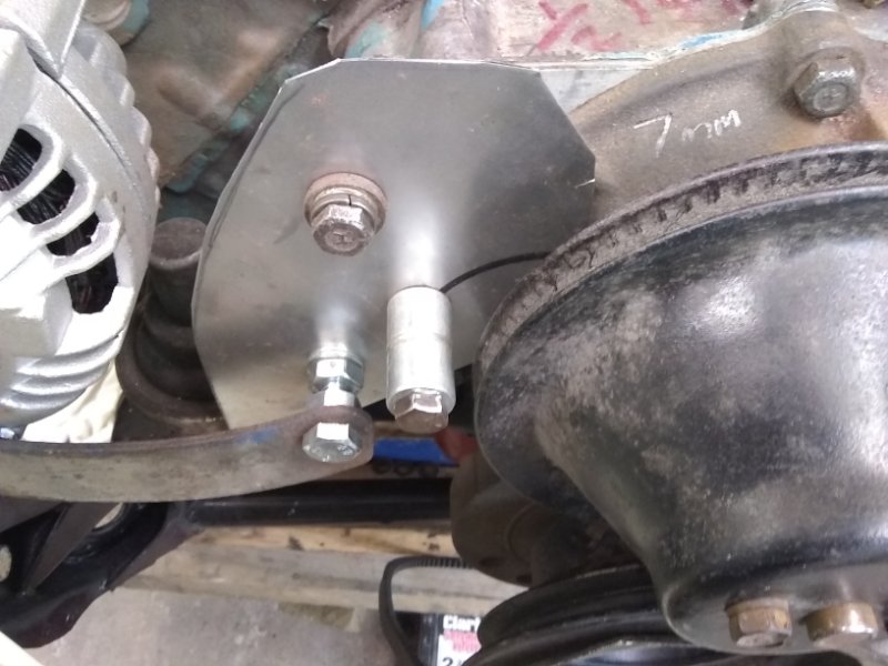

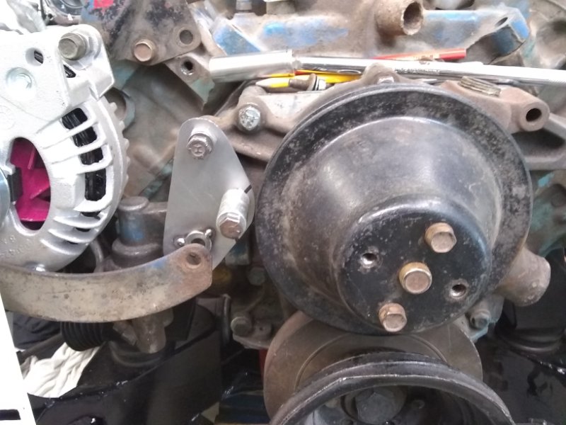

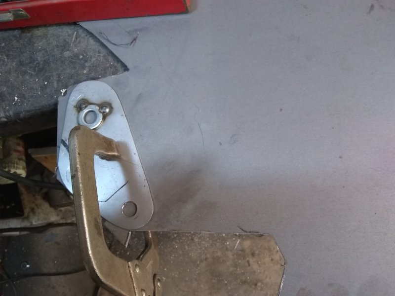

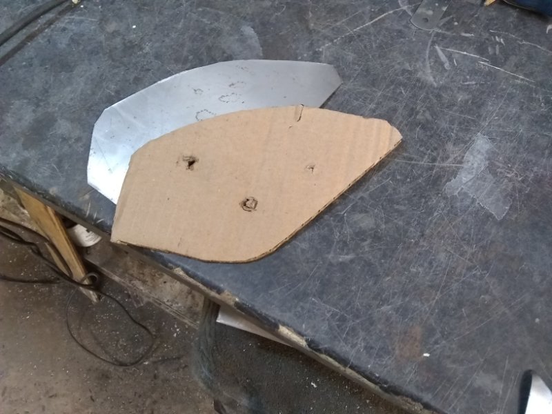

The next thing was the alternator brackets, as I have my top rad hose comming out where the alternator should be
Ive never made any before, so did a bit of thinking and came up with using the orginal slide and new mountings
ohh!! and C.A.D Cardboard aided design
First make it out of cardboard, them 1mm plate, nice and easy to cut with snips .Them the 4mm plate

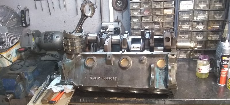

Well after the engine I got from the USA fell a part I decided to rebuild the Leeds bought engine.
With the patient on the table, I stripped and cleaned everything including a trip to the local jetwash with the sack
barrow. Crossing the road with a engine block on a sack barrow got some funny looks. " oh! You can pick up and carry these blocks, as I had to move it from one side of the garage to the other, but yep they are meaty.
I now know a lot more about these engines and I must say .I do quite like them, simple with a few quirky things.
Tuesday this week I started the engine up after the rebuild including' rings' new cam bearings' mains' and shells' sounded odd with a miss fire.
Then after 10mins a squeak/ rub noise, I thought it had picked up a on a main, very odd noise couldn't put my finger on it ??
So yesterday after thinking about from 4:30am I was back in the garage at 7:55am inlet manifold off again, sump off.after finding nothing, no shiny bits in the sump. I noticed that number 8 exhaust valve cam lobe had a rub, Ide had a problem with this lifter not turning, so changed the lifter again for another no still no turny!!!!!
Cleaned it, polished it, was lovely in the guide, but still no turny!!!! Sat looking at it for 10/15 mins trying figurer it out . 8ollox seen it, when I washed the rockers and the shaft I thought I had put everything back right,
BUT NO! I had put the last two rocker arms the wrong way round. Meaning that the push rod was rubbing on the head, this was the strange sound and stopping the hydrollic tappet from rotating
And once I put number 7 and 5 plug leads the right way round
sounds sweet now "HAPPY DAY'S
"EDIT" tonight
Well the noise is back at tickover, ran the engine at 2000rpm for 20 mins" WOW THAT THING GETS HOT! " sounds good though
I think its another lifter rubbing the cam,
