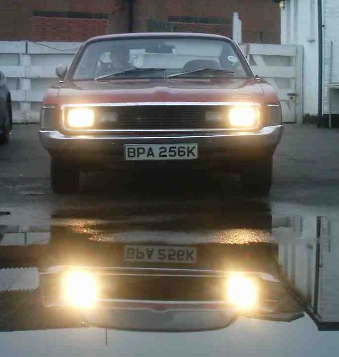

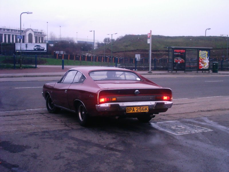

My records show WEU334L was originally RAN5L and I assisted in proving the age back in 2003 to get it registered as historic based on its VIN and being a VH Charger. I never actually saw the car but may have seen pictures. I seem to remember it being a restoration project in matt black, not a running car.
It was owned by a guy in Kent who also owned BPA256K which was a metallic bronze VH770 which was seen at the Ace Cafe in Jan 2004 but I think went back to Australia after that.
Ace Cafe Oz Day04 030.jpg (69.05 KiB) Viewed 14151 times
Ace Cafe Oz Day04 031.jpg (78.61 KiB) Viewed 14151 times
