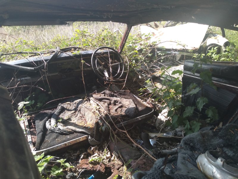

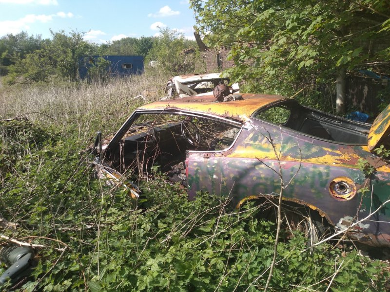

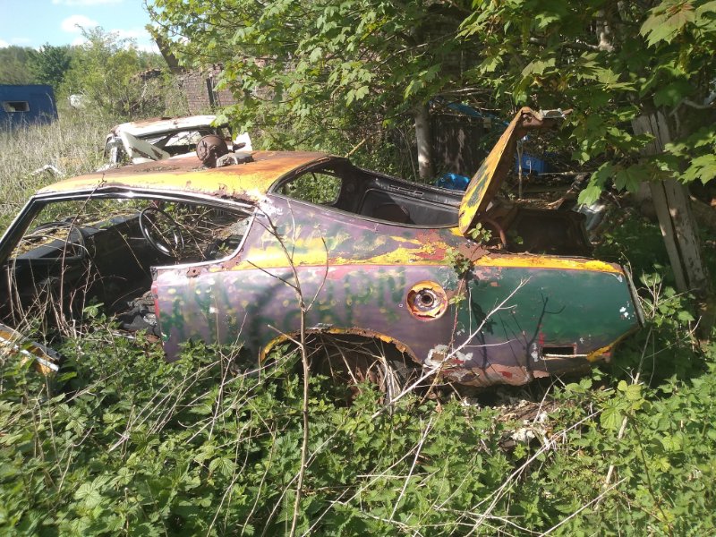

Did you not manage to get your hands on the rusty Barracuda Andy?
- Trigger_Andy
- Posts: 7867
- Joined: Sun Apr 18, 04 10:27 pm
- Location: Stavanger, Norway
Re: Rear Axles.
Ive not had a chance to go down yet. Seem to spend half my life in quarantine and its only getting worse now that Sturgeon's imposed an 11 day quarantine for everyone returning to the UK. Even if the country (like Norway) has a vastly lower number of infections.
Re: Rear Axles.
Ok. What year is it? If it’s a ‘68 I’m after some trim if there’s anything decent on it..
- Trigger_Andy
- Posts: 7867
Re: Rear Axles.
Ok cool.
I'll try and get now next time Im home. Think its a '69 though?
How it was and how it is now.
