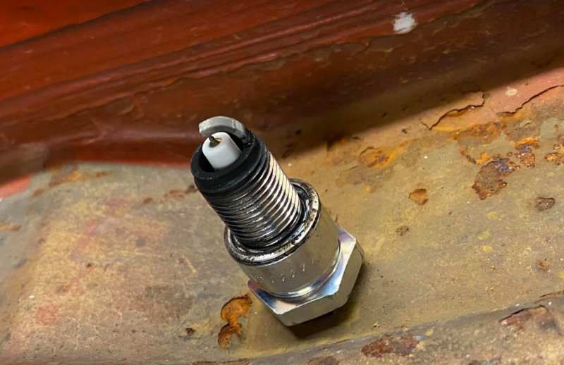

From what i have just read,my spark plugs say the timing is too high,idle circuit is too rich and the jets are too small.
I have a new roller chain to put on,so i will see what it runs like after its fitted.
Re: Does this engine sound right to you?
My two pennyworth,
Looking at that plug it is getting too hot, possibly due to timing or even weak fuel mix, IMO its only the fact its a quality plug that has held things together. Is the heat range correct? check if there is a coloured band around the base of the electrode insulator, if there is that would indicate heat range is close.
Try more fuel and less timing, something is going to melt if this is from a high speed plug chop, Maybe just a blocked jet but needs immediate attention.

The above does make sense as to why it will tolerate 44 degrees of timing, on modern fuel this is massive.
Try a compression check, that could tell you if its a low comp motor as clearly not burning oil so bores are good.
But honestly, do it now. My comments are from looking at plugs from a lot of engines and trust me, the next chapter in the story is not good!

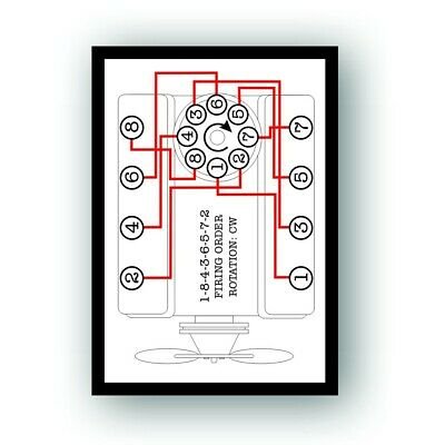

ok something not right.
are you sure you have your timing gun pickup on No.1 cylinder lead and the pickup has the arrow on it pointing to the plug.....
if not that could explain the huge initial timing
if you do have it on lead one
and lead one connects to cylinder 1
something is amiss
if you can start it with what appears to be 30* advance something is not set up correctly
i think you need to start again....
don't touch timing
set engine to 10BTDC on No.1 cylinder
this the the point when no.1 has both valves closed and the distributor rotor is pointing at least to the correct half of the distributor cap for no.1 cylinder.
adjust distributor round to that no.1 cylinder contact is directly above the rotor. draw a line on the body and cap to help align
then check that the leads, starting with no.1 put it in its position above the rotor and then connect up the rest in the right order.
see if it starts
then set timing.
if the vacuum can hits something leave timing as it is with Vacuum can hitting whatver it hit
do this process again you will probably find that you chose the wrong dizzy tower for no.1 and the dizzy needs turning back away from the thing it hit
adjust the wires by moving everything round 1 place and re set with no.1 over the rotor at TDC. again rota should point somewhere in the correct half of the dizzy for no.1 tower
reset the timing properly
HEI set up still uses a coil ? what make is it?

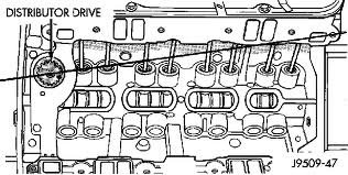

there is some kind of rule of thumb for this on a small block. i have never owned one so take this with a pinch of salt
as far as i know at TDC the distributor drive should be pointing at the drivers side headlamp....I think someone with 318 V8 experience necessary here to confirm,
see attached
think this is for or the drive under distributor, but that would get rotor pointing totally at n0.1 or totally away from no.1. if totally away, wind engine over to TDC from here, to both valves closed).
In theory it doesn't matter where the drive is but in this case to sort out the issue i think it best of this is checked.
back to the book settings is best when things are weird
something is amiss
don't touch timing
see if it starts
then set timing.
see attached
- firing order.jpg (21.51 KiB) Viewed 7671 times
- LA rotor.jpg (23.03 KiB) Viewed 7671 times

if all else fails do this to check TDC timing mark on balancer, as Dave B says the outer on the balancer could have slipped
get old spark plug (or safer buy a piston stop tool with the correct spark plug thread (or at least a set of adaptors)) either will do
spark plug method
smash out the middle and snap off the earth strap crack off the top so you are left with just the metal body
put bolt through plug so its end sticks out where the spark used to be made and secure it with a nylock
you want it 1/2 -1 inch longer than the plug used to be it needs to stop the piston reaching the top of the bore
https://www.ebay.co.uk/itm/333801863746 ... AfEALw_wcB
stop tool is safer
wind No1 to the bottom of its bore
fit your modified plug or tool
carefully wind engine forwards until you modified spark plug stops the piston
go to timing tab on timing cover. there is a hole in it use a centre punch to ding the balancer through the hole. make a precise mark that you can see easily draw a line near it with nail varnish or paint pen so you can find it easily again
wind the engine over backwards carefully
until no. 1 cylinder stops again i.e approach your modified plug from the other way
repeat the marking process on the balancer
Remove modified plug
wind engine over so you can stick your head under the front end and see both of your marks from below (this is why i suggest nail varnish or paint as well as the punch mark)
beneath is easier you are not climbing all over radiator and fan. on yer back looking up works, just 1 bolt on member between car front valance/radiator support and front of K frame to negotiate
stick a bit of masking tape on the balancer that covers a bit of circumference wider than both of the punch marks
use a craft knife to trim off the ends exactly in line with the punch marks. use a steel rule or something
you are left with a nice bit of tape which spans exactly the distance between the marks
carefully peal it off and stick it to a bit of normal office paper. smooth and flat
cut it out and fold it in half exactly to get something half the length between the two punch marks.
align one end of it with 1 punch mark, with the other end heading towards the other punch mark
the end of your folded tape indicates TDC...... mark your balancer HERE as 0 Degrees . set timing using this new mark
this caters at least for the time being, for a balancer who's outer ring has slipped, and therefore has incorrect timing marks. who knows when it will slip again
use the original factory marks to mark on your paper/tape the circumference distance in mm for 10 and 20 degrees
mark up 10 and 20 degree lines from you new TDC mark on the balancer
use yellow paint pen like those used in breakers yards or nail varnish, spray paint on the edge of a piece of card or old ruler also works dip it and use it to make a nice mark perpendicular to the timing cover, on the balancer
spark plug method
stop tool is safer
