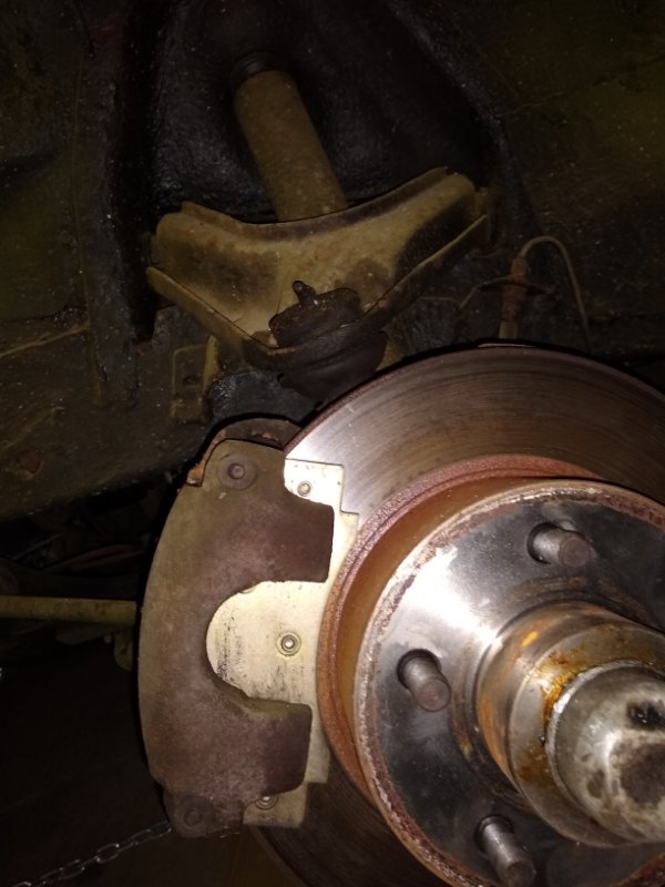

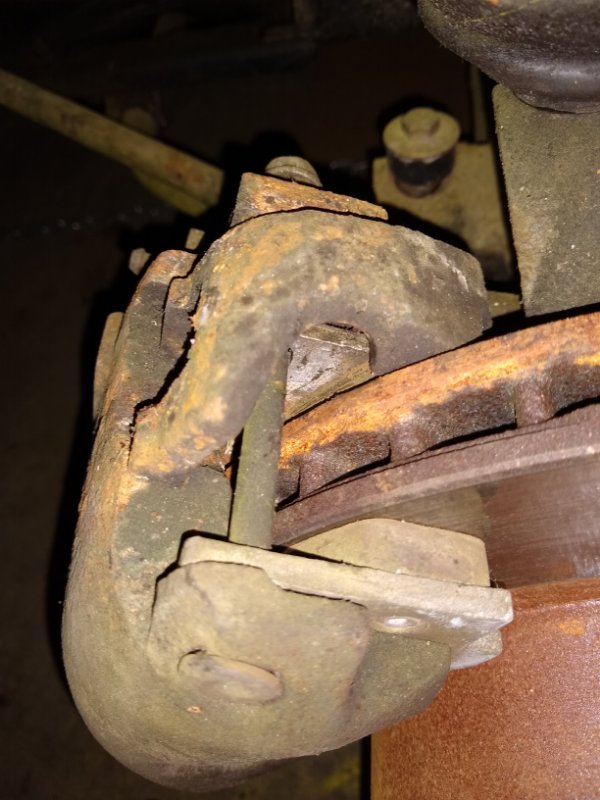

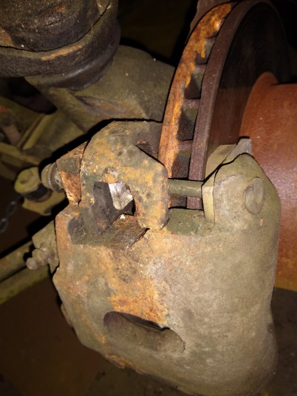

I found the part number on the back of the caliper, they are Kelsey-Hayes. Looking up the part number, which appears to be KH86166, I'm not sure they're correct for a '73 Challenger? I think they're supposed to have a retaining spring / clip as an anti-rattle device as you say, but it's not present, and I can't see where that would fit. It also seems to only act on the outer pads, whereas the 'loose' ones on mine are on the inside. They only move in a front-to-rear direction, not side-to-side (as you may be able to see in the youtube video), so not sure there's any problem with the piston / lack of shims etc in that direction. I might try putting copper grease on them anyway, to see if that helps.

Andy. Have you got the anti rattle springs on the pins that go through the pads.

I'm not sure exactly where they would fit, but no, I can't see any springs. I can see that springs are supplied with rebuild kits etc., but can't see where to buy them seperately, if that's what I need.
