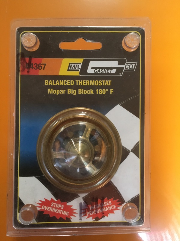

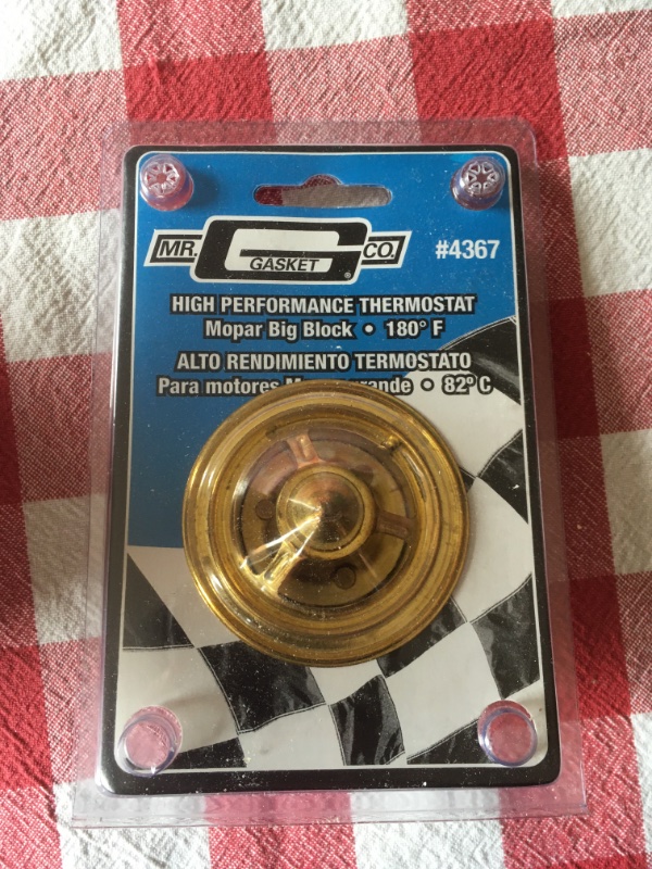

Probably a stupid question, but is there any difference big block / small block thermostats?
Just sorting out a for sale / take to the tip pile and found this in my stash that I didn’t even know I had

Balls. Just paid for one the other day that I waiting to be delivered.
Oh well, at least I have what I need. Thanks Blue.
No idea where the hell I picked that up and why, but will have a spare now.

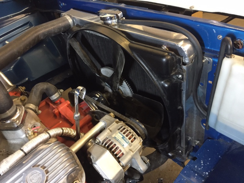

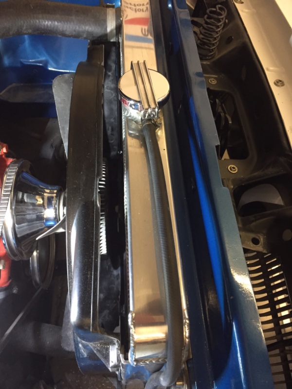

Redroduction fan shroud fitted, it bolts up to a 22" Champion rad with the minimum of trimming for hose clearance. What you do get though is a gap of about 1" or so at the top due to the thinner header tank, I'll deal with that in due course.

First thing - is your overheating at speed or idle? This could point to different problems and different solutions.
Second, that fan isn't doing much without a shroud, its too far away from the core to be drawing a lot of air. You definitely need a fan shroud, it makes a big difference.
Without a fan shroud you get inefficient airflow around the ends of the blades as high pressure air (behind the fan) naturally tries to find areas of low pressure air (in front of the fan). In short you end up recycling the air at the tips of the blades from behind the blade to in front of the blade, which reduces the amount being sucked through the core.
