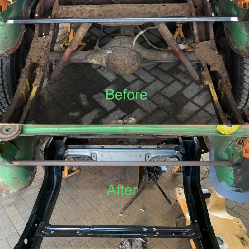

Adding these pics...
- D8F6D9B4-00EB-4210-A417-16BB8F326480.jpeg (226.76 KiB) Viewed 27311 times
- C3E738B2-50FF-48DC-A46A-C4F7E062C264.jpeg (128.42 KiB) Viewed 27311 times

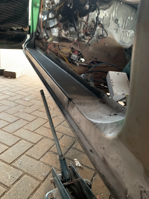

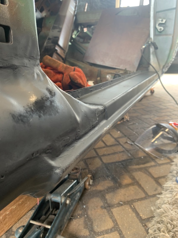

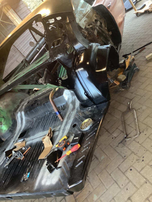

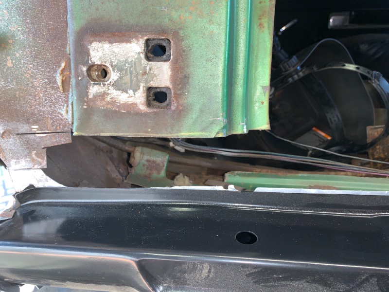

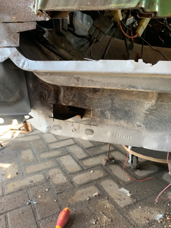

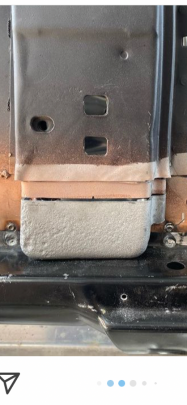

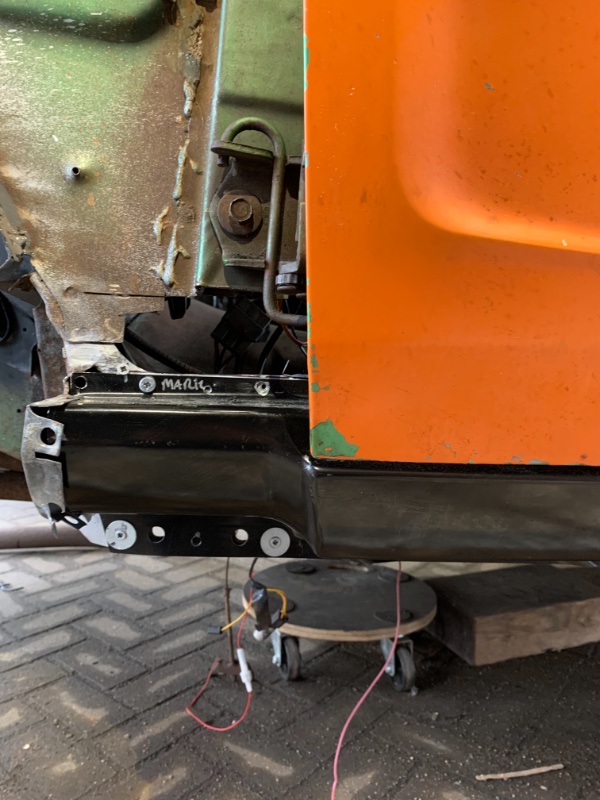

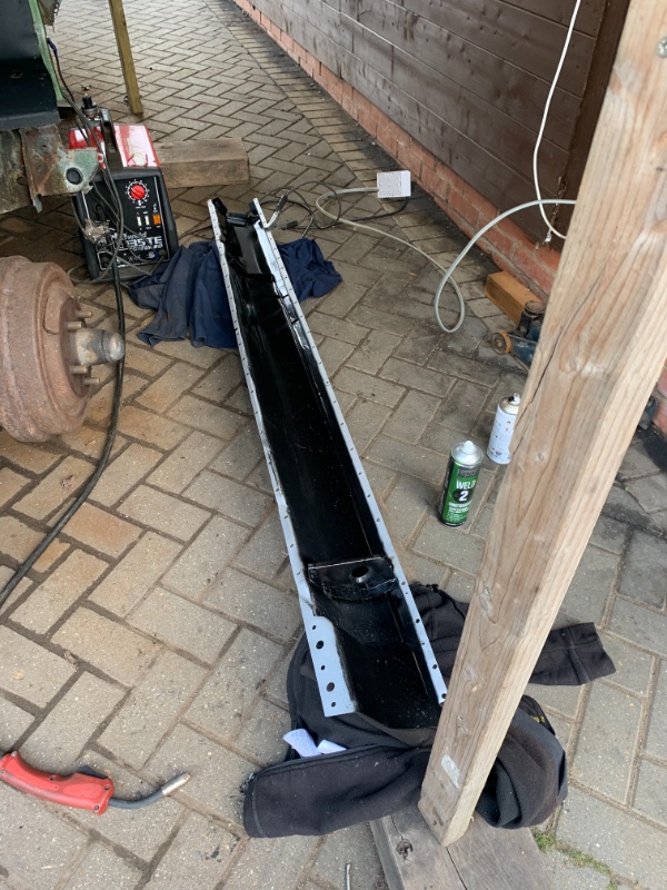

Next up was a big one.... and one I underestimated.
Rockers/sills! I figured, got to be straight forward. Quarters panels are removed at this point so access is straight forward. Drill out some spot welds, replace with new part. As long as I have pre measured it will be a doddle. Right? Wrong....
Iv got a bit of an issue, and whilst sometimes it serves me right, sometimes it becomes a pointless excercise. I must put this car together as closely as I possibly can to how the factory intended these cars to be constructed, otherwise I feel like Iv cheated. The problem with this mentality is two fold (in my opinion):
1. A restored car will always be a restored car. We can do a good, great, fantastic job but truth be told it will NEVER be like the day it left the factory. I am replicating spot welds with a mig welder, the parts I’m using are pattern parts made in Taiwan, I am not working off a jig, I do not have the tooling that Chrysler have... the list goes on and on.
2. In this attempt, I create more work for myself in many circumstances to really achieve the same result.
Anyhow, it’s almost an ocd so it will just be this way.
From factory, the rocker panel lip sit UNDER the window regulator sheet metal bracket. When I see people replace rockers, it seems most people sit the rocker OVER the window regulator bracket. I felt this was not right. I am not starting a debate, I understand why people do it because having just done it the other way, it was a pig of a job.
You have to get under the spot welds of the rocker, to access the spot welds of the 1mm sheet metal to gently, without distorting any of the metal to get to the inner rocker to weld to... This is tricky to explain! Iv included a sample pic of the rocker OVER the window sheet metal (not mine, found on web, Hope it’s okay to post) Throw in the anxiety of “I hope I didn’t cock up the measuring” and I hope the door lines up right... it was a pretty nerve racking experience. I’m happy it’s done with!
Also there was a small patch I needed to weld in on the front inner rocker. That’s all that was rotted o the inner rocker, so I did not feel the need to swap the whole part, it was a relatively small patch and I felt changing the part out just for that was excessive.
Also the lower part of the driver side door hinge section was a little rotten so as pictured, some repair work was carried out.
I prepped the inside of the rockers with POR15 and weld primed all the necessary areas. Hopefully they will last the test of time!
This was all carried out over a month ago now and I’m posting the best pics I have. My pics will get better as the posts continue as I now have the thread in mind...
If I'm honest I found the rockers harder than the frame rails. But I got it done in the end and I’m happy with the result. Before and after pics added.
Thanks for reading! More tomorrow if you guys haven’t had enough of me already.

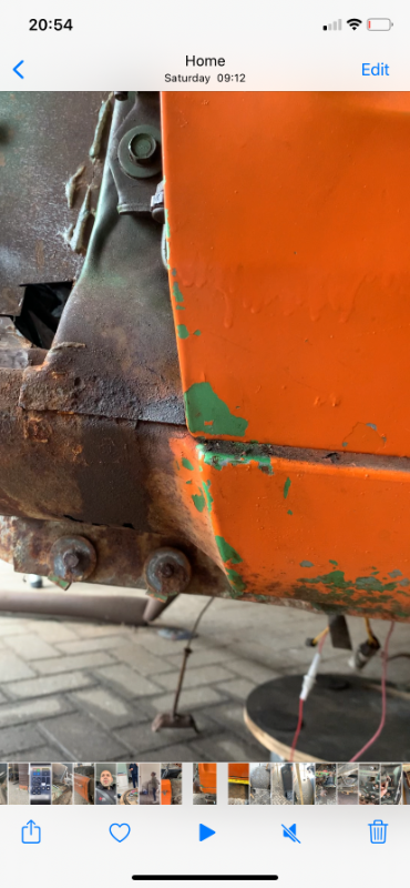

I’m not sure why my pics are coming up rotated. Any tips to avoid this happening are welcome!
Chargingatchya
- Posts: 106
- Joined: Tue Jul 21, 20 6:55 pm
Re: Restoration thread 1969 St Albans charger

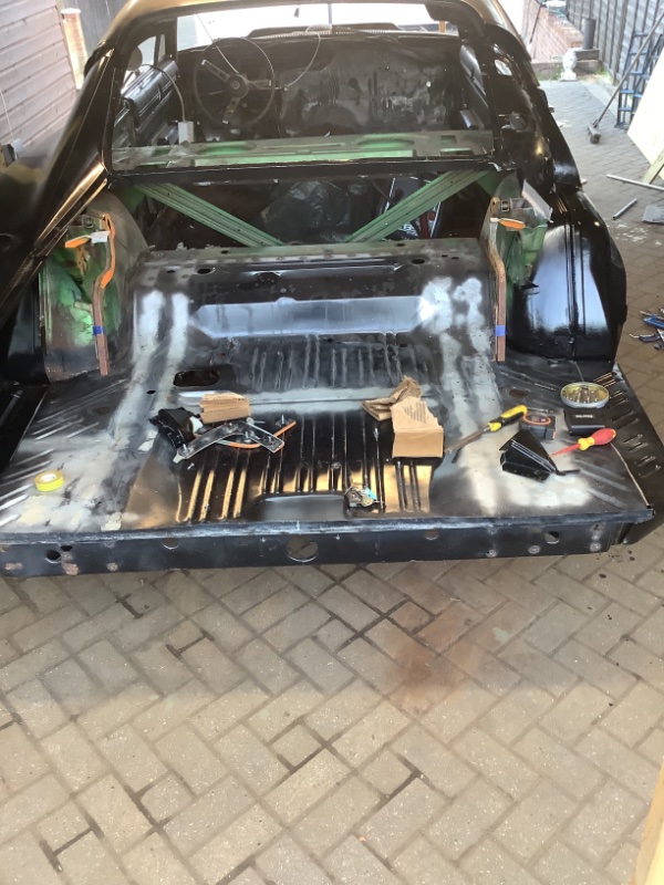

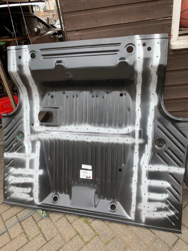

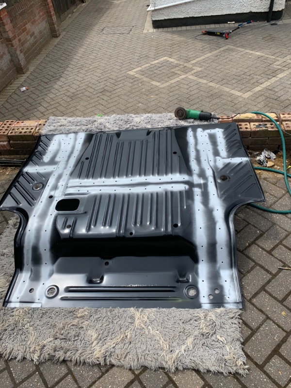

Ooops! Picture number 6 is not my work, that was added by accident. But I did have to do the exact same thing. But am not attempting to take credit for that picture!

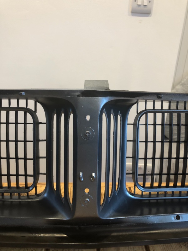

Top work on the Grille too if I may say so. They are tricky bits as the plastic was never designed to be 52 years old; they get brittle. I've got a couple of 'loose at one end' fins, but you have to look close. It used to be the one part you couldnt get but I am pretty sure I have seem repro now if it gets real bad.

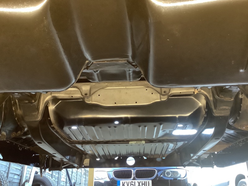

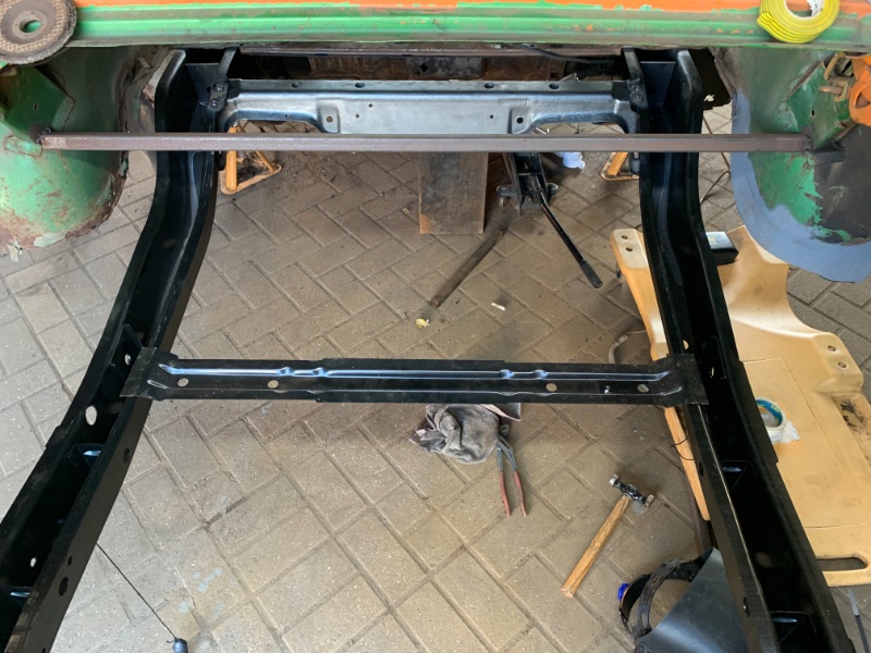

There is much around this going on that I’m not putting in to the thread. For example, cleaning the metal and rust protection, little patches here and there, hammer and dolly work, level and measuring (hours and hours on this particular part) etc etc.
Till now, I have not needed to soda blast as every rusty part has been torn out and thrown away! There really wasn’t much to blast! After all the metal work is done before she goes for paint (I’m hoping early next year) I may get certain parts blasted if I’m concerned. I have however been getting smaller parts that I have re used blasted. I’m quite lucky here as I have a good friend who blasts them for me whenever I need parts done such as little parts that are scaling or surface rusting I can re use.

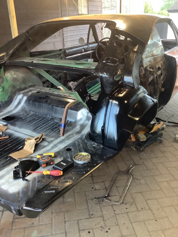

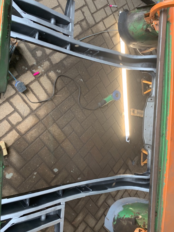

Next up.... trunk floor.
It’s seems the right thing to do as the frame rails are in, rockers are installed and the quarters are off so easy access all around.
A full trunk floor is the way to go as it will slide right in...
I’m sure the you guys don’t need to hear from a newbie how a trunk floor goes in, I’m a very small man amongst the geniuses and Mopar enthusiasts on this page so I really don’t want to come across like I have something to teach!
Any how, the typical procedure, prep frame rails for welding, drill holes for welding, align and make sure trunk pan fits and weld down! The part from AMD was honestly a perfect fit- which ultimately meant my frame rails were in the right place so that gave me faith in my work so far. I should say that there were a lot more spot welds in that pan than what’s in the pic, I hadn’t finished when I took that shot.
I have to be honest, as much as I’m enjoying this, I am nervous about every part I install. Is it meant to be like this?!
I spend much of my spare time and watching videos. The junkerup channel on YouTube has been fantastic as has some of the local guys on this forum (John Castleman comes to mind) who I have seen clips and bits on YouTube really have unknowingly helped this build.
I get a huge kick out of seeing the underneath looking like new. I have posted some before and after pics so you can compare how she’s progressing and il post more everyday till you guys are sick of me and the thread is up to date with where I am now in real time!
Enjoy!
