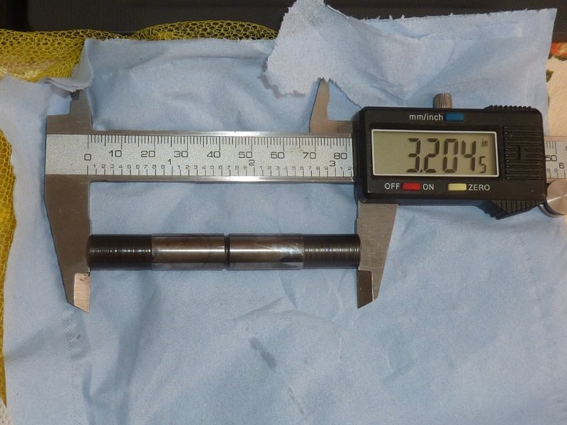

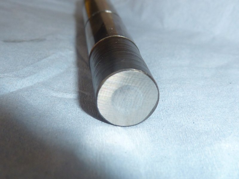

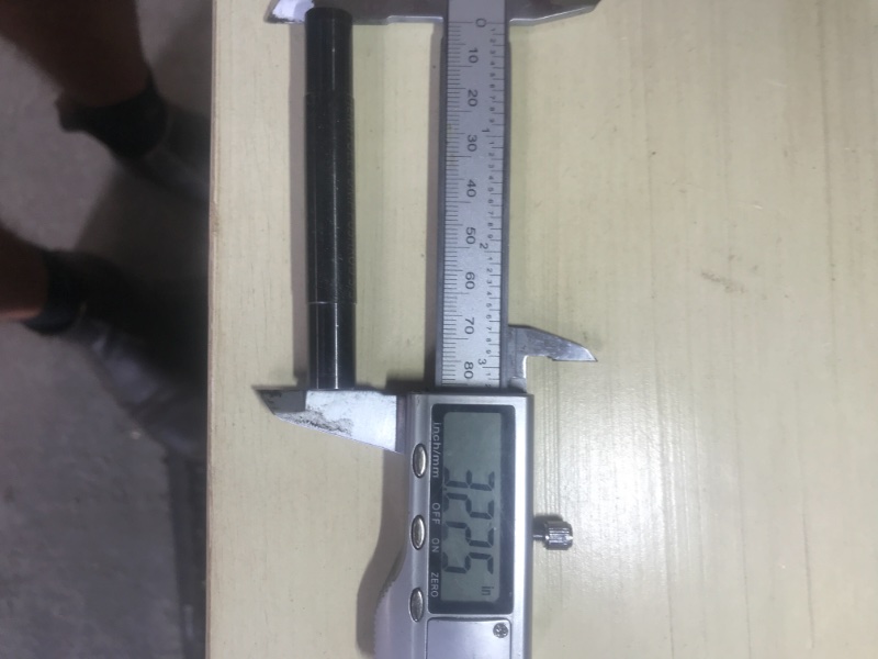

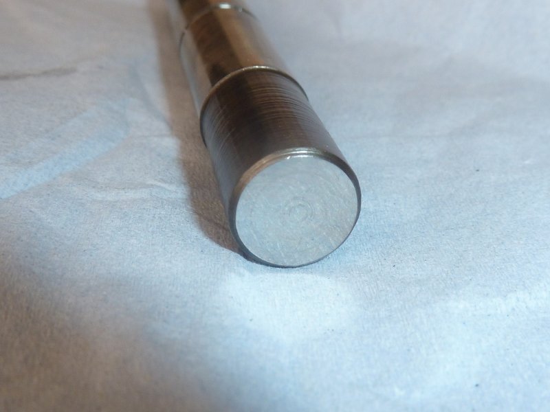

Pushrod end felt fine when in situ but thought it best to measure seeing as the pump's out. It measures 3.204" long. There's a small witness at the lever end on the centre but the cam end looks fine. Doesn't feel at all concave.
Q : I've seen different lengths quotes on 'net as to what the rod should measure. Some 'experts' on Moparts etc say 3.250" but the Hughes engines #HUG 10010 states 3.200 nominal. So can i rule out the pushrod as well?
I wouldn't have thought 50 thou wear would result in NO fuel being pumped?

- overall length

- lever end
- P1250893.JPG (64.96 KiB) Viewed 3982 times
- cam end
- P1250894.JPG (64.79 KiB) Viewed 3982 times

Regarding the pushrod, the machined area at each end starts off the same length and usually only wears one end away so visually you can normally see straight away if it’s ok or not.

appened to me a few weeks ago rod was worn have new spare one will measure it tomorrow and tell u length also check hoses between tank and pump in case split as might be sucking air as it wont show a leak if ful tank is low

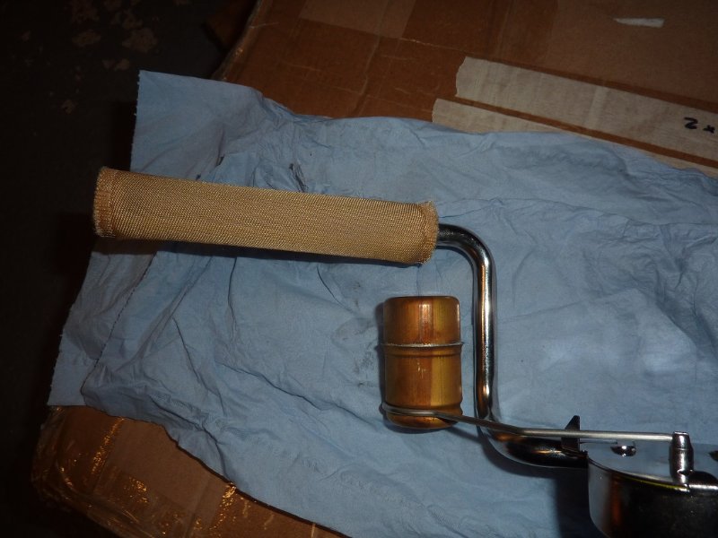

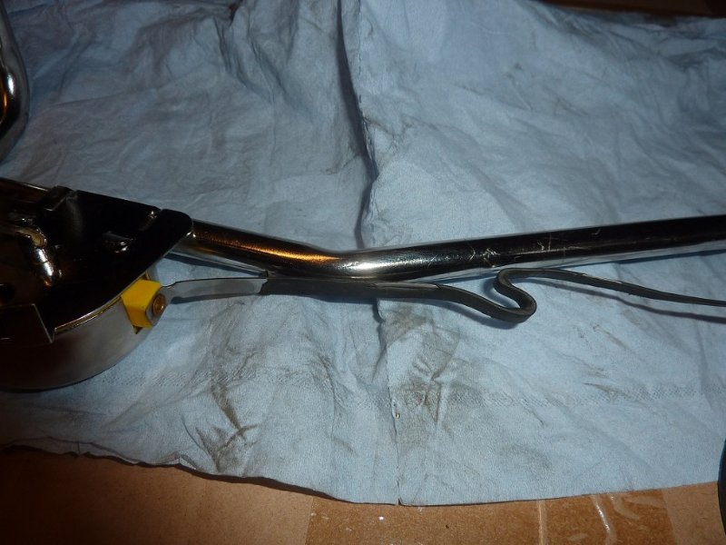

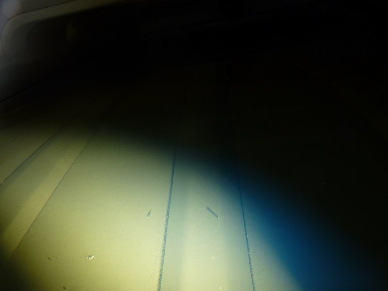

Carried on stripping out, got the sender out and looks pretty ok to me.
see pics below.
Sock filter looks clear, I've blown some air through it, and the return pipe. Blows through ok with not obvious blockages.
Strange black rubber sleeving seems to be deteriorating from fuel contamination. Is it just supposed to isolate the arm electrically from the inside of the tank?
Also stuck the air line up the fuel feed hard line and put the pump feed end into a bottle. It blew some fuel through maybe 50-100ml.
Return line was clear with no fuel in it.
Poor pic of inside of tank shows maybe a couple of bits of debris which may be flakes of paint from where the tank was painted before installation. I noticed that the paint was melted on the mounting face under the rubber gasket. That area should have been masked off.

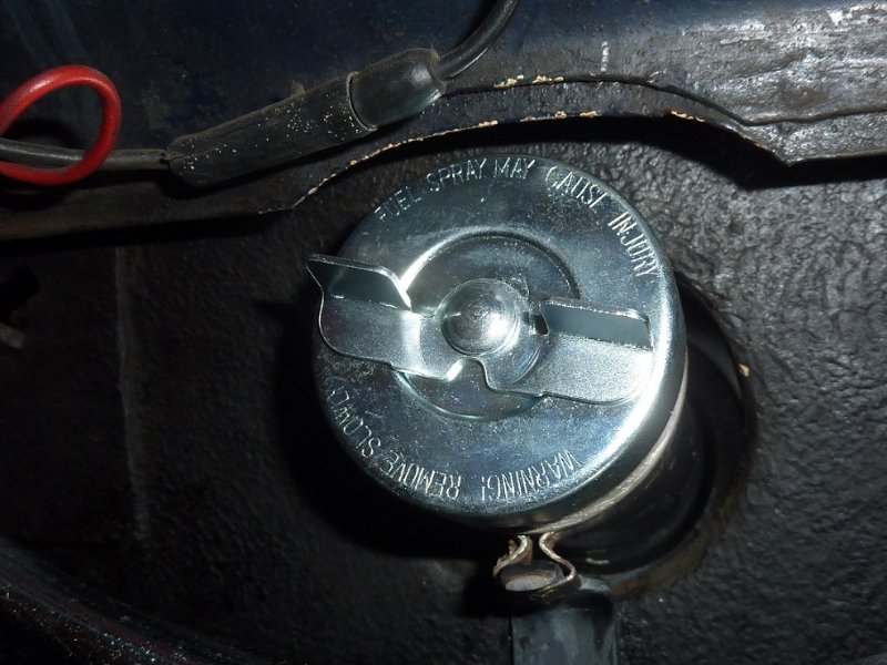

So I'm inclined to think maybe it was some kind of vapour issue due to heat. But not really encountered it before so unsure how to prevent it? The tank is vented with what looks like the original 2 pipes (not blown them through though). Gas cap doesn't have a vent hole as far as I can see. (pic below)
It was quite difficult to remove when adding the extra gallon so maybe was being sucked closed. But it can be hard to remove sometimes if over tightened. Didn't noticed any 'pffft' when opened though Dave.

Thanks Mr M, would be good to know the length of a new pushrod. And what make it is.
I measured the 2 (non) machined ends, they are within 0.025" of each other. Pump end is the slightly shorter end, but I can't see that it has reduced in length as the only wear mark is a small circle in the middle?
- sock
- P1250896.JPG (83.35 KiB) Viewed 3945 times
- rubber sleeving?
- P1250897.JPG (94.97 KiB) Viewed 3945 times

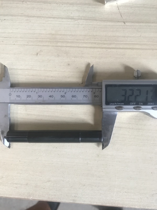

heres pic of new one and length with pt no
- 5C44222E-4253-420A-B85D-04BBE52A19F7.jpeg (115.32 KiB) Viewed 3928 times
- FF7483AF-7EEC-4176-91A5-F8C113F7B5A4.jpeg (97.4 KiB) Viewed 3928 times
- 25720B96-ECEB-4707-BF0B-A9B21F4A4756.jpeg (130.53 KiB) Viewed 3928 times

Thank you sir,
So that's 0.020" (0.5mm in new money) longer than mine.

How's best to avoid it in the future? would a strategically placed hole in the gas cap help?
