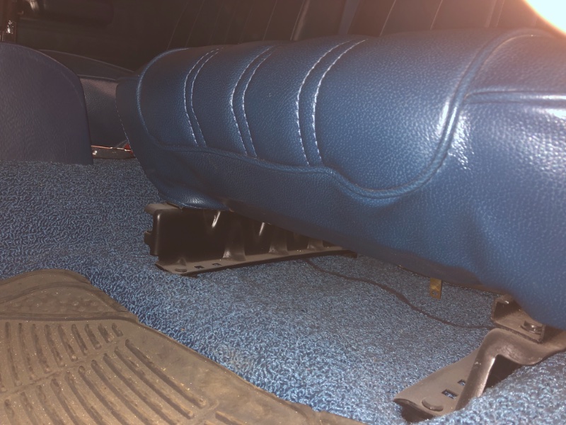

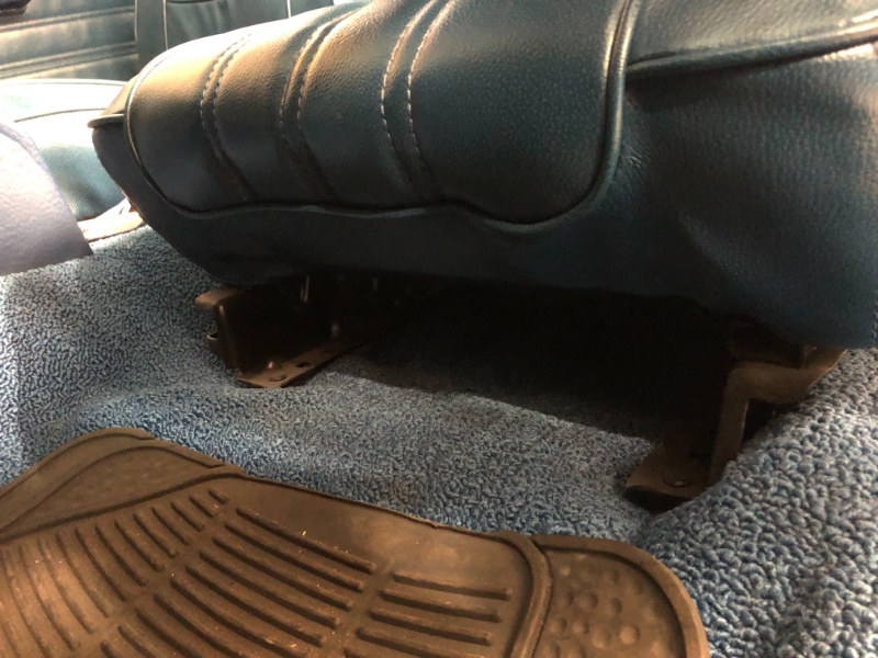

Re: Bench to Buckets.....
Here you go, mounts inside the hump.
- 1270EFEE-D272-4BCF-B8DD-7EE8E5882341.jpeg (176.17 KiB) Viewed 2980 times
- B52102D0-292C-48FD-AD0C-8352FA2BEC06.jpeg (181.25 KiB) Viewed 2980 times

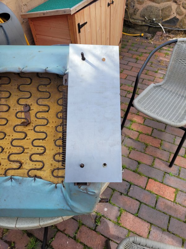

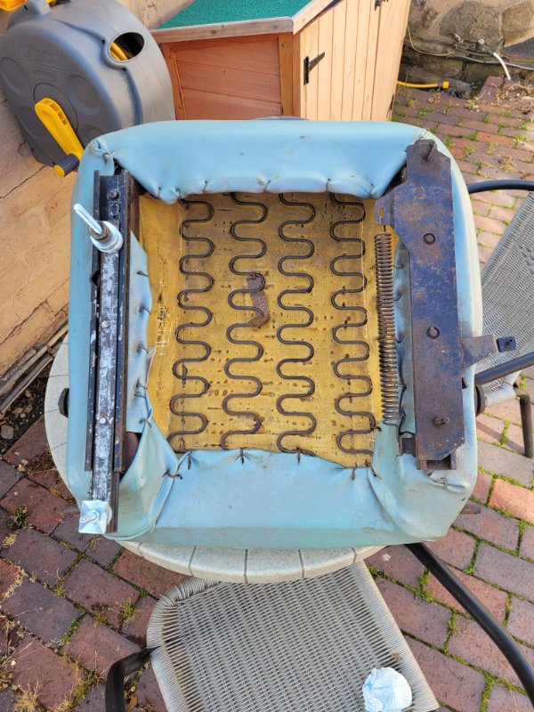

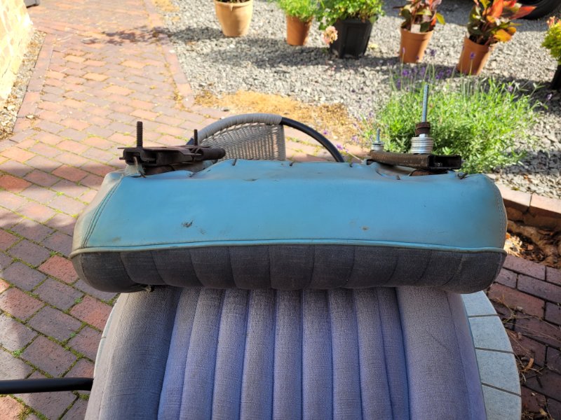

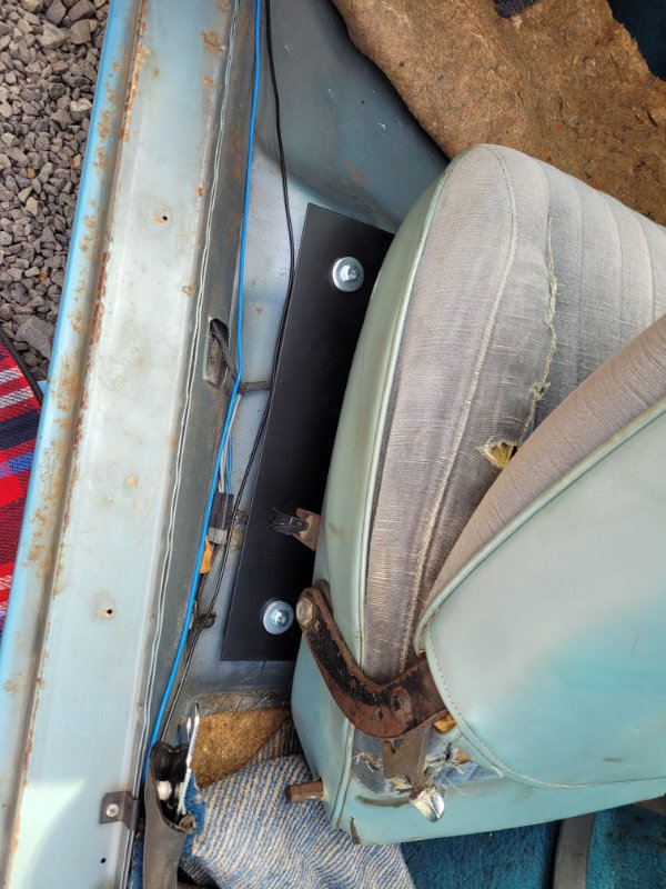

I spotted the factory dimples today for the buckets....I needed the Z bar, which I haven't got.
So ordered a lot of steel plate in various measured sizes and set about relocating the seat 60mm towards the transmission tunnel.
- 20210911_113436.jpg (200.78 KiB) Viewed 2954 times
- 20210911_113447.jpg (180.37 KiB) Viewed 2954 times
- 20210911_124609.jpg (159.96 KiB) Viewed 2954 times
- 20210911_143031.jpg (148.18 KiB) Viewed 2954 times
Went for a test drive.....much better albeit a bit lower than when i had the bench. Feels good though. Will do the passenger side when I can be bothered, it only the two strengthening plates to do on that.
