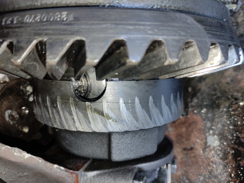

Well I finally got round to taking the pumpkin out,and LSD looks wrecked,like it's slipped round in its case.
How this has happened is a mystery cos it has a 318 in it,but then again the boot lid is covered in racing and parts stickers from the 80s and 90s.
It will be on its way to Hauser next week to see what the damage is.
Knowing my luck,every component will need replacing.

You could be lucky.. Geoff has plenty of recon stuff at his place if its really cream crackered

Re: Axle rebuild
pinion bearings
bits been moving about
crush sleeve crushed too far (if it uses one) or not shimmed properly or the yoke nut came loose or somone did a seal swap but didn't pay due care and attention to do the nut up properly.
if teeth not all chipped in the contact areas of ring gear and pinion you might be ok.... might need new pinon beraings (crush sleeve or shims and a set up)
i'm no expert but what i see is pinion tooth marks on your centre. when drive applied pinion head has dipped down or riden up, and ground into the bit you can see.
Also can't understand how the hole in the cntre for the cross pin seems misaligned but i have never had one like that in bits..... that bit might be normal, but just a bit damaged by the pinion, a movable part to keep the pin in place...?? on my spicer axle the cross shafts are dowelled into th case hemisphere, not sure about yours, i'm sure geoff or anyone with this diff will know.

Thanks Dave,like you say Geoff at Hauser will know what's what,i'll report back with his findings,see how close you were in your diagnosis.
