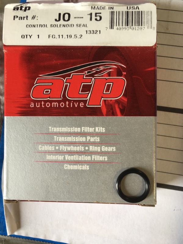

Posts: 7205
Re: Transmission leaks
Aaaaaaarrgghh!!!
Just checked the delivery and the wrong fricking parts again!! :banghead:
No O ring, just this teeny little thing along with the pinion seal...
Doing my head in now. :angryfire:
Note to self, check delivery off line by line. Another lost day.

Posts: 7205
Anyone know the correct OD/ID of the o ring in question? No joy finding one in the UK and need it for Saturday, so going to have to try and source from a local supplier and hope I can find something that fits. It’s the one circled in the pic. No joy on wanted thread.
2001 Dodge Ram Van

Posts: 7205
All good thanks, chaps, I’ve since picked one up from Flea Bay and fitted it a while back, stopped the leak that the metric equivalent had. 👍
