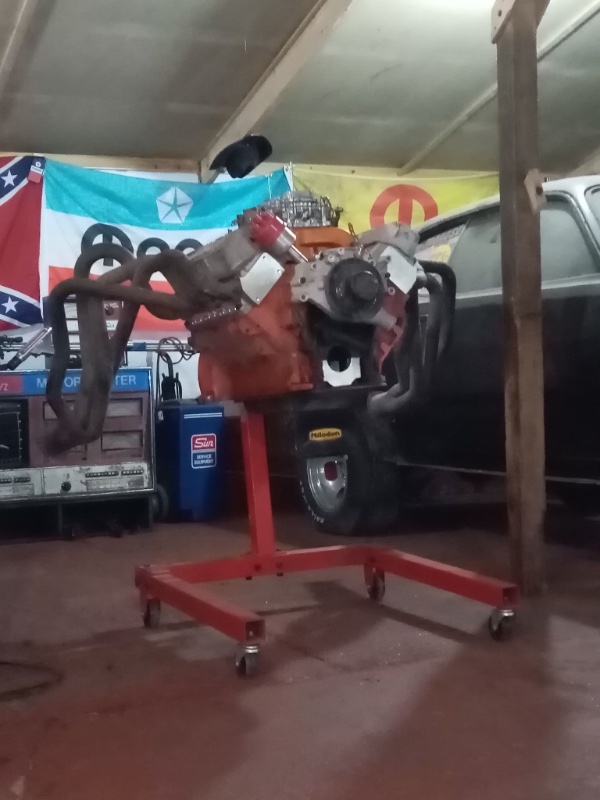

He's not short of space...
- 121187352_335029094418700_4401834743244719259_n.jpg (107.6 KiB) Viewed 2358 times
