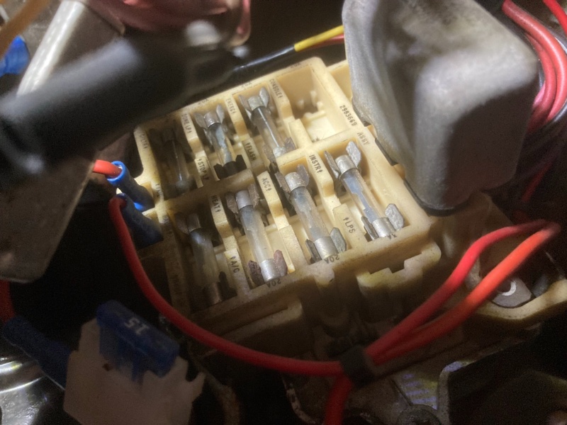

Assuming top right is the instrument cluster, fuse is intact.

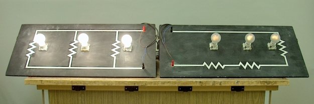

you need to connect in parrallel so from each guage bulb connect 1 wire to you new feed wire
and either the body of the gauge (metal push fit bulb holders) or if you have 2 wire bulb holders (usually plastic with no metal contact on the push fit surround) the other wire is connected to the car body
if you connect in serial i.e + wire for guage 1 to guage 2 guage 2 to guage 3 and the guage 3's + wire to the new wire the 3 gauge lights will glow at 1/3rd brightness as each will be operating at only 4 Volts. 3 gauge bulbs x 4 volts= 12 volts in total.
you want all 3 to see 12 volts so they each need a wire going to your new feed wire, which brings 12 volts from the dimmer or light switch.
in the picture below the red connector in each is 12 volts and the black one is the car body
left picture the end of each bulb on the red connector side see's 12volts
on the right picture all 3 have 12 volts spread eaqually across them and as the bulbs are all the same its 4 volts across each hence 1/3rd brightness

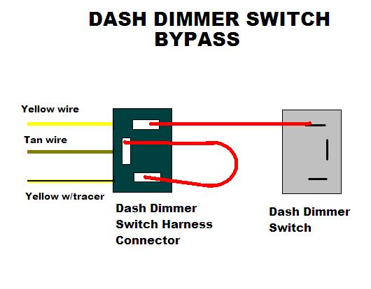

if you want to just not have a dimmer
try below. just link two sections on the connector that hopefully you find lying in the bottom of the dash
dash lights will be full on. when lights are on from now on....
and miss off connection to dimmer switch.
can't think it does anything other than activate dome when wound to 1 end...
instead of taking it to you none exsitant dimmer take it to a standard 2 conector switch with the other switch connector connected to earth i.e its mounting
i belive earthing this cable via a switch will switch on the dome light
hence you keep the ability swich off and on dome light when you need to read a map, on a dark night and have not got your phone
all you will then be lacking is the ability to set dome light to an "atmospheric level" when entertaining

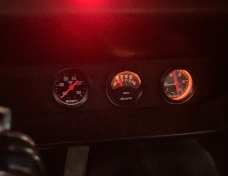

After a real Bananarama! of a week, I needed a bit of success, so pleased to say that after another morning of lying upside down on my neck, we have success. A gentle glow from the gauges and voltmeter now working.
