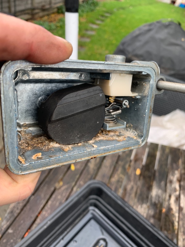

Didn't get a chance to do a compression test today and probably won't get a chance to look at it until the weekend now. I'll pop the valve cover off on the odd numbered bank of cylinders and check the opening/closing of valves.
If I cant get it fixed myself this weekend I think I'll have to throw in the towel and get someone with a bit more knowledge than me, to cast an expert eye over it.

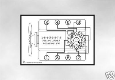

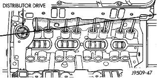

ah ok
you need to set it up thus dizzy drive section pointing at that far stud on no.1
and the leads in the correct position on the cap
in this position you are looking to see both valves closed on no.1
and the rotor arem pointing to no.1 tower on dizzy cap
4 stroke so TDC mark on balancer aligns with the marker on timing cover tab twice per cylce but only one of them is the firing point with both valves closed. the other is the top of the exhaust stroke pointless slinging in a spark then.....
