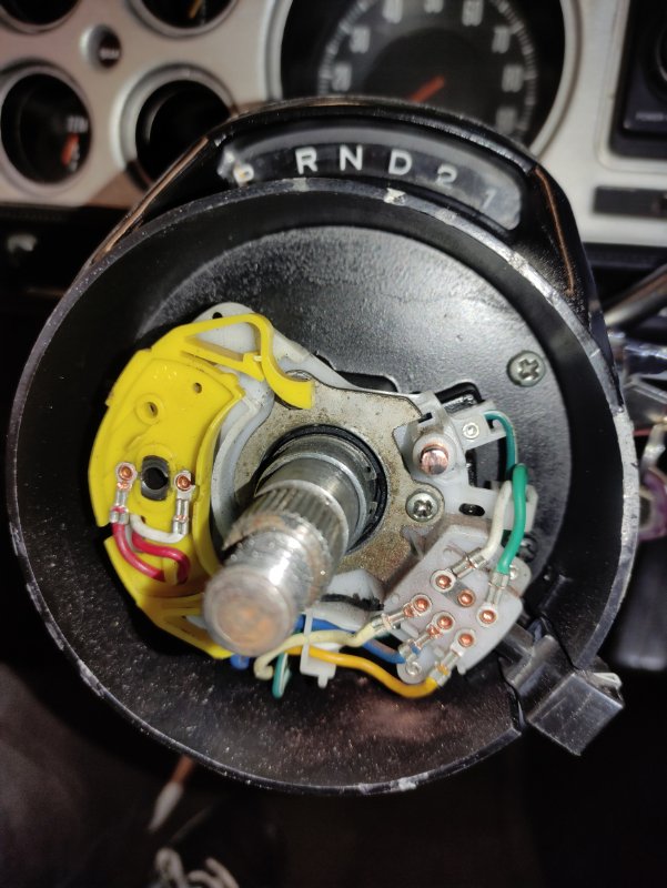

Hello,yes,I deffo have the 8 wire one ![Image]()
- IMG_20211123_125442.jpg (94.98 KiB) Viewed 4640 times

I can tell you from experience the quality of replacement switches is really poor. I had one that kept jamming, another that was so stiff I thought it would break everytime I used it and my current one which I have to waggle about to turn the indicators off. None of them would self cancel. I have read in several places Danial Stern lighting make a decent one http://www.danielsternlighting.com/prod ... s.html#Buy so I’ll try that next.

Hello fellas and thanks for answering.I ordered that switch from summit and it arrived today,fitted it and everything is working mint.It doesnt have the "feel of quality" of the original switch,but it seems to be working fine.
Miles,thank you for explaining how the circuits work,it was actually very interesting,i was racking me brains over it for ages and that cleared up things for me.
