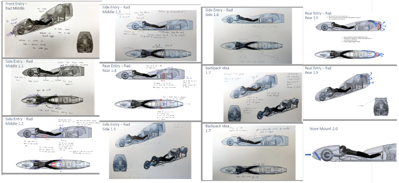

Re: Fifty shades of Jade
Lots and lots of options all with pro and cons
Drag reduction and complexity cost being the big ones for us

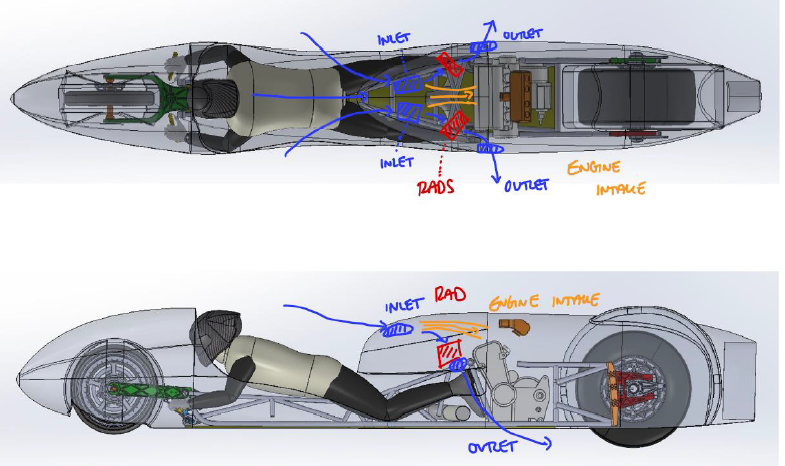

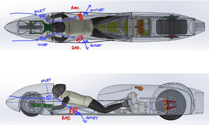

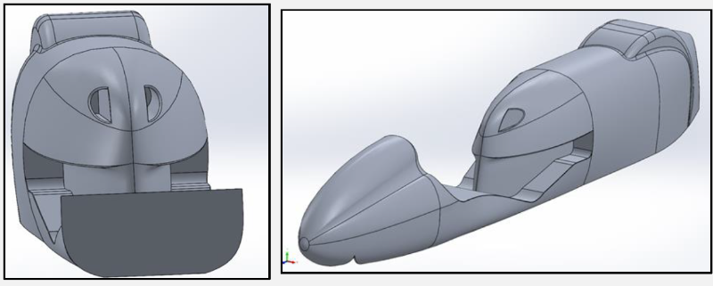

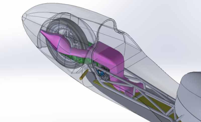

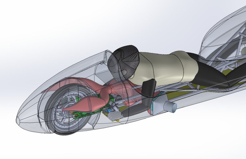

Decided that the best approach would be to have naca ducts built into the front nose cone then duct the air into 2x radiators left and right of the rider.
(https://en.wikipedia.org/wiki/NACA_duct)
:read2: :thumbright: :read2:
:-k

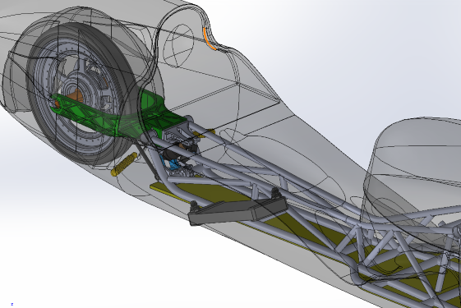

2x RADs something like this
:-k

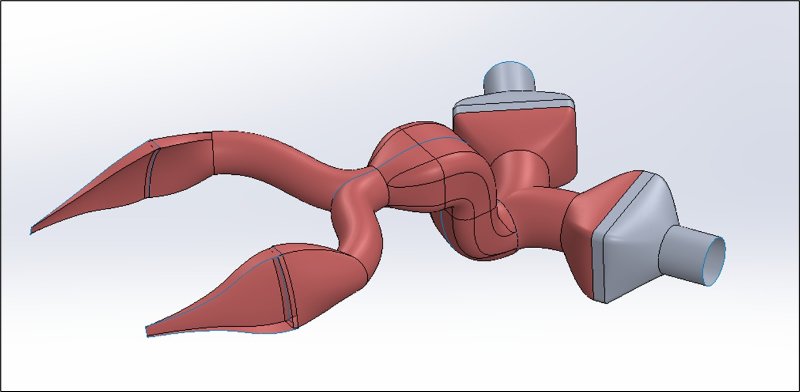

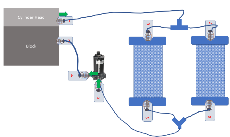

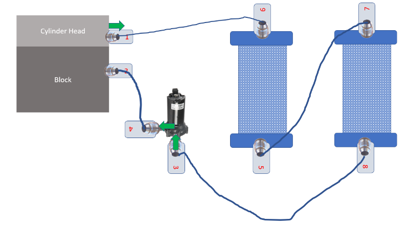

:idea1:
What do you think is the best options
:-k :-k :-k :-k :-k :-k
flow 1.PNG (124.53 KiB) Viewed 4639 times
Flow 2.PNG (152.36 KiB) Viewed 4639 times

As someone with absolutely no knowlege in these matters I'd always go for the simplest set up so flow diagram 1 would avoid the additional points of failure at the junctions.
Also, as the coolant should be entering the radiator at the same temperature irrespective, I suspect it'd be cooler after going through two rads in series rather than halving the flow and just sending it through the one in a parallel system.
Bearing in mind the thought processes undertaken on the other stages of this build :salute: , I'd be quite surprised if you haven't already devised a test rig and woked out the optimum anyway!
Posts: 1444
agreed, i'd run them in series too.
Interesting
I would’ve said better to split the flow so you don’t get one radiator hotter than the other.
It’s seems production bikes with 2x radiator do ether
Confused :-k
Posts: 6743
I would do one rad for the heads , the other rad for the block, but would most likely necessitate an additional pump
If sharing the same system, I would also feed head before the block.
Posts: 1444
have you thought about how the radiator outlet airflow will affect the aerodynamics overall? is there an ideal place to have air coming out to aid in airflow over the bike? didn't know if you'd factored that into your decision at all?
Faux-7-0
Posts: 927
Location: Reading
Post by Faux-7-0 »
autofetish wrote: Sun Dec 12, 21 5:37 pm Interesting
Confused :-k
I refer you to my opening statement: " I know nothing....." :)
Great info guys I’m gonna come back to this.

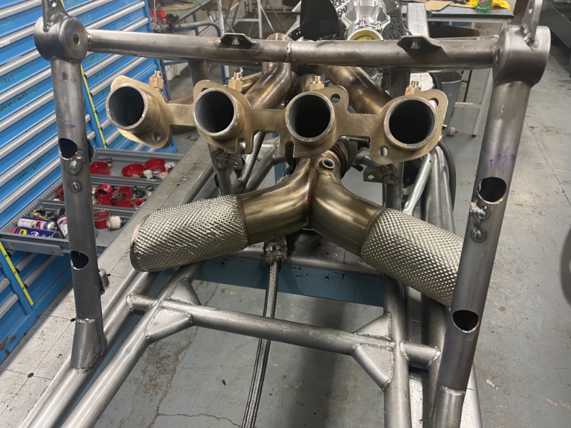

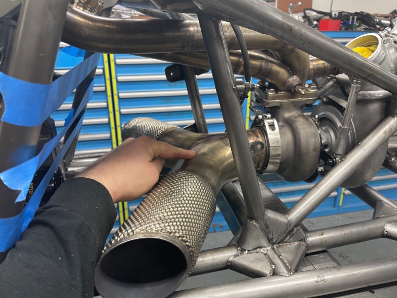

Next stop, I needed to make a fuel tank
I wanted this mass which is a depleting mass, to be located near the centre of gravity.
Unfortunately , the centre of gravity is located just underneath the exhaust manifold and above the tailpipe.
Exhaust manifold around 700°c and tailpipe around 500°c
So let's put all the high octane race fuel next to the hottest part of the bike
:reindeer: :geek:
