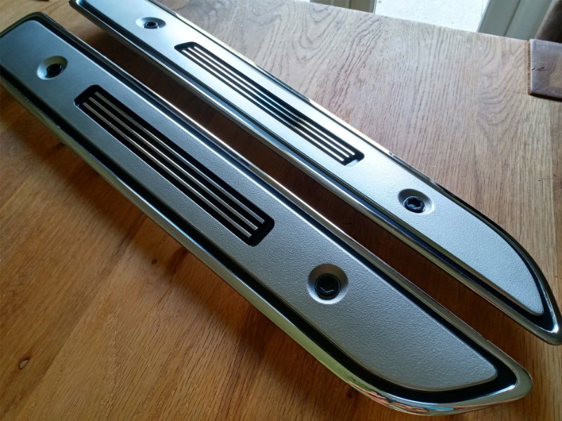

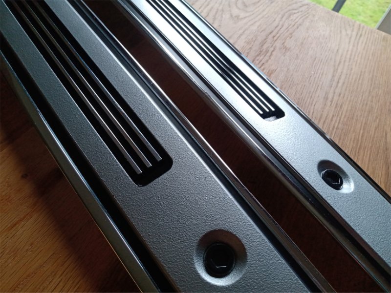

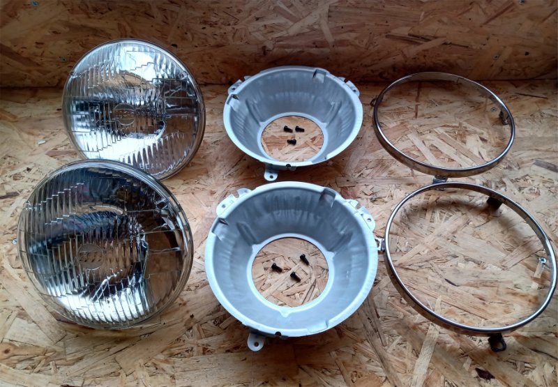

A few bits I worked on a while ago. headlamps/bowls/trim rings given a going-over, and replacement bonnet decorative castings sourced from a guy in London. Mine were very pitted so I managed to find these which were part of a small job lot of other bits & bobs. The paint was shot but the chrome good, so lots of cleaning, masking, painting & swearing later they came up nice. I think I ended up painting them 3 times as the detailing kept bleeding!
Happy with the results though.

Those have come up fantastic. What did you use to paint them with?
2001 Dodge Ram Van
2001 Dodge Ram Van
Re: RHD '68 BARRACUDA RESTORATION
Ooo, sounds interesting!
Re the hood castings- etch primer, truck bed textured spray, colour & satin lacquer.
The fiddly masking is always the awkward bit on bits like these!
Good call on the truck bed spray, I'll try and remember that one for a textured finish.
