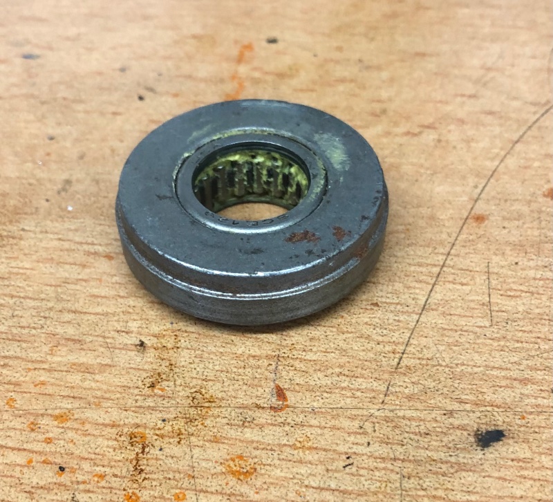

Yes your engine has a crank not drilled for a manual trans. There is an input bearing that fits into the convertor snout drilling on the crank and you trim back the input shaft on the trans to suit. I had a new one of those bearings in my roll cab a while back, I'll see if I still have it.

Yep!

however a simpler alternative is buy that roller set up off Blue, tap it into the converter snout area in the hub of the crank
cut 5/8s off the end of the rather long spigot on the end of the a833 input and be done with it. modern roller set up like a dodge magnum318 truck.

I used one of those roller bearings on my 408 with a 833. I didn’t need to trim back the input but it would have worked fine if I’d needed to. No other shimming required and I think it’s a better set up than the old spigot bush knocked deep into the crank.
