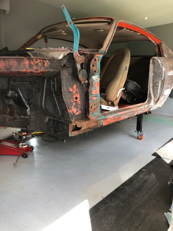

So it begins
Quick update
Has been sleeping in mum and dads garage awaiting attention since 2005 when I snagged it off Matt Hollingsworth
Built another garage in the back garden to carry out the work will post updates as they happen
Quick update

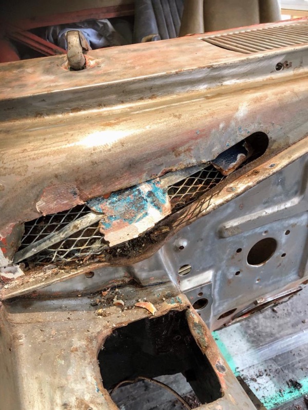

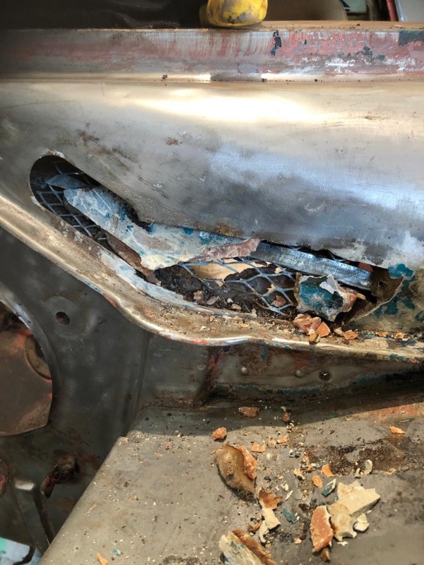

Well as I expected plenty of rust in the usual Aus charger places
As you will see they have covered the only access to the drains and the plenum areas filled up with water
Render corner beads are for rendering not something to mould grp and filler round
Also knocked a bloody great hole through the inner wing

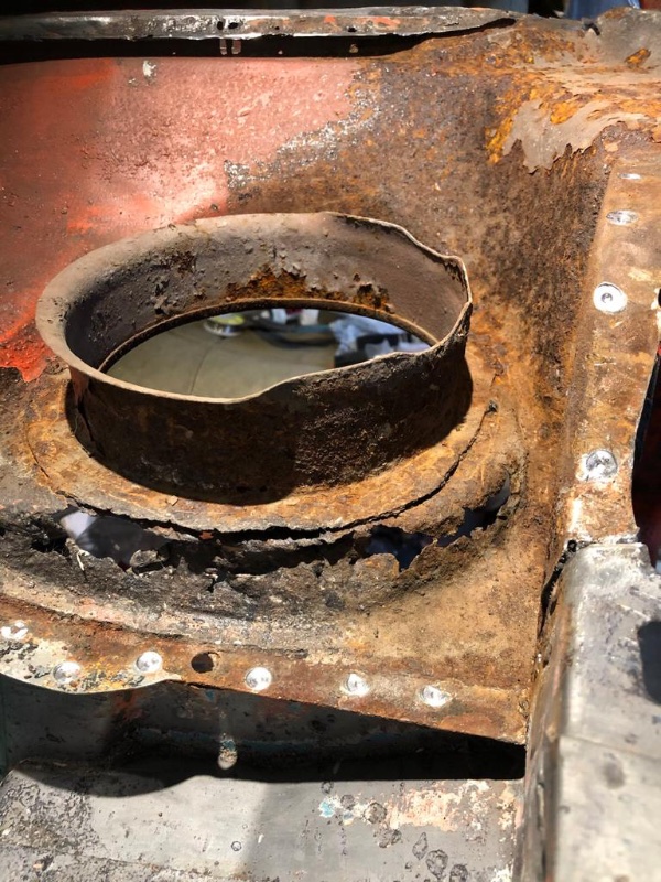

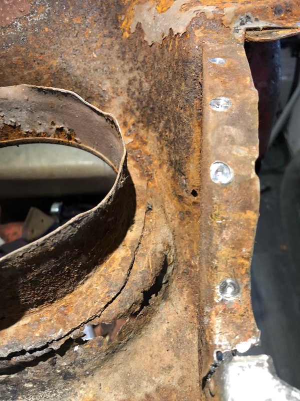

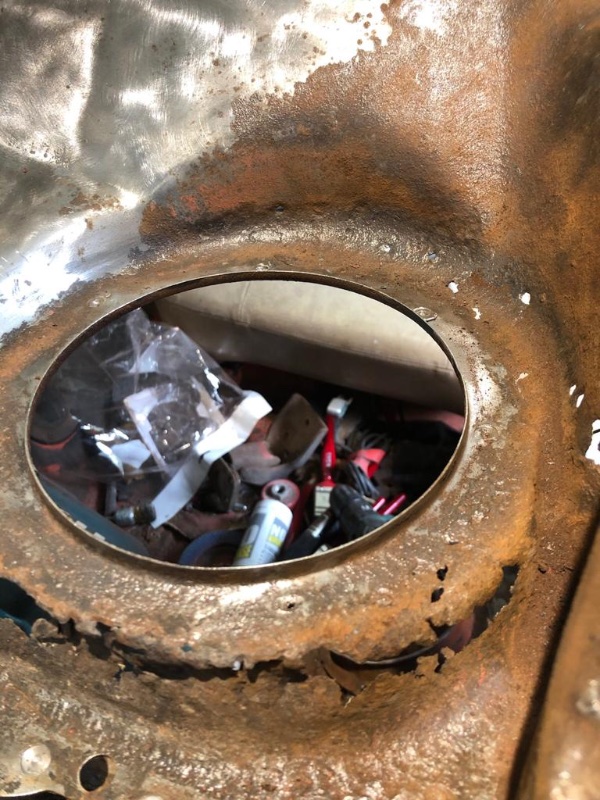

Removed from panel to access plenum area as I can see plenty of rust inside

Must have been filled up to the wiper’s with water at some point

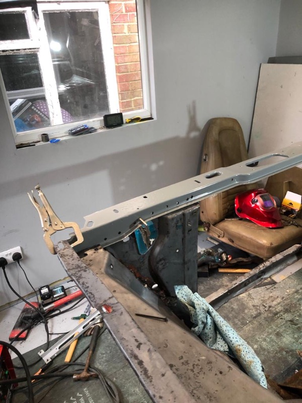

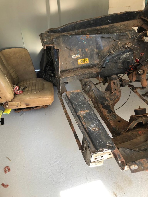

Front structural cross member was cut through as well as the lower radiator panel
Got a good straight second hand one that needed a few welding repairs

Re: Valiant charger restoration
seems to have suffered in all the usual places and some....
good to see new metal going in

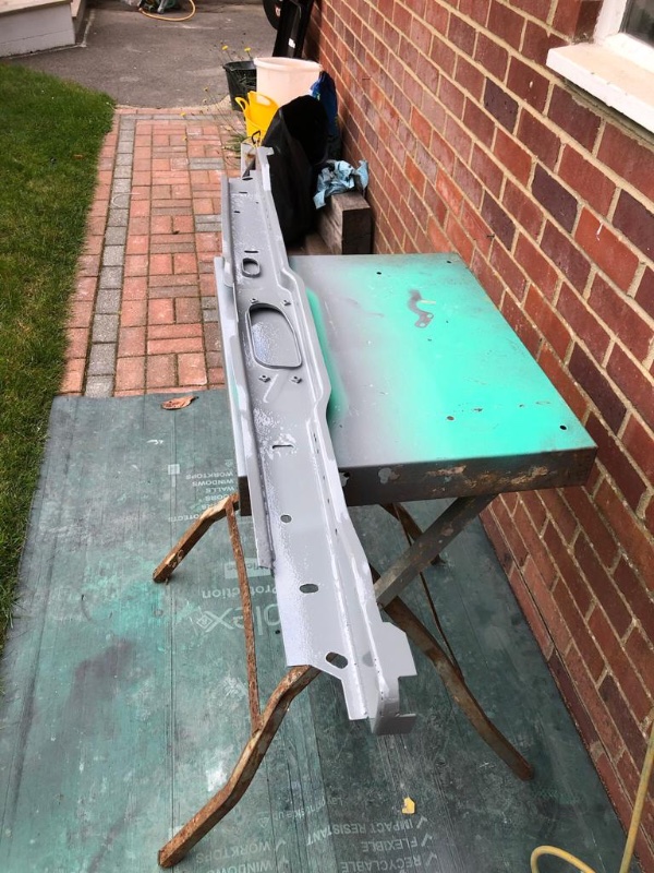

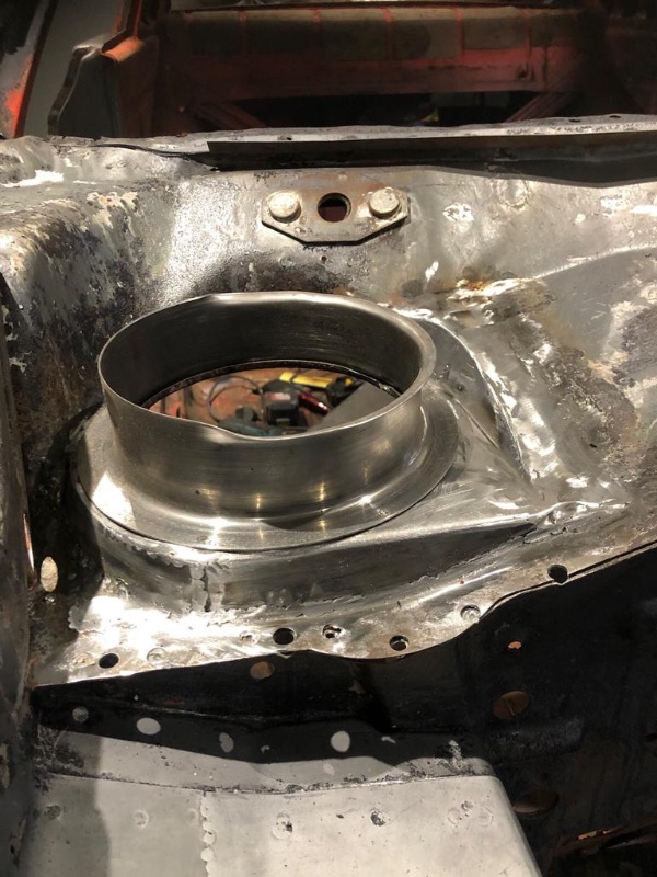

Yes Dave the usual spots
Plenum area is a lot worse than minty
Front area is 90% complete
Lot’s of metal patches and plenum area has been repaired
Has had two coats of Mipa epoxy while I attack the rest of it
I thought Jack had his hands full with other projects
Door cards are shot ,the back seats are in good condition
Front seats need recovering
