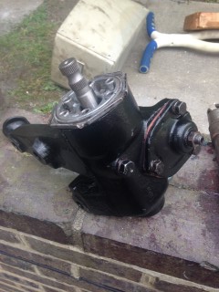

Manual steering box rebuild
This is for RHD cars but the same stuff is used in LHD, you just don't need to do the ball-nut swap for a LHD case if you buy a LHD ball-nut and screw
you also won't need a different column shaft if you avoid Australian 16:1 box
The steering box consists of

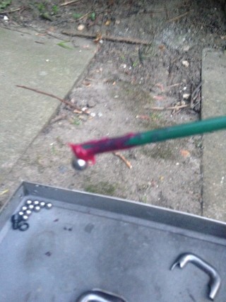

1) get a 16:1 ballnut and screw from FirmFeel inc.
2) take off the ball guides
3) take out balls
4) swap ballnut end for end i.e put it on the other way round

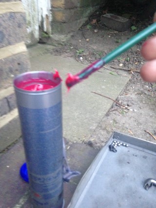

5) grease ya balls
6) push 50% into one circuit and 50% in the other
push 21 balls into each circuit well greased
glue the other 6 into each ballguide with grease
press in ballguides making sure not to loose one of your balls the wrong way down the threads out of the circuit.
7) put on ball-guide clip

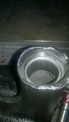

26) centre the box using the master spline on the sector and the case casting seam
27) grind new master spline into wormscrew shaft.

- IMG_1742 (Mobile).JPG (38.96 KiB) Viewed 89073 times
- new 16:1 LHD ballnut and screw to the left and old Aussie RHD ballnut and screw to the right. Notice the different orientation of the ballnut teeth. 1 way for left hand drive the other way for RHD.
- IMG_1741 (Mobile).JPG (38.32 KiB) Viewed 89073 times

- greasing your balls
- IMG_1755 (Mobile).JPG (50.51 KiB) Viewed 89067 times

- tapping in the top beraing
- WP_20160503_003 (Mobile).jpg (73.74 KiB) Viewed 89057 times
- IMG_1771 (Mobile).JPG (51.36 KiB) Viewed 89055 times
- top bearing in place
- WP_20160503_004 (Mobile).jpg (69.34 KiB) Viewed 89055 times
- bottom bearing in
- WP_20160503_002 (Mobile).jpg (69.66 KiB) Viewed 89055 times
