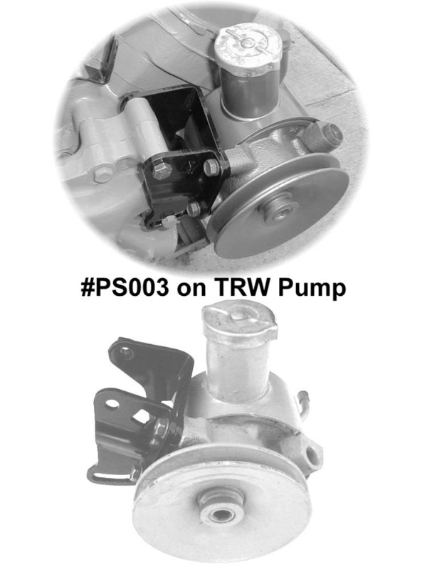

Re: Power Steering Pump Compatability
This is what I have on my 68 383...
- mancini-racing-big-block-hemi-trw-power-steering-pump-brackets-17.jpeg.jpg (47.22 KiB) Viewed 55915 times

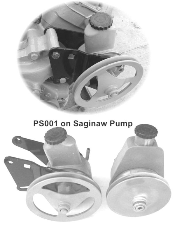

My pulley was buckled but put one of these on....
- mancini-racing-big-block-saginaw-power-steering-pump-brackets-27.jpeg.jpg (48.25 KiB) Viewed 55915 times
