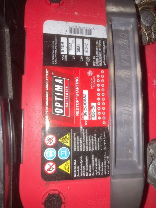

Need a bit of help deciphering some info please.
I have a red top Optima battery that got run down due to my voltage regulator letting me down. I have read in plenty of places that you shouldn’t charge them with a regular charger, so emailed Optima in the States to see if they could supply a charger. This is the response I got :
“Thank you for your interest in Optima products. The Digital 1200/400 is for use with 110 Volt 60 Hz AC power consistent with U.S. and Canadian standards. We do not offer a 220V or 240V charger. The chargers are not available outside of the US & Canada.
Since there are many great battery chargers on the market, we do not have the capability of testing each one. We do not “Officially” endorse specific chargers, yet we will supply information about our charging recommendations.
The best method for consumers to maximize AGM battery performance or to recover a deeply discharged AGM battery is to use a modern AGM specific microprocessor-controlled charger with a conditioning/desulfation mode.
Below is a link to charging rate recommendations.
https://www.optimabatteries.com/support ... t/charging
The relevant info from the link comes up as :
“REDTOP Type: 34 & 34R - 34/78 - 78 - 25 & 35 - 75/25
These batteries are designed for engine starting applications. They are NOT recommended or warranted for use in deep-cycle applications.
Recommended charging information:
Alternator:
13.3 to 15.0 volts, no amperage limit.
Battery Charger:
13.8 to 15.0 volts, 10 amps maximum, for approximately six to twelve hours.
Rapid Recharge:
Maximum voltage 15.6 volts (regulated), no current limit as long as battery temperature remains below 125°F (51.7°C). Charge until current drops below one amp.
Float Charge:
13.2 to 13.8 volts, one amp maximum current, time indefinite (at lower voltage).
Strictly adhere to all limits.”
All I really want to know is, from the plethora of chargers out there, can anyone point an electrical dunce in the right direction of one that fits the bill from the info in the link?
Tia! :clown: :help: :thumbright:
