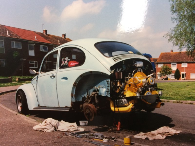

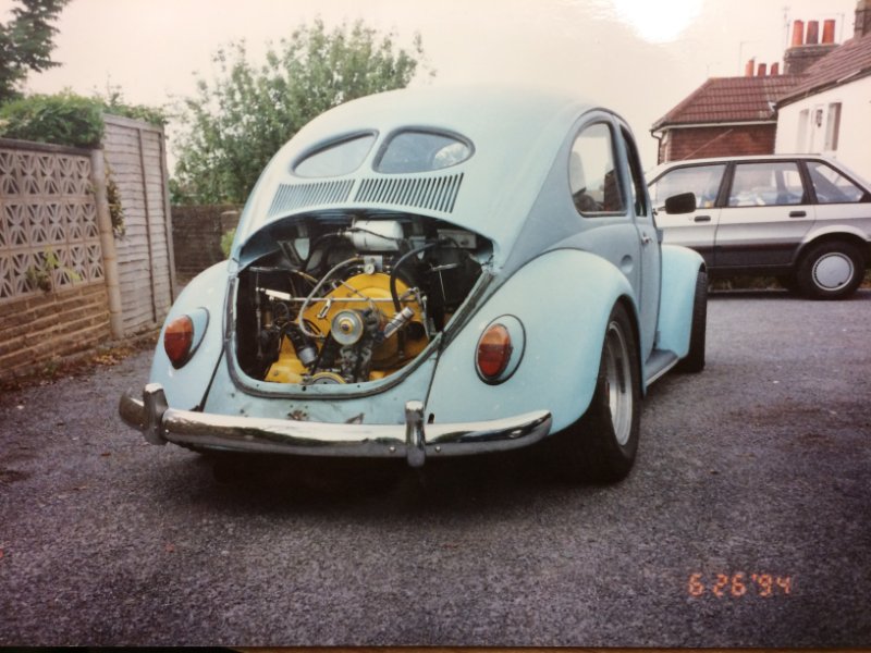

Posts: 3679
Re: VW Air-cooled mis-fire/ poor running
I used to have mine in and out so often, I cut the back of the car off...
You could undo the wing bolts and the jointing plate I made up by the cut line, and lift the rear valance, bumper and both rear wings away as one bit.
You could only see a small line between the wing and the decklid when it was all bolted back.
Matt74
Posts: 1188
Post by Matt74 »
Yeah that's a useful mod to do Dom. Makes life a bit easier!
