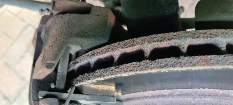

Hi all
Looking for some of your collecive wisdom please (you've been invaluable in the past!).
The disc brakes on the front of my 1970 Cuda are both sticking on, and have quickly (over 2 or 3 drives) got worse to a point where I only just got home in the heat yesterday after a short drive yesterday, with some smoke starting to come off the offside brake as I got home (again offside slightly worse of the two).
On the jack, I can turn both wheels by hand but only with quite a bit of effort. The pads are clearly right on the disc.

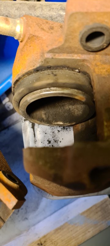

Right, I've taken the brake pads out (used a big screwdriver to lever the stuck capiper and pads up and off the disc) and all looks reasonable inside, just a fair bit of black brake pad dust. Pads look ok also - outer one is around 5mm, inner one around 7mm of remaining pad.
Before I start to cracking open the brake lines, I was wondering how far the piston should actually go back in? - it looks fairly well retracted as it is (see photo).
Thoughts?

Posts: 22213
Re: Sticking disc brakes on both sides (Cuda).
They should go in further than that - virtually flush with the body.
I have had a similar problem on another vehicle recently, and that proved to be sticking Pistons.. take out, polish up, clean the Caliper bore, lubricate with red grease and reassemble...sorted for now, but I will probably need new Calipers.
Also, the thicker the Brake pad material the lower the propensity for sticking.
I found this on the race car to the point that I have shims between the Piston and Pads to keep travel to a minimum.
