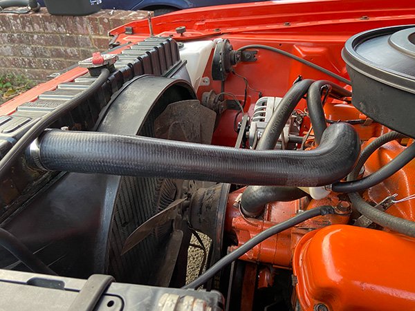

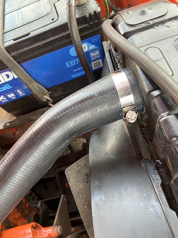

The hose arrived this morning and it's 1 1/2 inches shorter than the one I've removed. Once secured to the engine, there's a 1 1/2 inch distance to the radiator. It's pre shaped and has got a kink in it where it returns to the engine.
I've managed to force the hose on and it seems to be ok. Is it normal they're short? Do they stretch over time?

I had to cut mine down, but it is a Big Block Car; no, they don't stretch...
Ensure there is enough length with the engine moving on its mountings....

Only ever had to cut down, doesn’t sound like the right part to me.

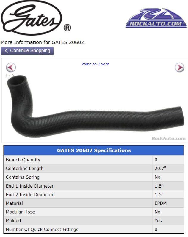

Got it from Rock Auto, it's model specific and it's supposed to fit.
Cost £60 include postage.

I’d check they’ve sent you the right part. Does it measure the same as quoted? That’s the same as I last ordered from them, for a 360 Challenger and I had to cut it down.

Re: Radiator hose
It measures 20". It's got the part code on it.
